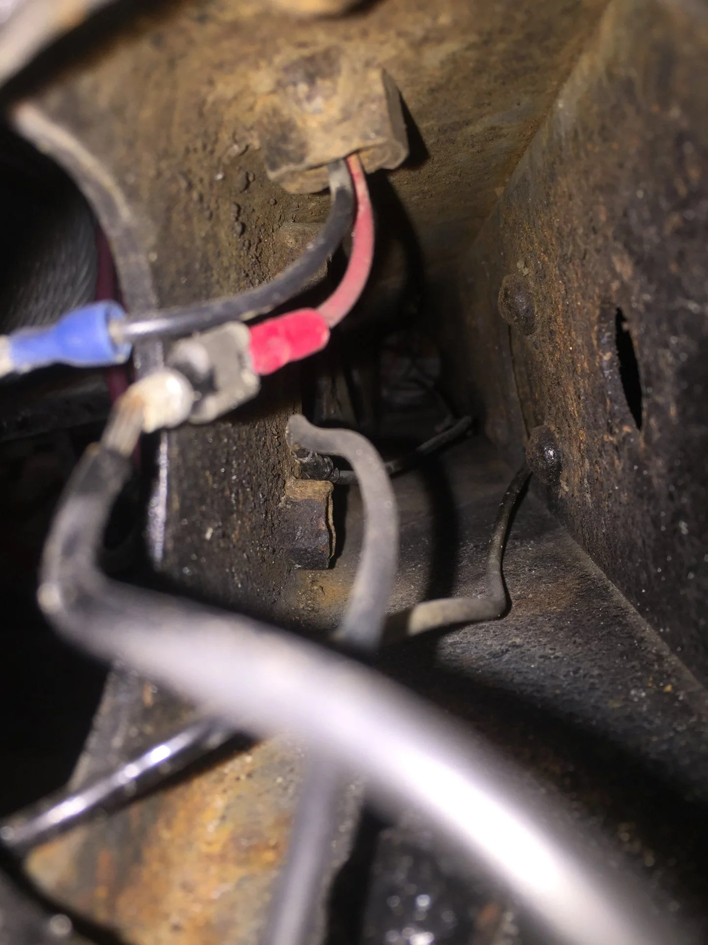

Unwrapped chassis harness off my ‘63 45. Lots of hard work to retain the proper colored wires at the connection points (including original plugs) but still utilize whatever scrap extra wire that’s on hand. Just wrap it all in good sticky tape, no one will know. Interesting splice in the original fuel sender and ground wire section, has to be original because there are two original string ties in that section (the robin’s egg color on the plastic connector on the fuel sender end is from PO overspray). @Coolerman this answers why my FD indicator light wires are LW vice GY, splice in a splice!

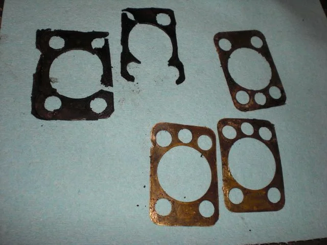

Found this old pic while searching for something completely different.
I‘did a knuckle overhaul for a customer about 8 years ago who had a front end old enough to have brass knuckle shims instead of steel.
But in addition to the brass shims, there were remnants of a few made out of ...PAPER!

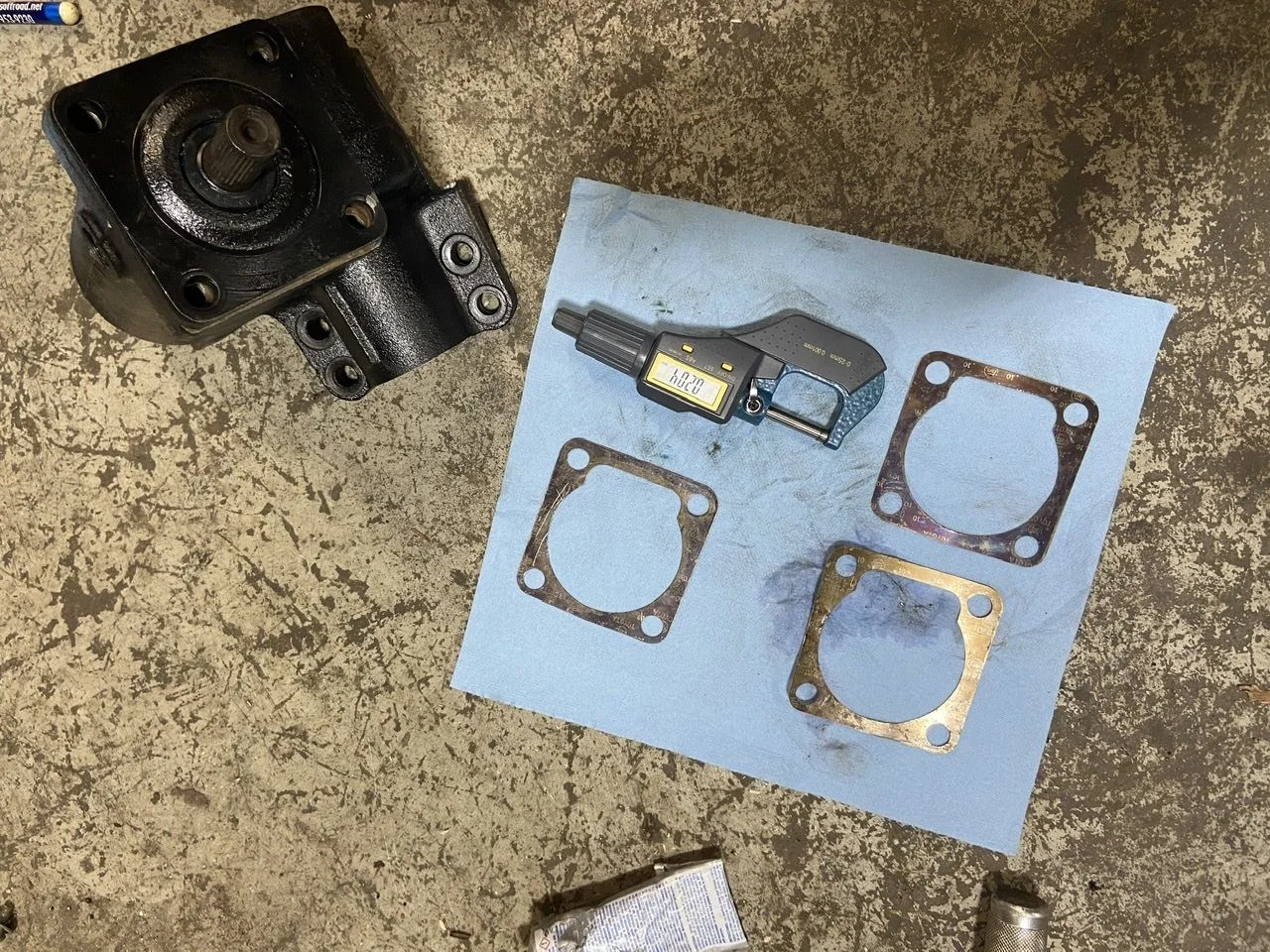

Interesting that I should find this pic today. I just finished rebuilding @thorslc1977 steering box. He had a paper gasket on the upper worm gear cover! Usually I just reuse whatever shims came with the box and it works ok. But this time I had to dig into my big box o shims and set shims from scratch.

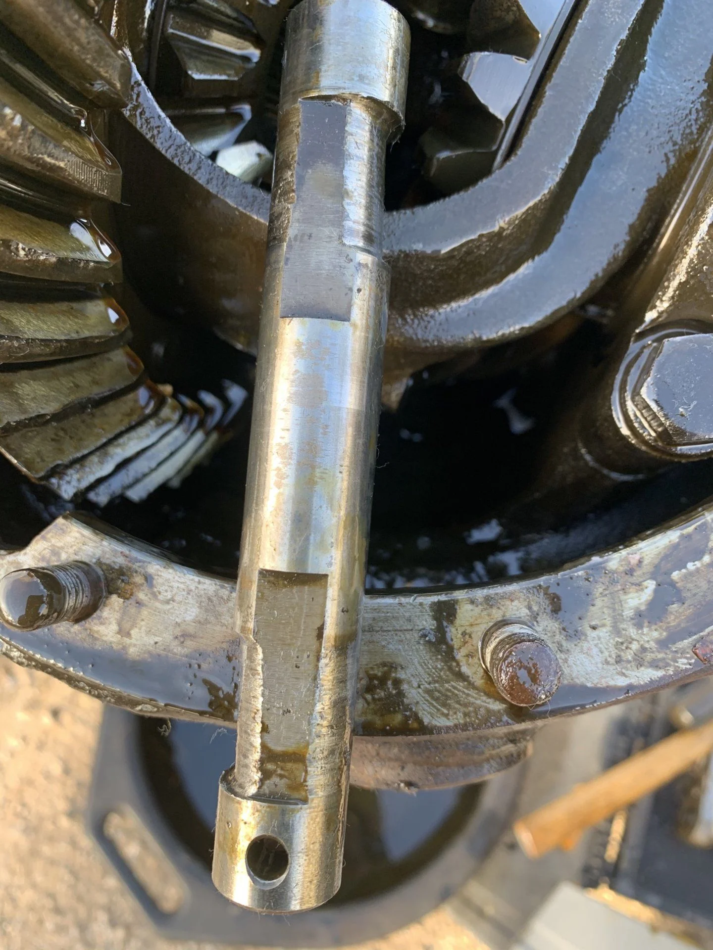

Bought a 1970 FST that I’m taking apart to hopefully rebuild. There was some play in the rear diff between the pinion flange and the rear axles.
I learned why yesterday
There was a centimeter of metal filings on the drain plug and the diff oil sparkled when it dribbled out.
wowser, judging by the chips in the ring gear, there are some other issues going on.

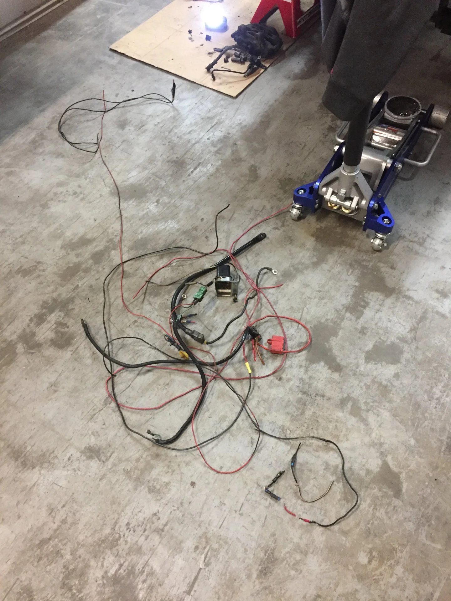

Ripping wiring out of a Eric’s FJ40 :D
I really don’t get what it is about wiring that’s so difficult for people.

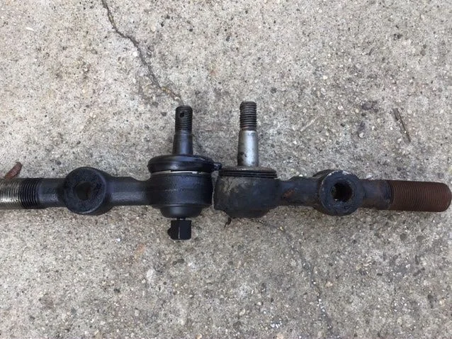

A few weeks back I did a carb rebuild and install on a survivor ‘68 FJ40 with in all likelihood under 100k original. Real clean looking truck. Gave it a cursory glance over and told the customer that IMO his tie rod ends were original. As in 52 years old. He did not want to believe me. I came back to it two or three more times over the course of the stay, and he agreed to let me change them.
As soon as I pulled the first one off, I chuckled.
