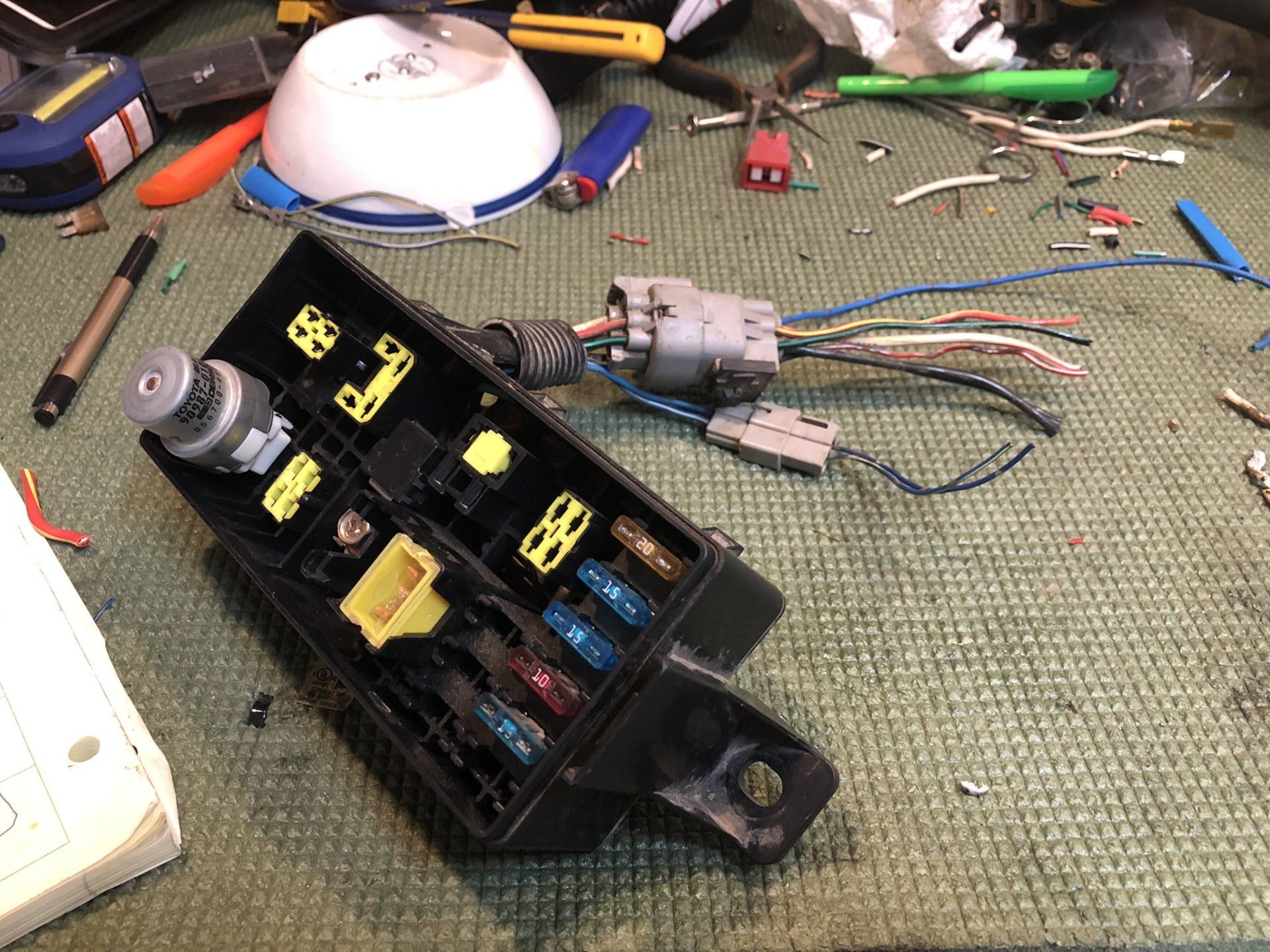

Well today on my way home I remembered that I have a complete extra electrical harness that I removed when I did my engine rebuild. What would be better than a factory fuse/relay block plummed for my accessories? So while I'm waiting for my transfer case seals and bearings the process started... Yes it looks like a total rats nest but my vision is to make it as neat as the factory.
Accessory Fuse and Relay Block is wired, color-coded and tested, ready to go in. Tomorrow I have to figure out how/where to mount it.
Bench testing all the fuse pins and relay functions:

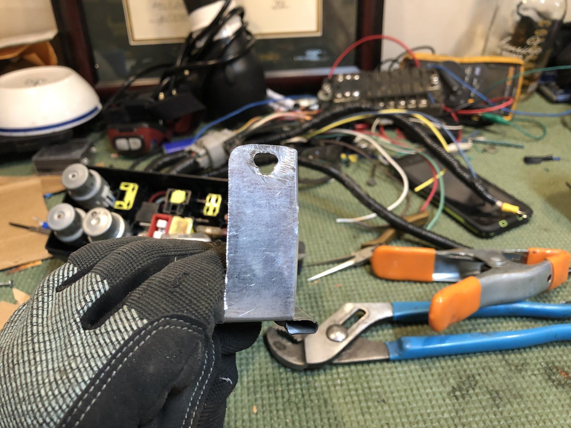

Before I buttoned it up:
Closed up for installation:
Finally Finished my electrical rework.

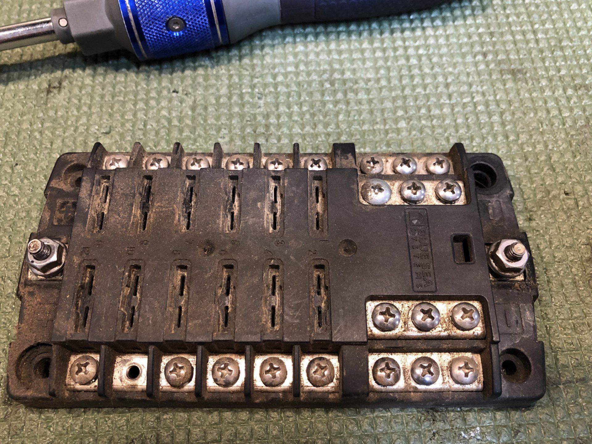

Goodbye blue sea fuse block
Some may look at this and still think it's a clutter mess but it's not when you realize what all is going on here and it's light years beyond the previous setup. Now I just need to find where I put the fuse block cover.....

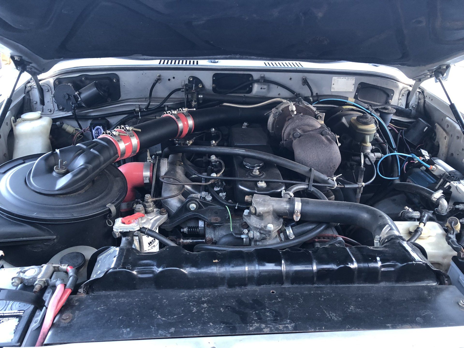

I just made an excel spreadsheet with everything on it, printed it and taped it to the lid. Eventually, I'll have a real weatherproof label made but this is the concept. The colors correspond to the color of the blade fuse for each location. Also relocated my charcoal canister to the other side of the engine bay to make room.
