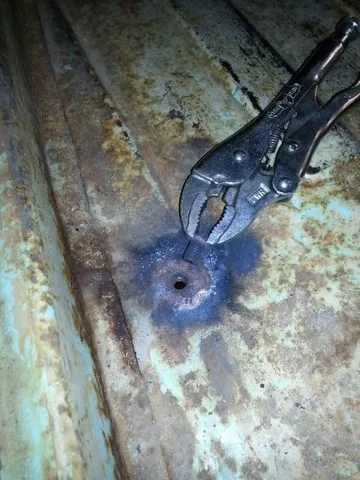

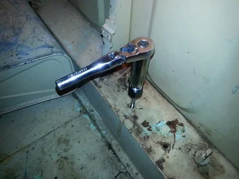

I made some good progress on the passenger seat frame today. I had 3 broken bolts in the tub, I was able to use some penetrating oil and heat to get them out cleanly. Obviously not something you would want to do on a paint finished tub but in this case it beats drilling and tapping. After I removed the offending bolt, I ran a tap through the holes to make sure they were nice and clean.

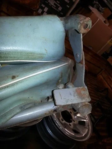

With the broken bolts out I could start on the seat frame. As you can see both rear mounts were broken, leaving the tank simply resting on the gas tank with just a single bolt up front. Good enough for 7-11 runs :D
