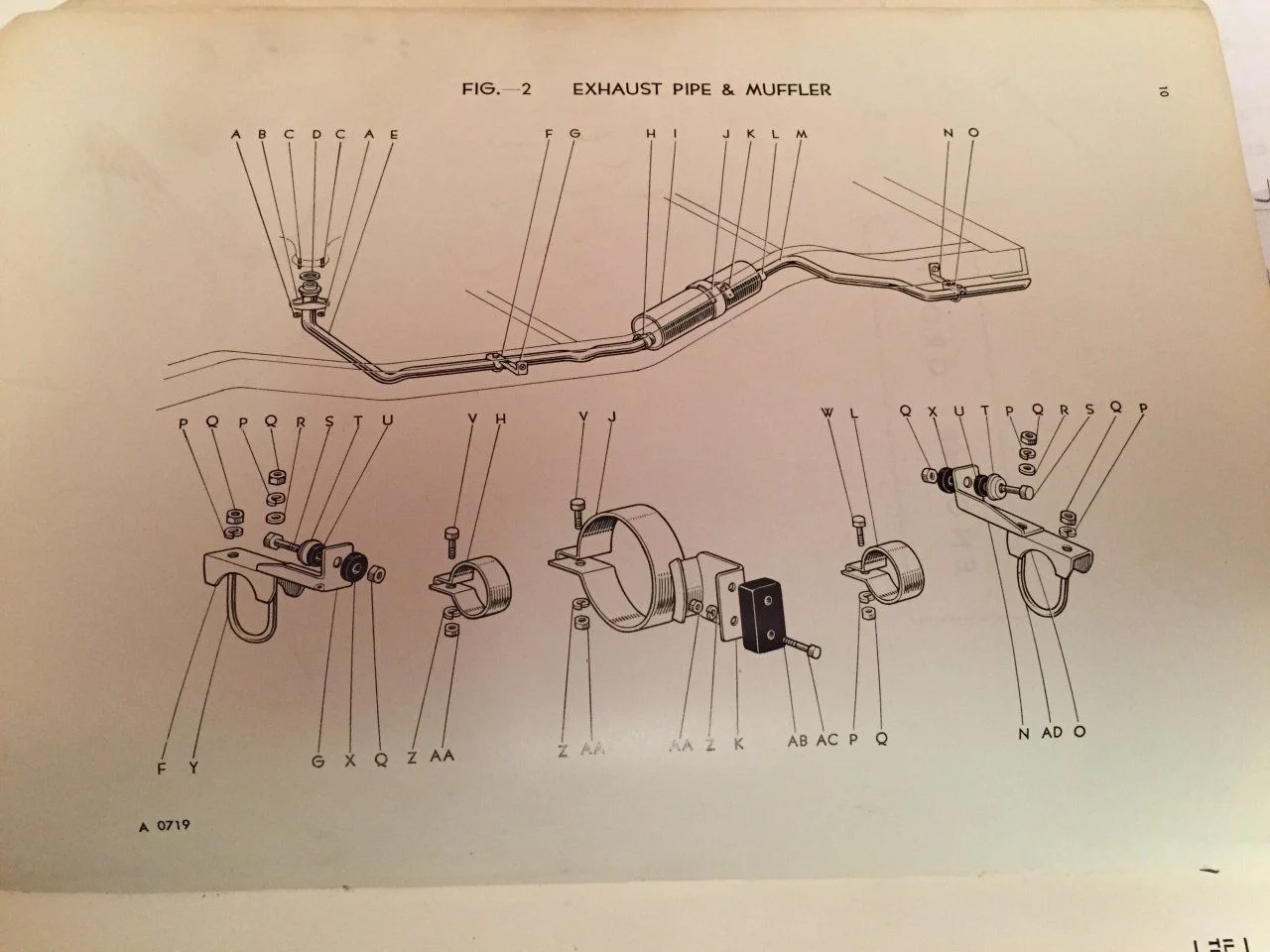

You may have already seen this, but here is the routing from my 1964 LPB parts book.
Probably have the same book as yours JP. Doesn't it seem strange they would end the pipe short of the back of the bed and what looks like in line with the tail lights? my 45 has one of those Confer style rear bumpers. I need to pull it off some time and see if I can see where the stock license plate bracket would mount. If on the left side like I think it is. that would be in the way as well. Really need to take a look at my tail light housing to see which side have the license plate light lens cut out. Housings are removed and everything is out of town.

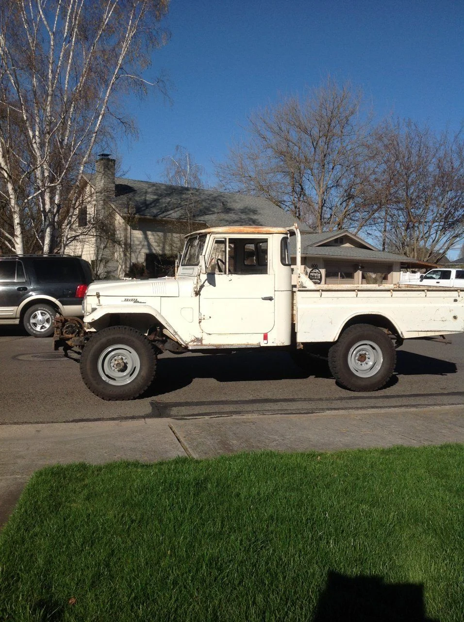

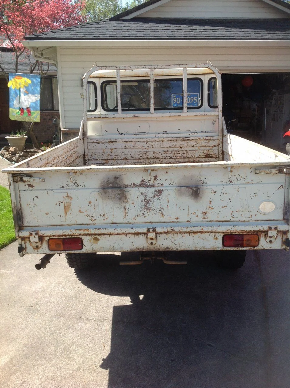

Kurt, here is a picture of my 65 LPB before we disassembled her. It does look like it follows the picture that JP posted. I also had the confer bumper and when we took it off, here is the way she looked. I have an idea that this was factory but not completely sure. I know the muffler was in the same configuration as the photo posted by JP.
