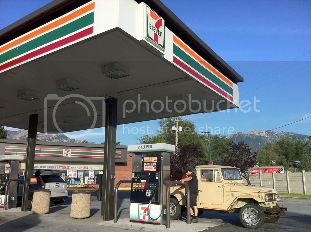

It fires right to life nice and smooth but was having a rough time accelerating under no load. I adjusted the timing as best I could and figured it was time to get some fresh gas in it before we tried to tune it much more. The gas we were running off of was 2 years old, amazing it ran at all quite honestly. We did a full ignition overhaul (cap, rotor, wires, plugs, etc) and got her running enough for a drive to the gas station. After a somewhat eventful time getting there (stalled a few times in the middle of the road), I added 10 gallons of fresh high octane fuel and started home. It literally started running much better in a matter of minutes. I still need to tune with the carb (or install my Mark A built one) but its running decent enough to drive it around.

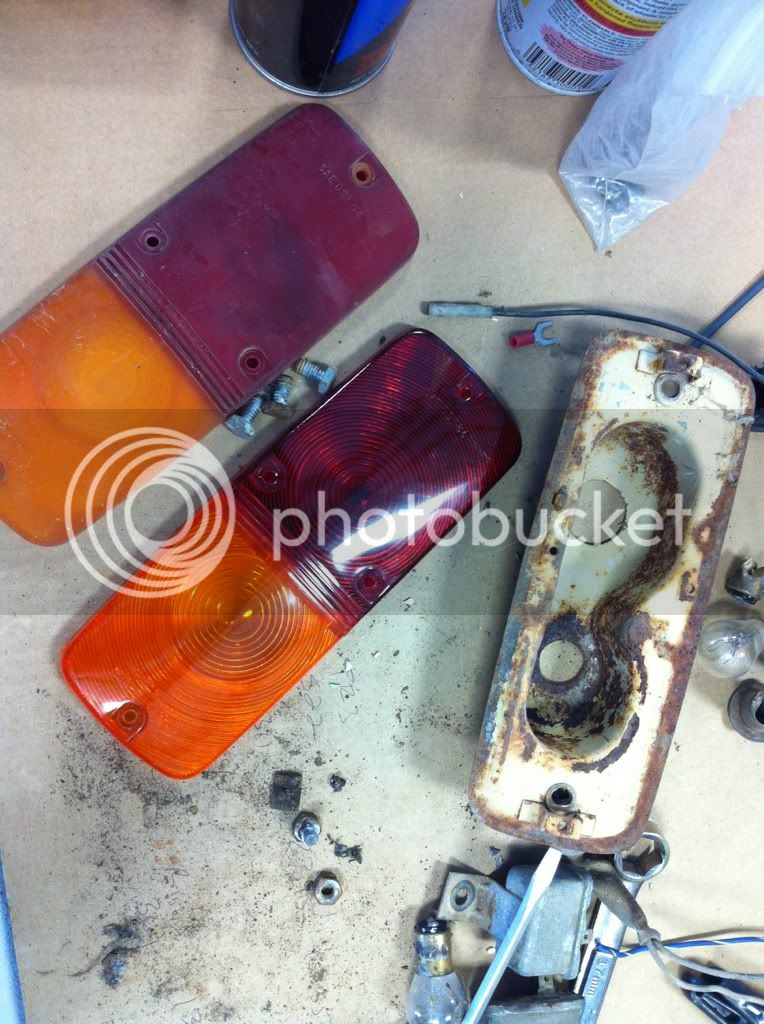

I'm out of town for events the next few weeks off and on so my wife and I spent the morning in the shop organizing and cleaning, labeling all the misc 45 projects and putting all the parts in the bed of cab so they don't wander too far away. If I get a chance before leaving for CruiserFest, I'm going to try and bring the tailight housings back to life. They cut the bulb receptacles out and installed generic bulb housings. It might actually be a decent fix that I run with. Their holes were nasty (torch cut) but I think I can clean them up, patch a few holes and make them operable at least until I find some cleaner units. I've got new lenses and gaskets in stock ready to install. It seems my wiring is OK from the axle forward, I'll just need to build the harness back to the lights.

Btw, 7-11 gas was my last preference... however its just a few blocks from my shop and we really didn't know how far it would make it on the old gas in the tank :D

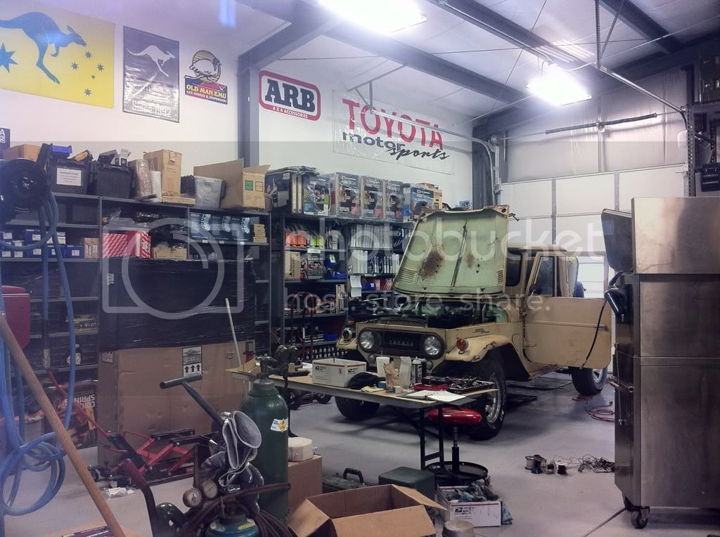

Late nights with the 45....

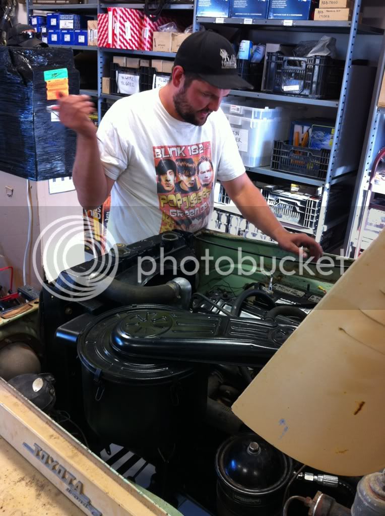

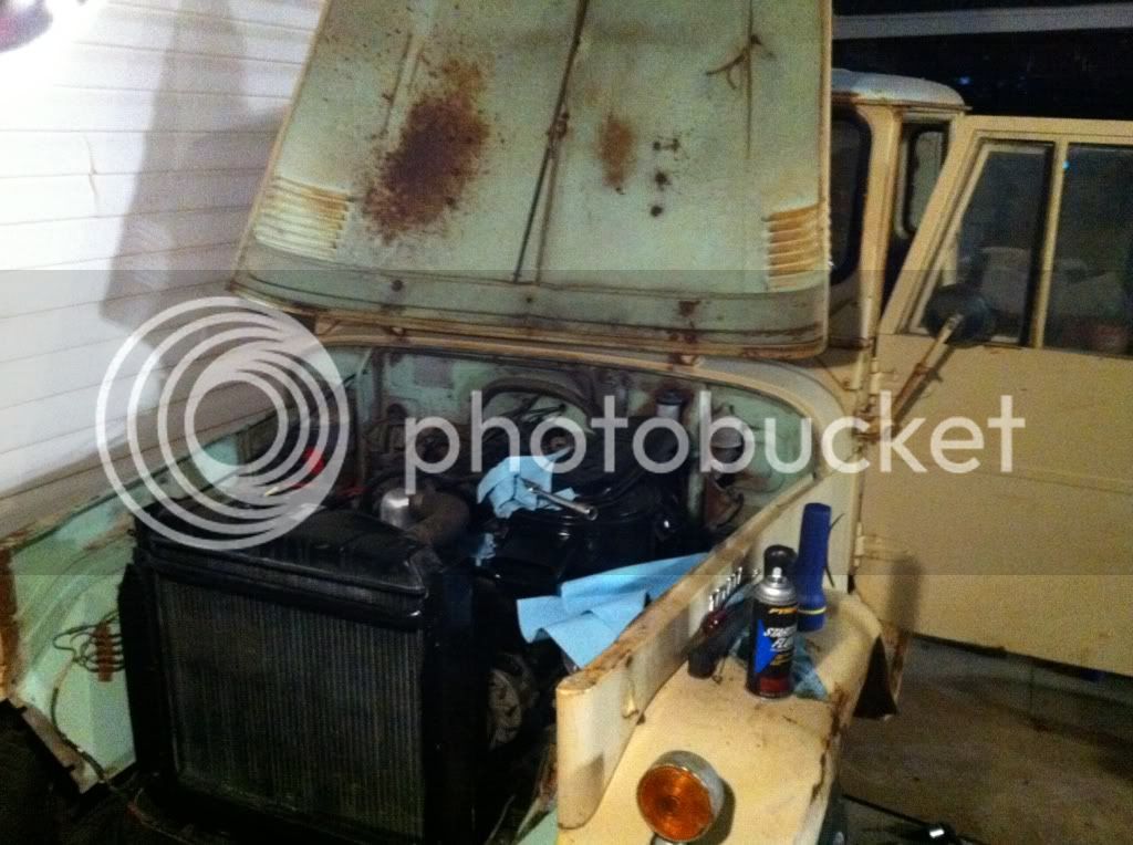

Bringing her to life.. Timing and such til 1am.
Finally in the shop. Wiring reworked with anything non-Toyota being thrown out.

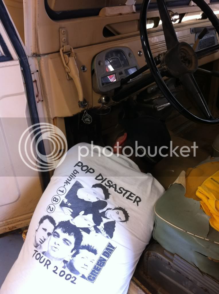

Tracing wires..

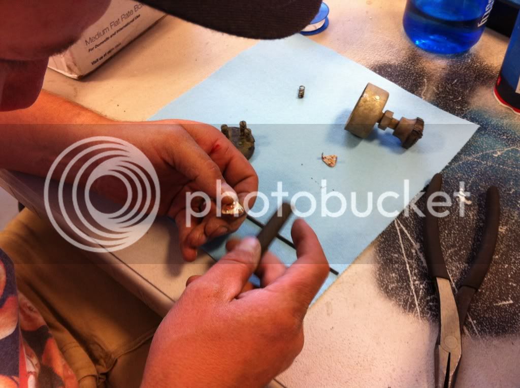

Rebuilding the multi-position light switch.
The Operating Room..
Old tail lens left, new right, and light can far right. Reworking the rear light situation.

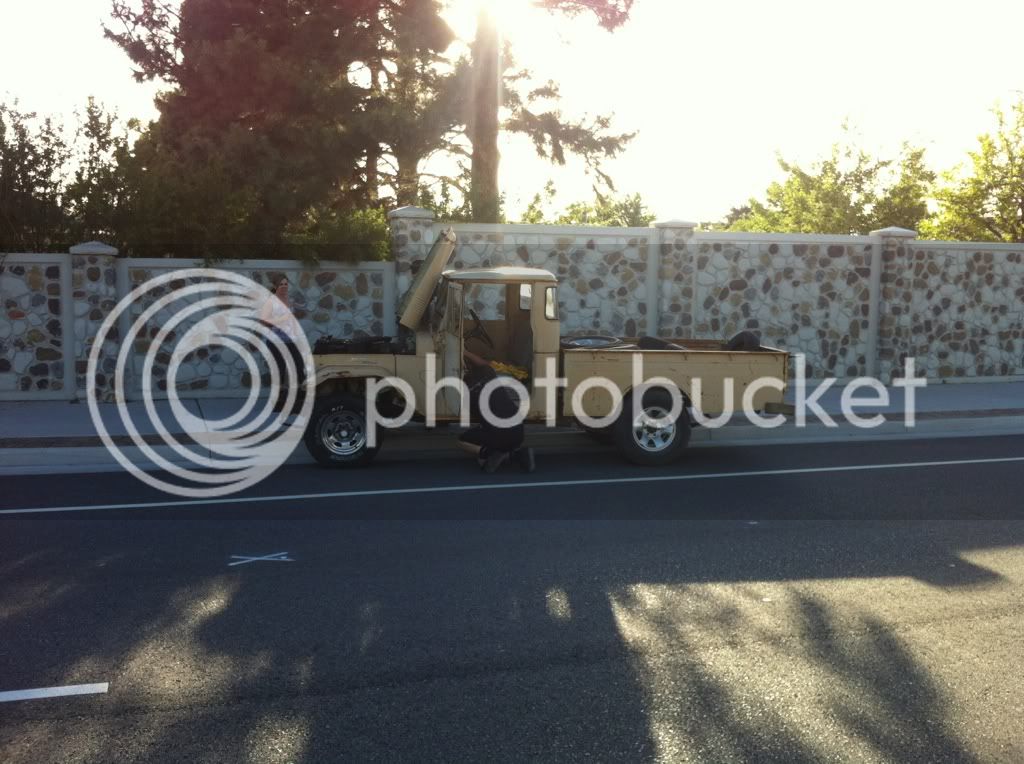

Minor setback on the way to 711 for fresh fuel and sodas.
Mission accomplished.

A bit more progress, tailights are finished and 100% functional. I had to weld some bulb housings into the tailight housings but it turned out as clean as I could have wished for. I've got the harness 100% cleaned up including ditching the aftermarket amp gauge in favor of the repair OEM one. I cleaned up the speedometer assembly, hopefully it resolves the bouncy needle as you cruise down the road. One of these days I'll post some pics :D
