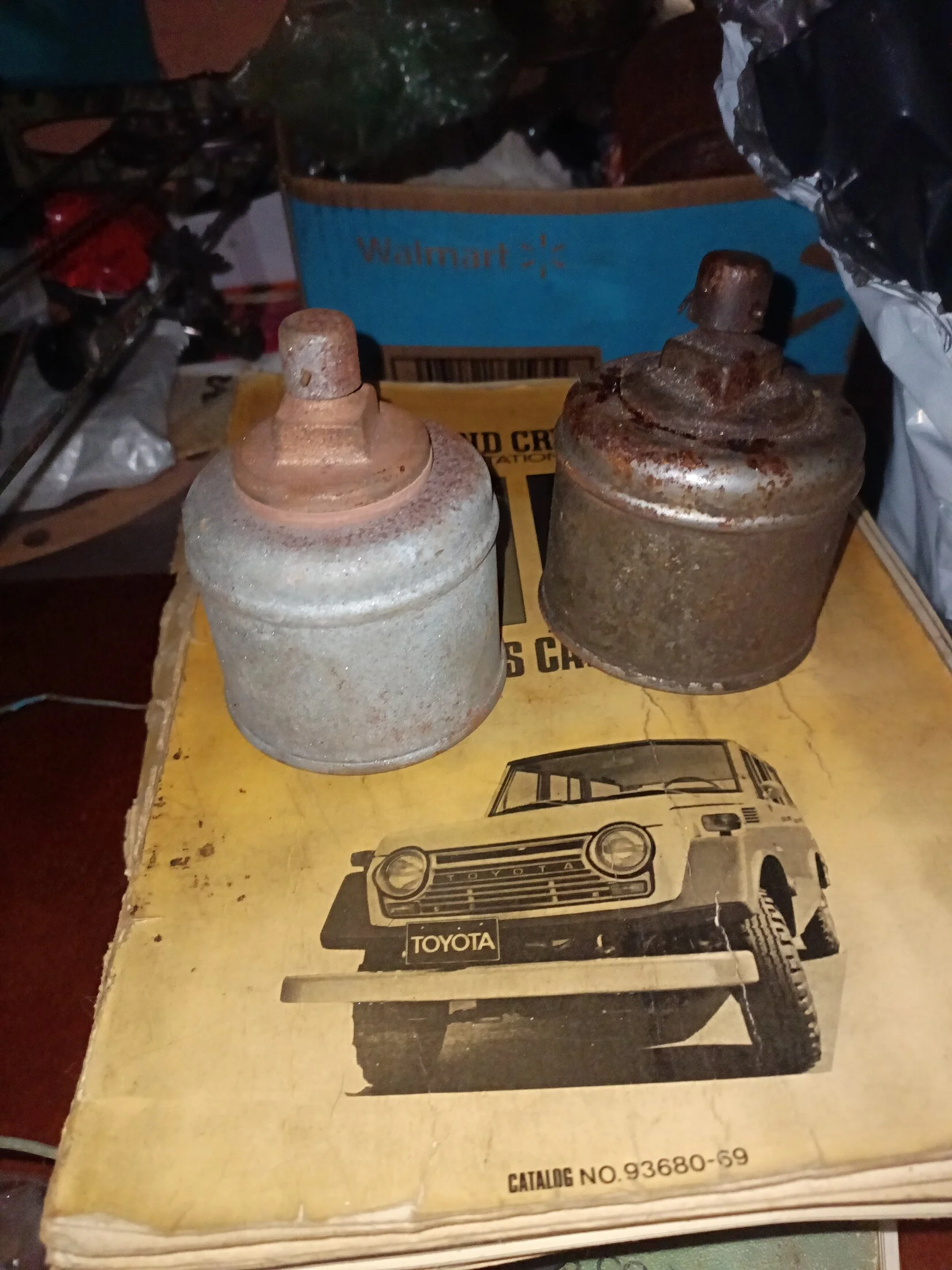

Hold pattern. I wrapped the damaged one around a socket and gently straightened it with the hammer and it's cleaned up pretty nicely. Still interested if someone has a lead on a spare set of intake collars for the 65 FST FJ40 I hope to fire up next!
I'll be pulling apart an old motor I have tommorow. Carefully LOL I will keep you posted
False alarm! The one I cleaned up and straightened is working well. Thanks for being willing!!

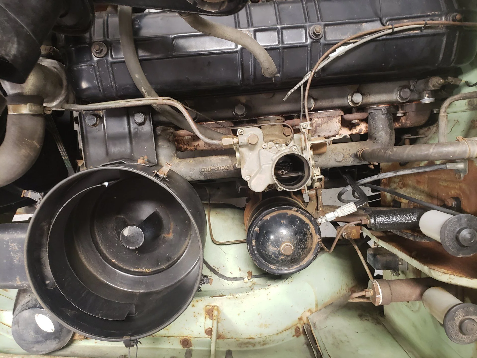

New OEM intake/exhaust manifold gasket installed. It is running soooooooo much smoother now. I just did a quick test fire and didn't let even warm ul. Next up exhaust. I want to try and remove the head pipe at the bottom of the manifold before I drop it off for new exhaust.

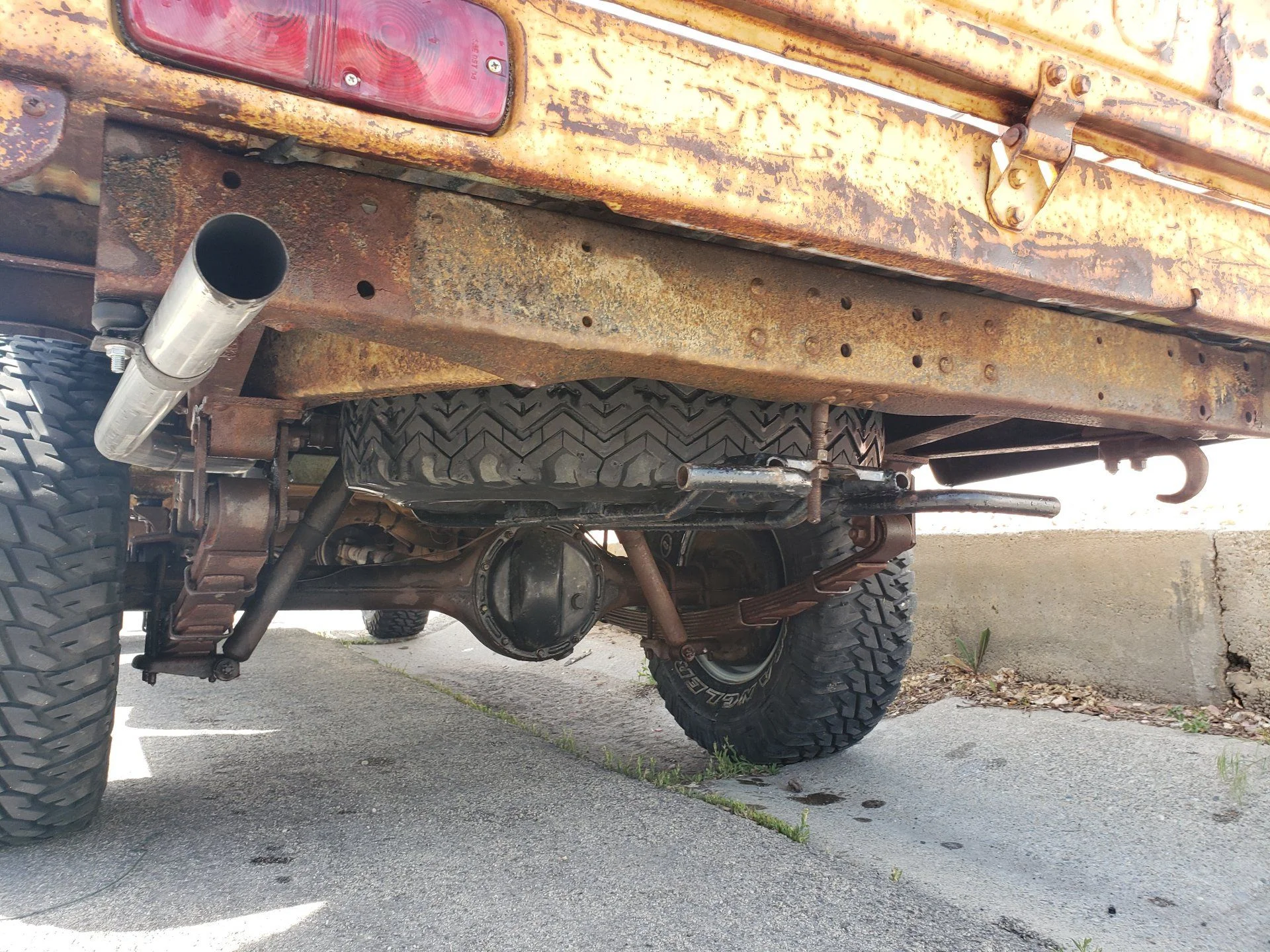

It's running much better with the sealed up intake/exhaust manifold gasket. I was able to drive it down to my exhaust guys this afternoon. Cant wait to see how it runs/sounds after they do some magic. It has had bad exhaust since I purchased it. :D

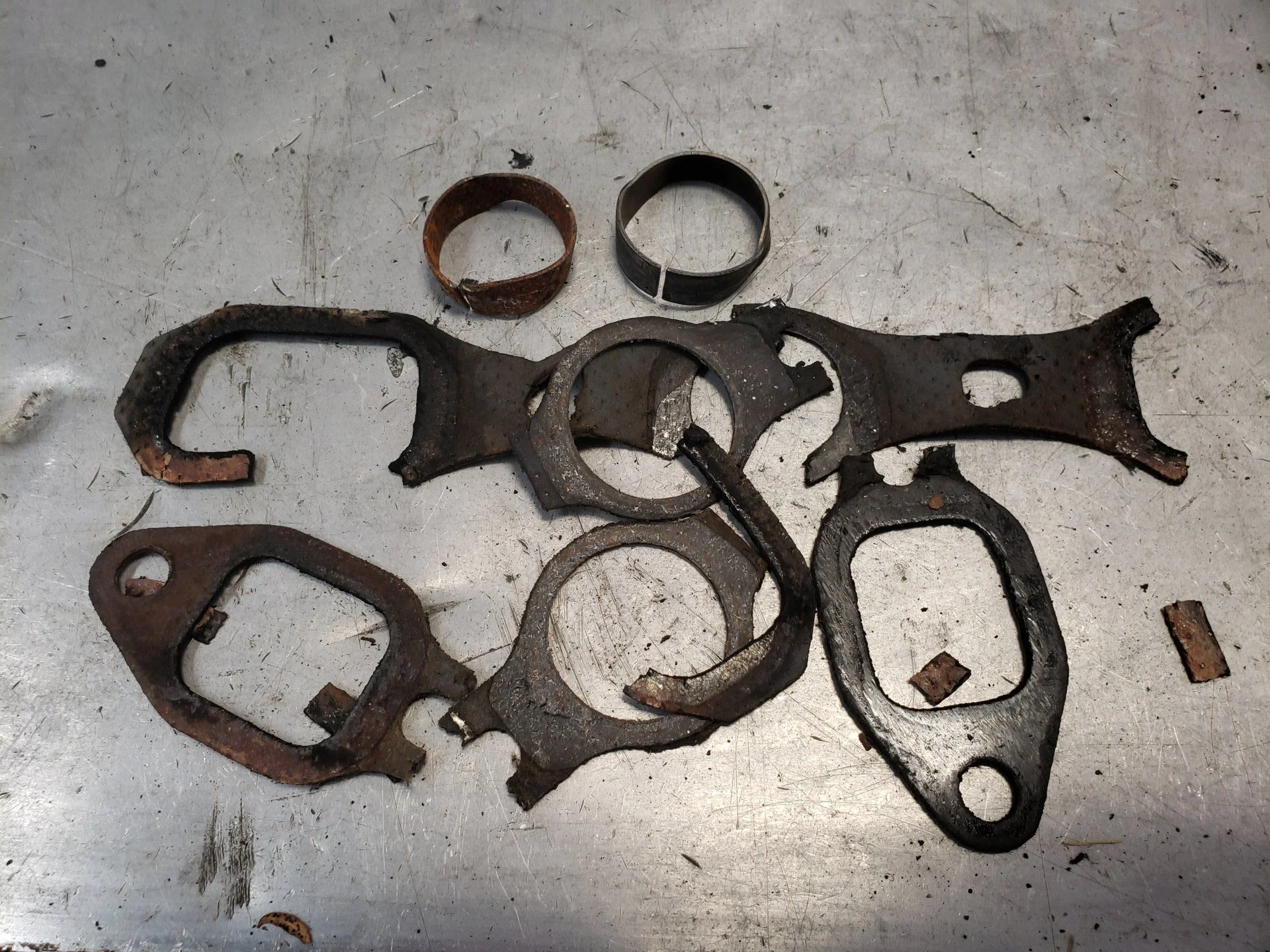

The old intake/exhaust manifold gasket. Documenting before I round file it. I prefer the 3 piece design for smoother install & function.

Adjusted the brakes, mounted new tires as the old KM2's were completely dry rotted. One of the 33's had come apart and it's been rocking a 31" spare. I also mounted the spare tire rack/assembly after all these years. The bed is empty for the first time in 5+ years. It's driving really well. With the new full exhaust it fires up on the first twist of the key, I credit that to Mark's carb work.

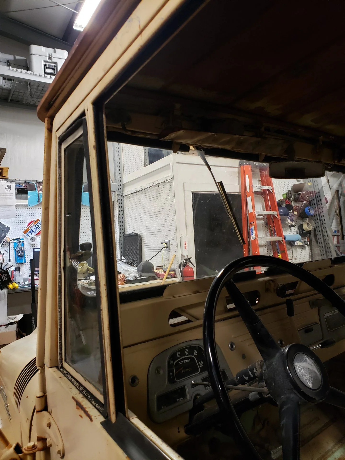

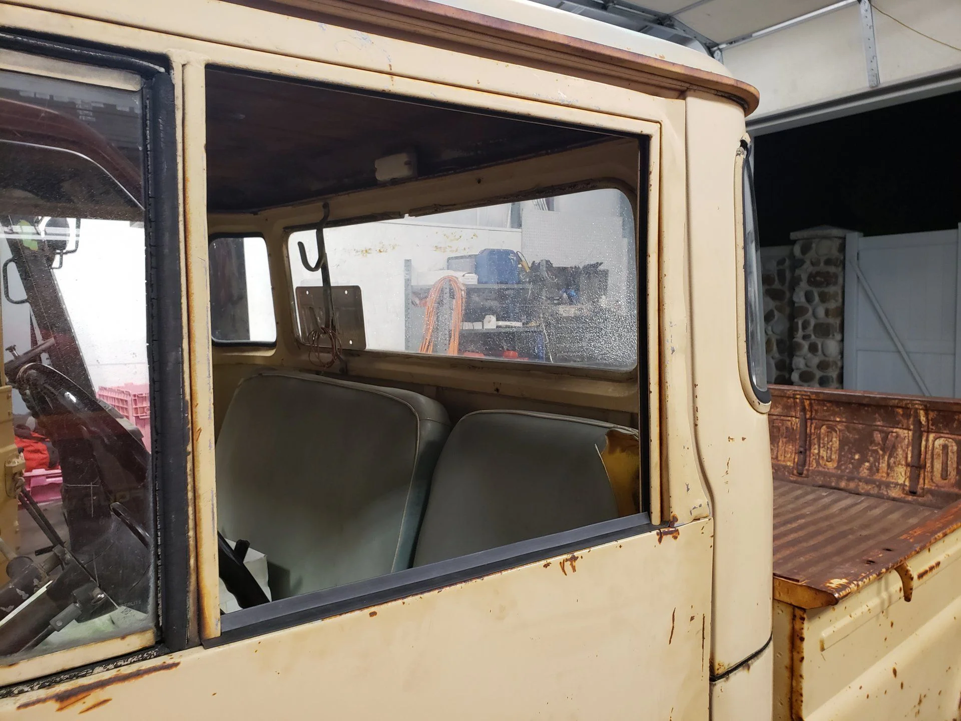

Tonight I did two things I told myself I would not do. Correct the bezel and start putting new weatherstipping on. The bezel was simply a fear the bolts would break/strip and I didn't want to engage that project until I had my torch set on cue and 2-3 hours to heat, drill & tap as needed. I started backing out the bolts and amazingly they all came out unscathed. I flipped the bezel and reinstalled with the 4 OE spacers and OE stainless screws. The weatherstripping was also a bandwidth concern but more so I didnt want to invest in W/S until I was ready to paint & restore. However the rattling doors and gap riddled glass were getting to be too much. I knocked out the drivers side door runs and inner/outer felts/scrubber along with a new window regulator.
I also installed a new floor dimmer switch. The old switch was super janky. It's the wrong application and only held in place with one bolt. We have an aftermarket unit we've been selling at the shop for years and it was high time my own 45 had a proper switch held in with two bolts :D
The Mrs and I took it for a late night burn. She was pleasantly surprised how much quieter (exhaust) and better it is now running. :cool:
