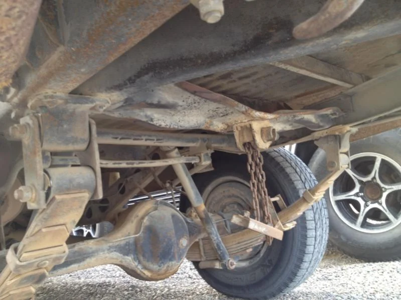

So with winter looming and me in town for a bit, I want to finally tackle some of the little projects this old gal needs. It has a leaking rear diff that needs to be addressed as well as some nasty spring bushings. Hope to squeeze it in the shop this week for those. I'm super torn about weather stripping particularly on the front doors. I have all of the new stuff in stock with the exception of the bug-catcher window (any updates there? remind me who was making that?). Do I burn $300-400 worth of w/s on the crusty/un-prepped doors just to make it less of a headache to drive? I could get by with some door runs on both side and the bug-catcher window, the rest is ok enough the time being. Figure $200 is worth having it sealed back up?

We did make some progress today, pulled the rear diff as it was leaking pretty good. Was hoping it was just the diff cover but it was the housing to diff. Going to do rear sway bar bushes while I'm under there too... same bushings as a 100 Series rear sway :cool:

A tad more progress. Swapped out the diff gaskets on the rear end. Replaced all the sway bar bushings while we were under there. I think it is rad that my 100 Series uses the same bushings as a 1966 45. Rather than bolt the old meats back on, we mounted up the factory wheels and 33" BFG MT's that I have been storing for it. The tires are a bit worn but they look soooooo much better under the truck. Candace and I took it on date night tonight, she is warming up to driving the beast.

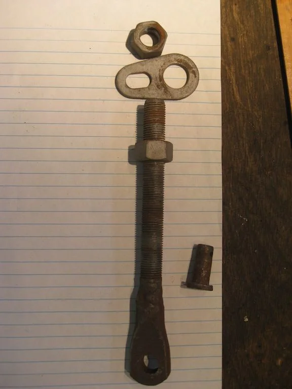

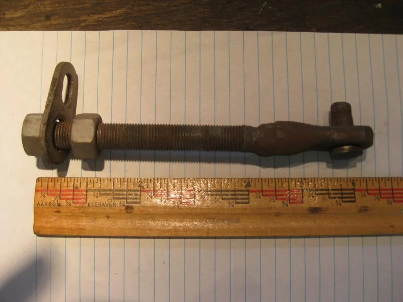

This is one off my 64 LWB. The bolt is 6 1/4" long, 12mm in diameter. hope this helps

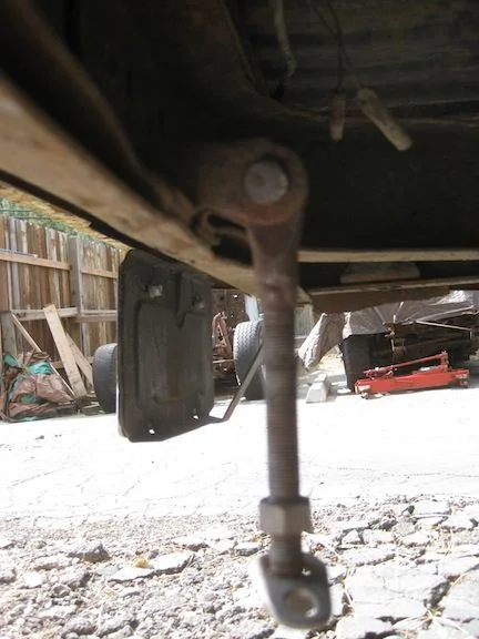

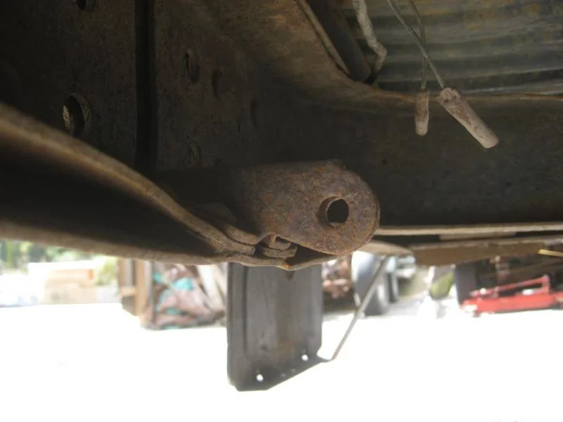

Mine had part of the spare tire fitting left. Just cut off. I plan to use the later FJ45 LP-B style. Picture is of one from the middle east.

Sweet, that is more or less exactly the hardware I have for the tire carrier. Guessing the order goes nut, lock tab, tire carrier and then nut on bottom.
Next question, what color would the tire carrier have been? Body color or more likely black?

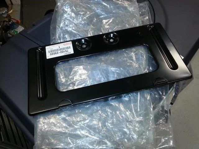

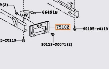

More on that license plate carrier I found in Aus a few years back. It's been sitting on the "45 build parts" shelf here for oh 18 months now. Finally snapped a pic.
They are used on HiLux trucks and have a bracket to attach them to the frame on the truck. I might order the bracket to see if it would lend a clean solution until I can find an OE setup. Bracket pic:
