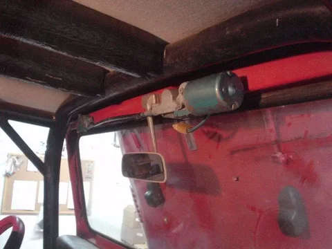

I too was able to get away a bit today and, thanks to Fast Eddy, got a fugly blue wiper motor installed and working.
I did not look at it hard enough, however and discovered the splines on the passenger side wiper stud are pretty gone so I guess I will take it apart and use a doner to replace that stud and gear. In the mean time, I was able to fix another of the three wiper motors I had so I now have two good ones and one doner. So another part scavenged for the Professor Plum project for :princess:
