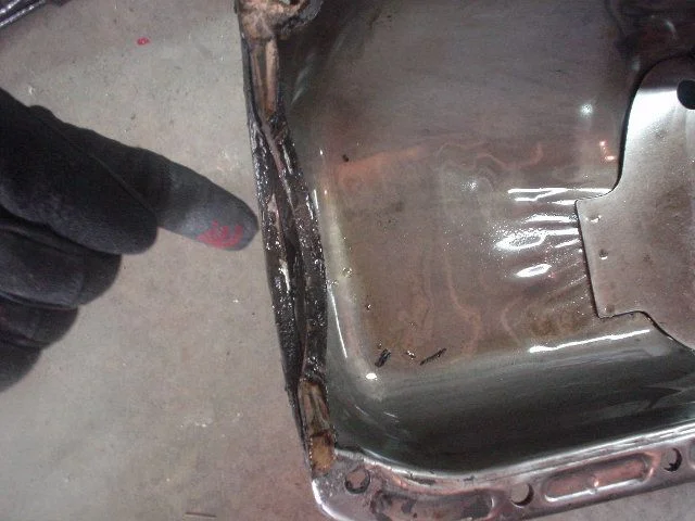

If anyone was wondering, this will cause a significant leak from the front of the oil pan!
When I put the pan on with the motor out I guess I m ade a rookie mistake. The front portion slipped behind the groove.
All fixed. Sure is harder in the truck though.

At least you did't pay someone big money to to put the seal in wrong.
ha! me too, i've installed that twice now!

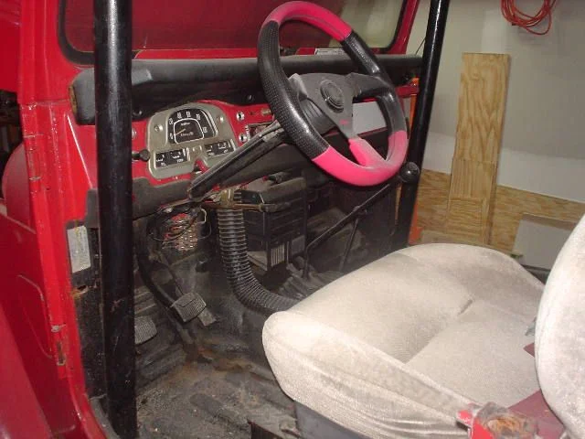

Here are a couple random interior pics:
Not sure what those seats are out of and not sure I like the mounts either. PO welded them out of square tube and diamond plate. I got some free stock '78 seats on the board and they are stored in VA at the folks house right now. Not sure If I am going to save those for :princess: 40 or not.

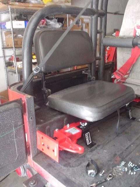

I then started getting the jump seats in I bought from Wadester a year or more ago. I had to fill 13 holes the PO left me on either fender well for who knows what. I got about 6 done. I also drilled the holes for the seats and welded in some steel T nuts for the top mounts. That worked well.
