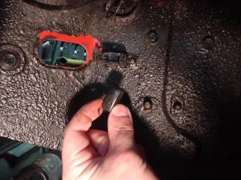

I dod not get as much done this weeked as I wanted but discovered a treasure. I found a box under the heater duct and had a suspicion what it was. I peeled back the herculiner and discovered my 12 Volt accy plug complet with cap.

Veery cool.

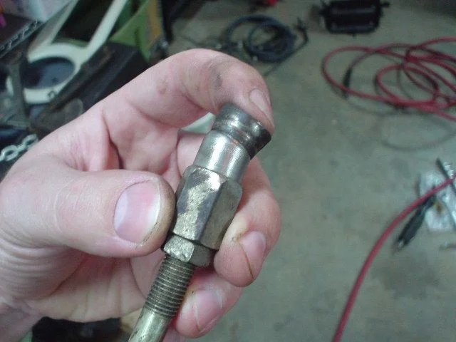

Not so cool was to discover (if you saw the thread in tech) that the PO used a spacer to give a bit more length to the clutch slave rod.
I am concerned that I will be unable to properly adjust my free play without something like that in there but am not to thrilled about sticking that peice of FOD back in my bell housing. We'll see.
attachment.php
I am concerned that I will be unable to properly adjust my free play without something like that in there but am not to thrilled about sticking that piece of FOD back in my bell housing. We'll see.
One other thing...I was right I would be unable to set my free play. As a matter of fact, that little gem in the pick above was keeping the rod from sliding completely through the damn clutch fork!!! Fxxx!:mad:
So I am going to hit a locak machine shop and get them to make me something, maybe happed like a dish that will fit in the hole to prevent the rod from going through or make another rod end that is a bit larger in diameter. I just do not want to take it all apart right now to replace the arm. :cheers:
If you are out of adjustment, I would be looking for the cause, wore out clutch, bad T/O bearing , a problem with the pivot ball or a bad slave cylinder as there is usually more than enough rod to compensate for normal wear.
Well, all that stuff is new. The problem is the rod end goes straight on through the fork! the fork is wore the freak out and I did not catch it when I reinstalled it. Live and learn. I will post a pic of the rod sliding thru the fork for your enjoyment later.:bounce:

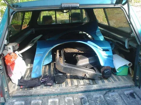

On the way to the blaster with some big stuff (including Sean's MR2 fenders)
My blaster Joe in Dalton. $120 and hour and he does a good job.

Finally...here is my shift rod issue:
The fxxxer willpush right through! And I am certain the fork is worn out not the shaft end. I do not want to pull it apart again so I am going to see if I can get a machine shop to make me a bit larger shaft end.

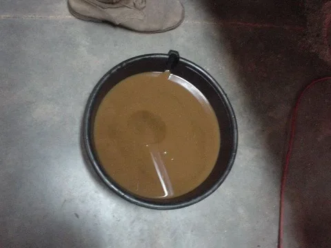

Just a quick update w/o pics. I drained all the remaining fluids today and all but the rear dif were full of water and looked absolutely moldy. I will post a pic of the goo. In the mean time I fabbed some spring clamps for the wife's build (which I still have not started a threadon!) Since tomorrow is a holiday for me I plan on getting the fluids filled, get the heater back in and replace the dizzy with the one I got from Barry A. I have some wiring to take care of that is a bit buggered so we will see what the day brings. I als want to get the wifes springs together (did two today) soI can get them off the floor of the shop. Pics tomorrow.
Well, since I am still up and drinkin, thought I would share a pic or two of the junk:
This is the tranny fluid and front diff fluid. Nice.:rolleyes:

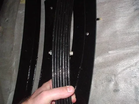

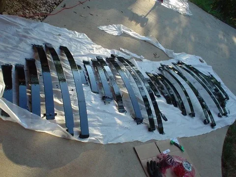

Here are the spring packs for the "other project" I put together with the aircraft fasteners I had in my tool box since Desert Storm
I think they are beat though. One had no tension left when I put it back together.

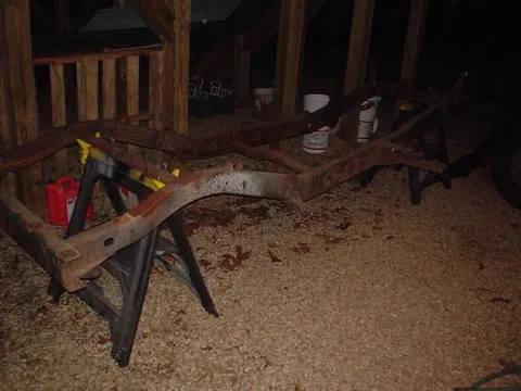

Here is the "other project." :grinpimp:
MH is now thinking the Purple People Eater. I was thinking Professor Plum - she is a teacher:bounce:
At least it has now been moved off the old smashed pallet and onto the saw horses for some work.
