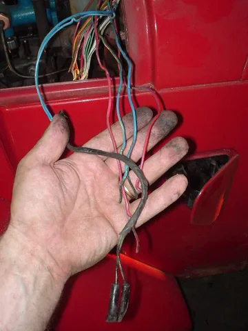

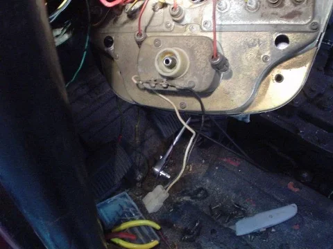

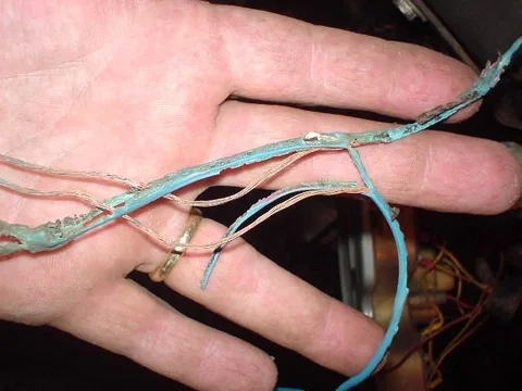

The PO had mentioned that the windshield wipers did not work and I kinda shrugged it off. I never even noticed the truck was sans a windshield wiper switch! (Anybody have one for a 1972 40?) Well, I examined the wiring and found the mess above. One of the wiper motor wire was fried and I think it was fried by the now missing washer bottle. Fxxxing auto manufacturers need to come up with a better system then wrapping everything like they do. Would make our jobs in the world as "enthusiasts" a little easier when dealing with a 40 year old car!
I started unwrapping the wiring to find how bad the damage was and discovered it was isolated to the wiper circuit. (Now to find some light blue wire - most of you would say this was going a bit far but afterall, I am of German decent and everything has to be just so or I will have trouble sleeping!) Unwrapping the wiring was as bad as it could have been as I did not want to remove the stuff since I have no bettery to tell me how I am doing (one the list for purchase this week is a small trickle charger that I can enrgize the fxxxer with.)

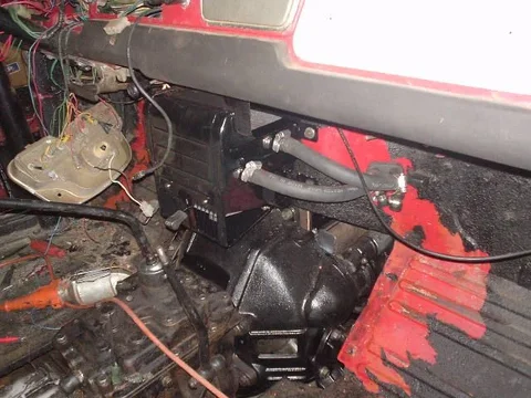

Also got the newly rebuilt heater in. Nice. It is the thing to the right of the horrible wiring mess. Thanks again, Sean - best part of the truck!:lol:

Here is another pic of the heater:

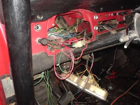

More wire to nowhere:

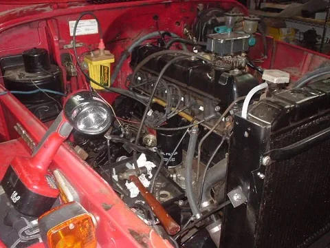

Got the dizzy I got from Barry A installed and wired (I am hoping not 180 out). I put the new plugs and wires in too. I have the Pertronix in the dizzy - Roger knows:D - and hope the ohms will work out with that Accel Super Coil. I am too tired to think anymore about it really. If not I will just order up a Pertronix Fire coil. I also have a stock coil Barry sent me so if I have trouble I could use that for a bit too probably.

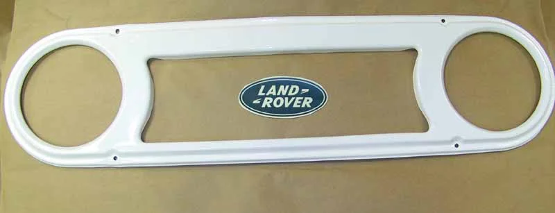

your bezel is done but still working on the gusset brackets.
just for the record, the powder supplier is TCI and the color is "Crystal White" #9910-9035.

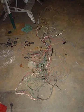

Thanks to Degnol I got a doner wiring harness and was able to repair a bunch of the burned up wiring and it has turned out pretty good. You thought what was under the dash was fawked check this out:

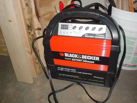

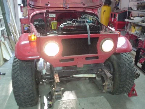

Anyways, I bought a really nice battery charger and charged the old beat battery during the week and for s***s and grins went ahead and turned the key to see what would hapen. Holy Moly!!! It turned over! I was elated. The headlights, tail lights and turn signalls all work as well. Dash lights too. I have to finish sorting out the windshield wipers and ensure the motor is not screwed I should be near!
Sweet charger. All auto pretty much:

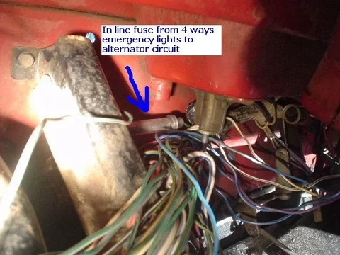

One thing I discovered and am not happy about is the fuse I discovered in line with the emergency switch hiding back behind trhe wire bundle in the worst place ever:
I replaced it and it blew after a few blinks which I kinda expected but when I traced the wires everything appeared in place with no bad spots. The left and right turn signals go no problem but that in line fuse keeps blowing when I turn on the emergency lights. The wire even bounces just before it blows! (My bet is on the freaking switch:crybaby:)
I also removed and cleaned the highbeam switch and reinstalled it and it now functions and I have brights. Not a big deal but it was stuck and I figured that could cause a problem (like a fuse bowing in the emergency light circuit - wrong)

One question though. What are these wires for? Certainly not lights. I have no matching plug in the wire bundle and I see nothing in the various diagrams I have. Anybody have a clue?

Turns out they are a speed sensor for an early smog device. So they are nthing that concerns me;p

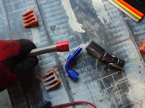

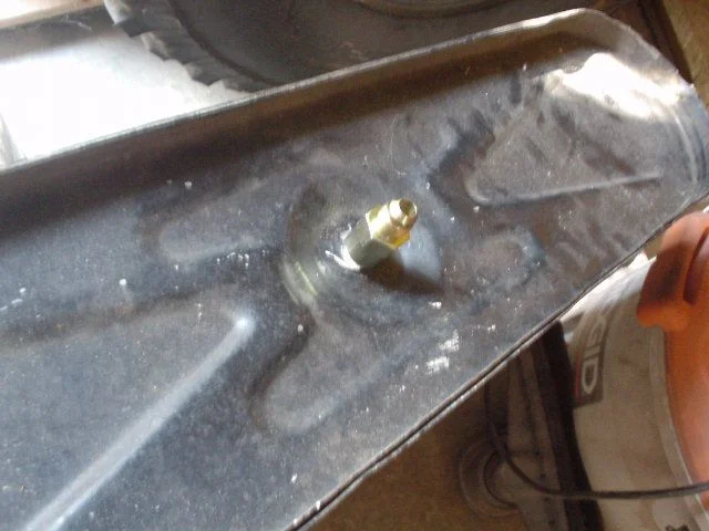

Now here is the fun part. I got the gas tank in. As discussed in this thread, there are few solutions for converting your British threads to American or something more practical but I found the solution I liked.
I purchased some parts from Jegs and from www.DiscountHydraulicHose.com to do the trick. Jegs is wierd and I will probably not order from them again. They sent everything one at a time Fed Ex anf I am hoping I do not discover I have paid for each trip. The sent a $369 part FedEx by itself - $12 shipping!!! Not good business sense if you ask me.
The Fuel line is Pro-Flo200 Series Braided Hose in a 6 foot length for -6 AN fittings part #555-100911.
Then there is the 90 degree Max Flow Swivel Hose End in -6AN part #555-100021 and the very cool Auto-fit Tube Mate to convert 5/16 hard fuel line to -6AN, part #361-360165.
Finally is the all important hydraulic hose fitting to goo from 1/4" BSPP or Whitworth thread to -6 AN. Part 9009-06-04.
This is about where Roger starts laughing at me as the investment was rather large in comparison to other more obvious repair methonds but I always wanted to use some of these cool anodized godamners.
So I did some research on the whole -AN thing and what I learned is that "AN" stands from Aeronautical Standard and is a flare fitting that is just like "JIC" or Join Industry Council offered by the discount hose folks at 37 degrees instead of the standard 45 degree flare that you would use in your basement or kitchen. -AN sizes are based on 16th's measures so -6 AN is 6/16 or 3/8. 5/16 tubing (about the size of the hard line in the 40's)is therefore -5AN. So if you want to do this, -5AN would be right but -AN fittings mostly come in even numbers although some -5AN fittings are available and 5/16 JIC fittings from the Hose Folks. Get it? Good.
So I test fitted the adapter on the tank and was elated that it fit.
And set about cleaning the outside of the tank a bit. I kicked myself for not bringing it down to the local radiator/gas tank place to have it boiled stripped sealed and painted there since it has been sitting on the garage floor for months but screw it.

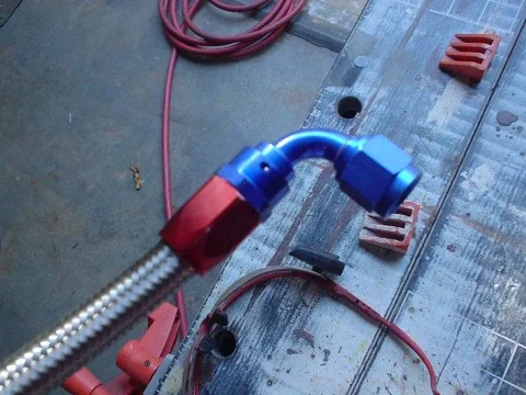

I started to assemble the first hose end.
The red end actually screws on to the hose and then the blue piece screws into the red piece making a great strong seal.
