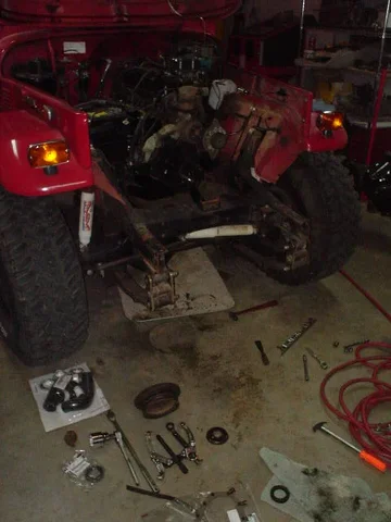

Here it is all ripped apart again:

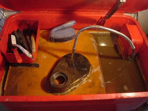

And cleaning the cover. After it was dry I sand blasted it and painted it with engine black:

And here it is all put back together. (At least before the radiator and bib went back on.)
It was soooo easy. I wish I had done it before I put the engin in. I am unsure why I did not bother. The FSM has a detail of where the long bolts go so I did not worry about keeping track. I also put a bit of sealant on the lower 10mm bolts as advised by the FSM. I am sure this will take care of my leak.
