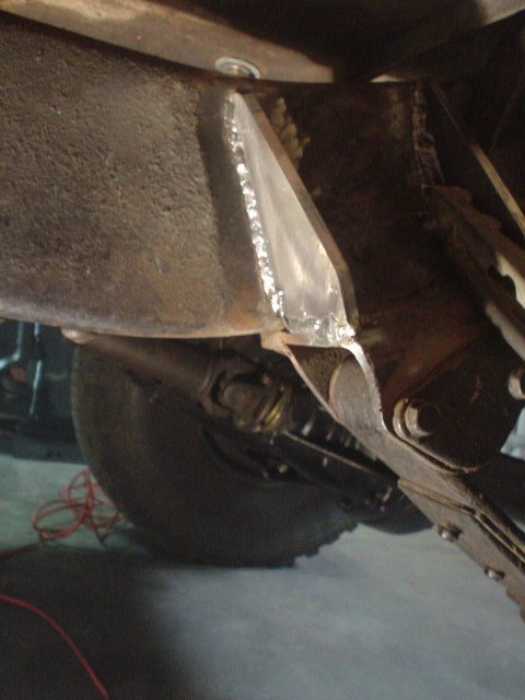

I went ahead and fxxxed around with my 110 welder today. I definitely would not try to weld my scab plates on with it but I went ahead and welded on some spring gussets. Not a bad bead if I do say so myself.

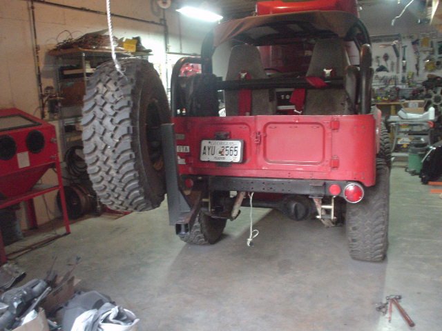

Then I rebuilt my spare tire carrier.
The upright was centered when I bought the rig and I really did not like the placement so I tore it apart and moved the upright over about 8 inches. I added a couple brass bushing to make it tight on the mounts. I was going to get it blasted and powder coated but since I consider it temporary, I figure rattle can is good enough. I didn't even really prep it. Figure if I ever get this thing on the trail and it operates like it should I will drop some change on a 4+. I really like those.

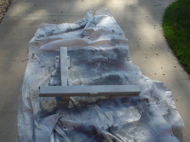

Got something else done:
It isn't perfect but if it keeps the spare from falling off or rattling it is ok by me.:bounce:

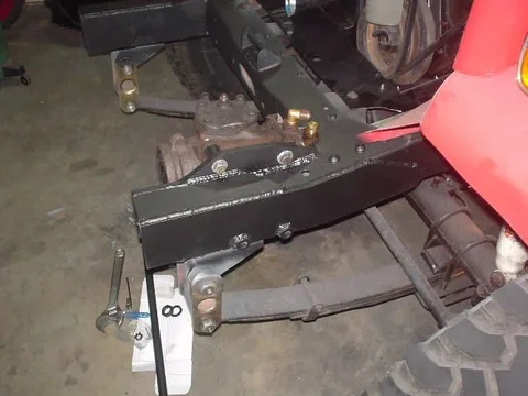

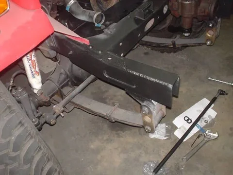

Well almost anyways. I paid a guy to come weld my junk. He did a great job and I actually felt bad he was going to charge me so little so I hooked him up. I am stoked. You can see from the pigs that I got all the plates on, primed and painted the mess and remounted the fender. I also got the steering wheel on straight and mounted the pitman arm (That was simple enough to get straight - it has notches so it will only go on one way) and I attached the steering shaft. The DD shaft rubs just a bit on one of the engine mounts so I will grind that down a hair. I also got my belts at Napa the other day and they are on.

Gotta get a couple bolts tomorrow and I am waiting on a new radiator to be delivered from Autozone. Yep, Autozone. $225 delivered to the house, all metal, lifetime warranty. That should be here be Tuesday. I will have some spare mornings to get all that mounted and get my PS cooler mounted. I have a fitting for the return line (the brass is in there to prevent junk from getting in the box) and the last thing is to figure out my high pressure line. I have the old fittings and there will get the dude who did my brake lines to make it while I wait or buy one of the Heep lines that can be modified to fit.
