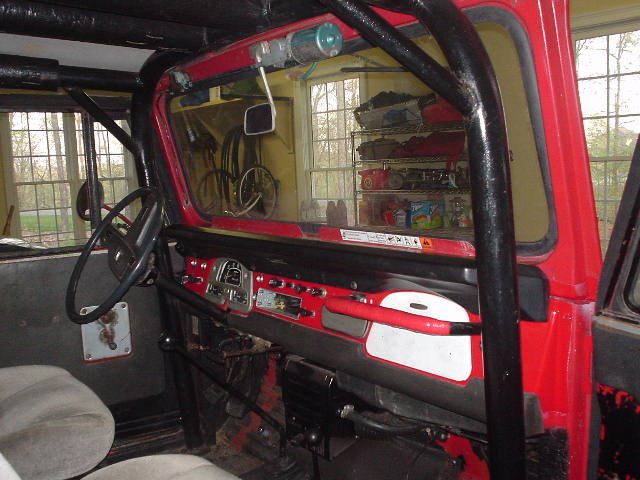

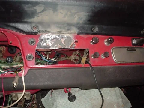

I have no idea how I got into this but I tore my dash apart and am painting it. It had several colors. The dash pad cap was all fxxxed up so I tossed that and am in search of a new dash pad. TPI does not have them any longer and I am not going to spend $500 on that.

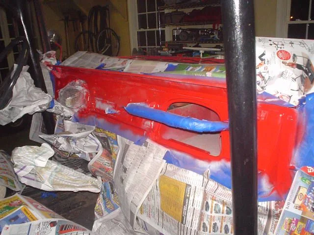

Now I remember...While I was mounting the doors I was unable to get the top pins in place so I pushed the windshield forward and found a real mess. Spent the last two days sanding and cleaning out the scale and priming and painting the mess.
I have discovered that a red that Rustoleum sells is the perfect match for the red on my truck. Must have been a DIY paint job last time.

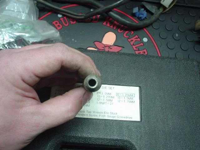

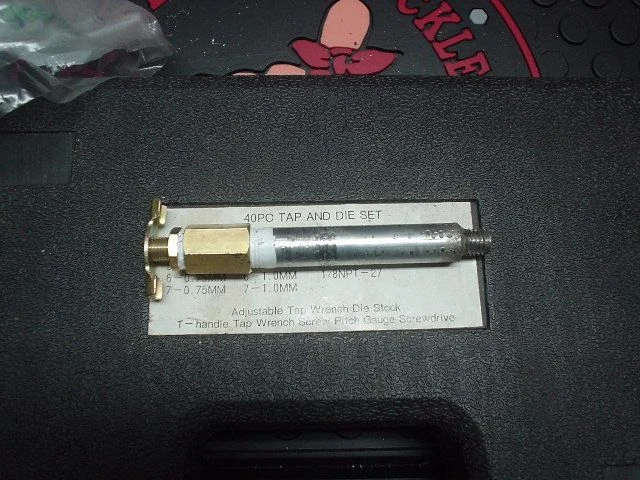

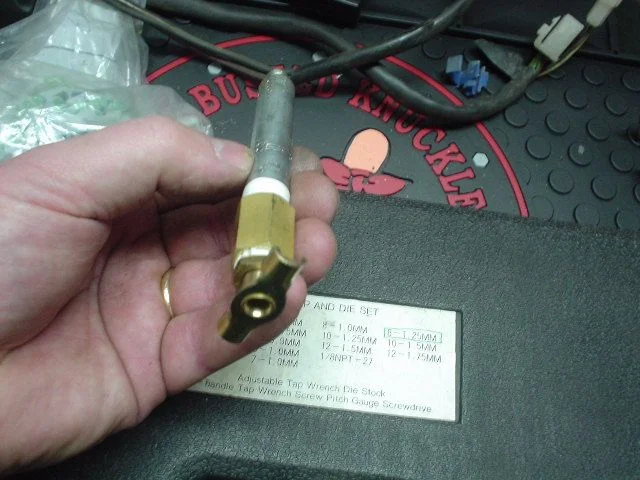

Next. I dropped the rear of the trainy and replaced the tail piece with the double seal one that Poser machined for me. Seems all good. I also replaced the radiator. One thing I need for the radiator is something that will allow me to put a petcock back in it. The radiator is an Autozone aftermarket with a lifetime warranty and it was cheap but the drain is 10mm x 1.50 thread and has no tail piece on it. I am going to try to make something today. It is almost impossible to install the plug.

This is what I came up with for the pet cock. s***y HF tap went in a little crooked but I think it will work.

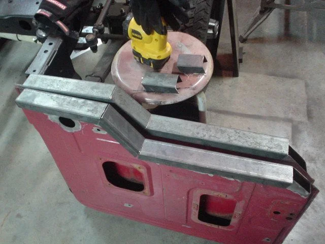

And thanks to Sean, I started finally working on my half doors. They were on the truck when I got it but the tops we open and the doors were full of mud and debris. I washed them out and wire brushed the inside a bit and washed them out again. When I am satisfied they are dry I am going to spray the inside with some cheapo Rustoleum Rust Reformer. I am sure it is only worth what I paid for it at $5 a can.
The PO did not cut them quite the same but I didn't care enough to trim them. :meh:
Then I will weld them up. I will remove the crank and gears from a stripped window crank set to fill the holes on the inside.
I know, I know, I should be working on my oil leak :mad:
I plan to sand them down and shoot them with the red Rustoleum that I discovered matches the truck paint perfectly.

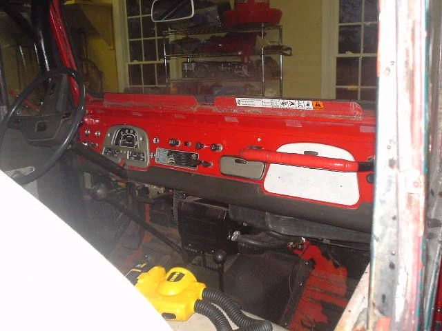

Put a dash in I got on the board for just $90 shipped. Although it is cracked it is far better than the POS that was in there.
I need to score a couple of these guys though so I can screw it down.

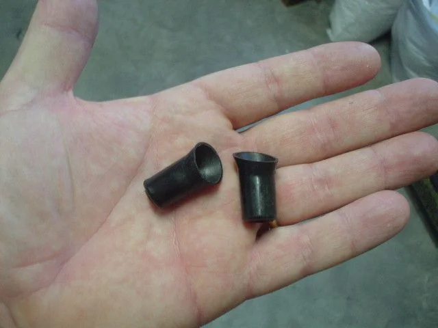

The PO had used sheet rock screws to hold the old dash in. I replaced all the threaded inserts which were all rusted out or seized with rivnuts.
