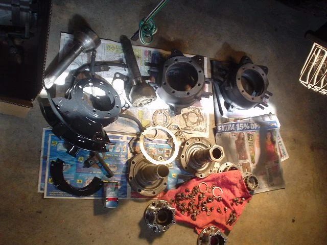

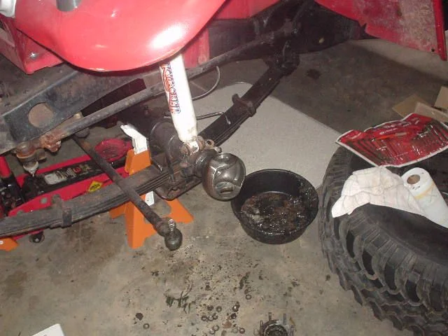

The mule is getting Toyota discs. I discovered that the passenger side upper and lower knuckle bearings were toast. I also discovered that the Toyota mini disc brakes i got were missing cone washers :flipoff2: I got one side done and am waiting for a shipment from CDan since i could not find any elsewhere that weren't doin nothin. I also discovered some badly damaged spring bushings. I have those and will replace them once the other side is reassembled. I got a box from MAF today that includes nearly all I need for the Sag PS switch over. The only thing I am lacking so far is a pump mount, plumbing, a pulley and a goot welder...oh - and the freaking time!
Some proof anyways.

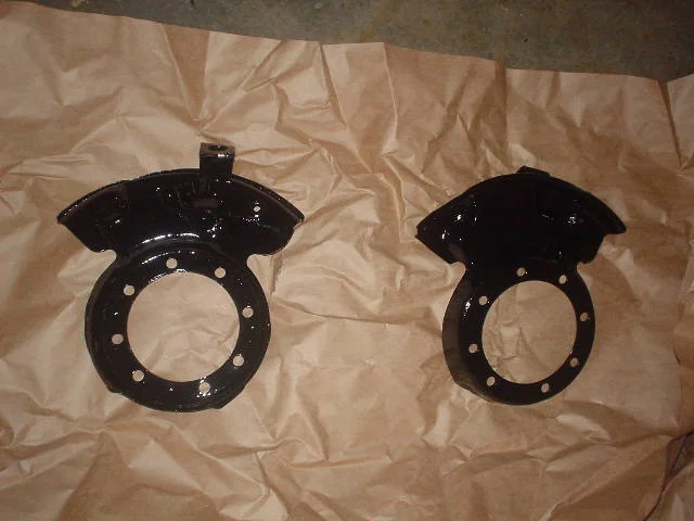

This is what I did with the mini truck backing plates. Thought it was pretty sano.

Well fxxx. Discovered that the caliper mounting holes on the passenger side knuckle are stripped out. Got some 12mx1.25 helicoils coming. I think the threads came out with the bolts. I ran a die down the bolts to reuse them and discovered the threads clogged...pretty much with more threads. :crybaby:
OK - 3 days later and the caliper mounts are fixed. Ordered the HelioCoils and drill bit and they came in no time flat. Put them in this evening. Very easy and they took proper torque. I had to make a new short brake line on the drivers side as it is no longer available from the dealer (I guess I could have bought a 10" pre-made from Autozone for about $5 but what the hell - I will do that when this one leaks.) I have purchased two sets of soft brake lines and neither are correct. I need them with female threads on both sides. I think that the threads on the Toyota lines are 10m x 1.0. I may go with some aftermarket junk. May make a trip to advance or something tomorrow to see what I can find.

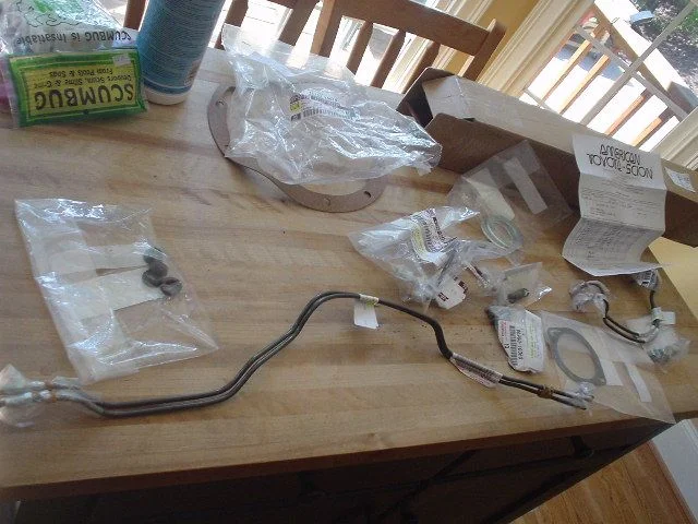

I have been fxxxing around trying to find the right soft lines to go from the hard lines at the calipers to the hard lines on the axle. I wastes some cash of course but then went to a place here in Rome called Sisson Hydraulics. I did not know what to expect in getting soft lines made and had no idea what it would cost. THe place is a bit off the beaten path and when I got in there the guys seemed pretty busy but I noted they had a sign that said "We make brake lines"
After few minutes the owner got to help me and was very nice and accomodating. Made me two 12 inch lines with 10Mx1.0 female / male bubble flare inners in about seven or eight minutes and the two hoses only cost me a total of $25 and that included some new e-clips to hold them to the mounts. They fit perfectly with just a bit of effort to get the eclip seated.

Kind of any way. I finished the mini truck swap. Too a lot longer than I thought. I posted a pick of my custom brake lines in the Guppies mini truck swap thread.:
The soft line is one of the ones I had custom made.
