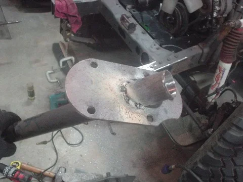

Then, with the column disassembled, I used a scab plate I had gotten cheap from MAF and tacked it to the shortened early model steering column.

Then I cut the rag joint off an old buggered late model steering column and carefully ground the double d in the end. It fit the Borgenson U joints perfectly!!!!

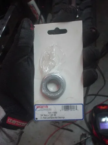

I had purchased a couple go cart bearing from Northern tool for like $5 and to my surprise, one fit perfectly in the end of the steering shaft housing. I just tapped it in place with a hammer. The shaft feels great and is centered.

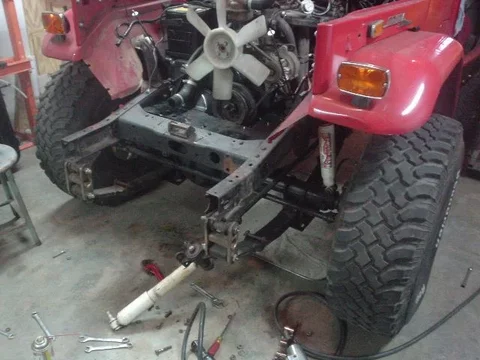

Finally, I tacked the passenger side scab plates in place and got the fitment set up on the driver's side mount and reinforcement plates that came with the kit. I had to actually cut a slot in the bottom of the frame for the rear sleeve but I figure with proper welds (which a friend will be doing) on all the reinforcing, I should be good.

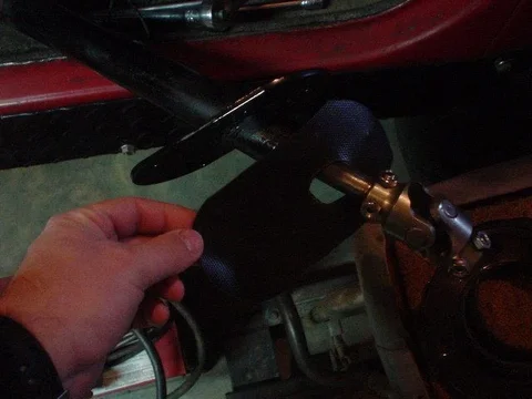

Finished the steering column. Used a piece of virgin PVC as a seal. Stretches nicely over the column and is very pliable. I got a big sheet from a guy who works at a recycle place who was showing me around.
