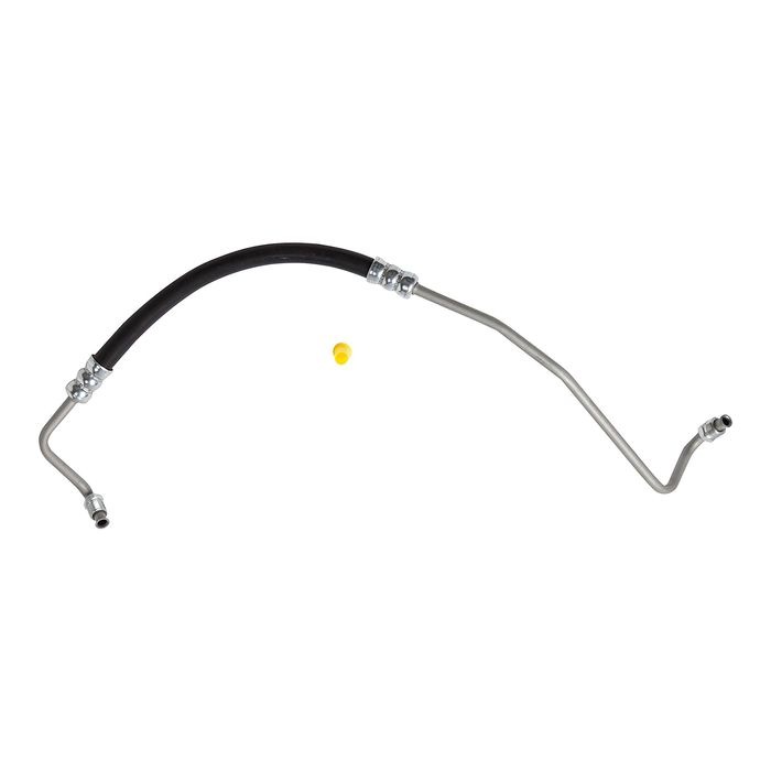

So I finally got my Advance Auto Parts high pressure line. It worked surprisingly well. It is from a 1978 Jeep CJ V8. Advance pat number 91473 :
8
I just had to bend the steering box end a bit to make it a snug fit and had to twist the hose just a bit. The Pump end was about 90 degrees out so cork screwing the hose lined it up perfect.

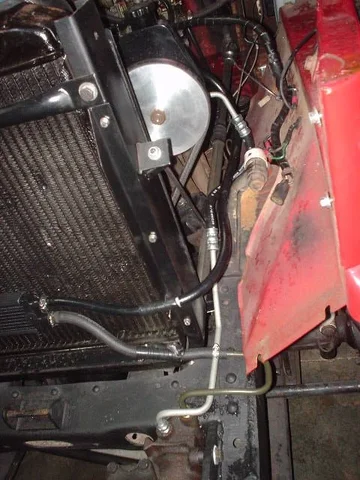

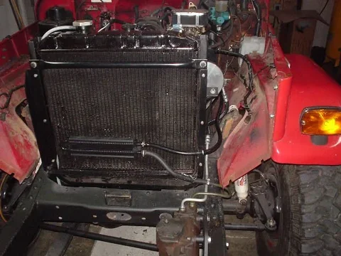

I had a guy at a hydraulic shop make the return end for me so it would go around the side of the bonnet.
I had to cut notches in the front of the radiator mount for the tubing to feed thru. I wrapped the tubing in some pieces of an aluminum can and put tape around that where it may rub on the sharp edges of the radiator mount.
