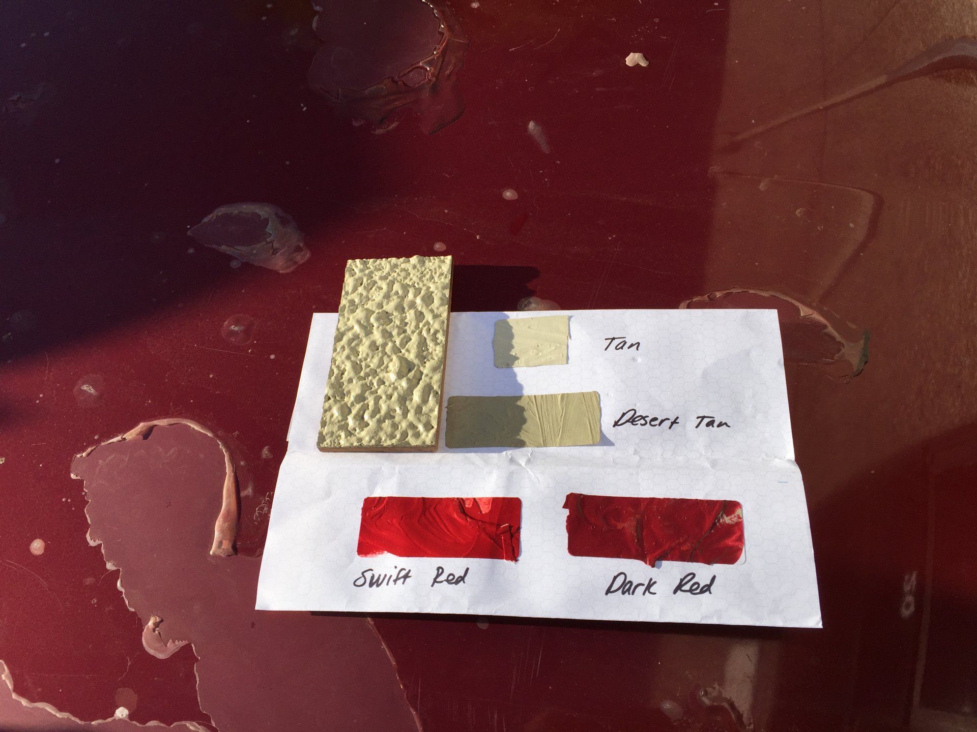

I have actual color samples of tan, desert tan, red and dark red if anyone wants to see them vs. the generic MS paint colors on their website.
I emailed them to see about getting desert tan swatches... Can you post some photos?
There's no reason why you shouldn't be able to roll this stuff, but definitely experiment and practice before you mix up a big batch and have at it on your rig. Things like the nap of the roller, cure time and pot temperature, additives (i.e. crumb or vinyl flattener as in Al's Liner), ambient temp and humidity, will all affect the texture you end up with.
I'll post pictures of the color samples I got when i get home. I found some rollers on amazon that look like the monstaliner rollers but are blue that say they are for bedliner application.
Here is a picture of the color samples I got. The photo from my phone is a little off, the dark red is a much closer match to the factory color than it looks in the picture. The textured sample is marked desert tan on the back but is lighter than the desert tan on the paper. I think I'm going to go desert tan, no rubber crumb and roller for application to get a smoother texture than the sprayed texture sample. I think their tan is probably close to the factory tan of the 80's trucks but I don't know anyone who has a toyota that color to match it with in person. The kit is 3 gallons and they said unused product has about a 2 year shelf life which is nice for any possible touch ups down the road.
