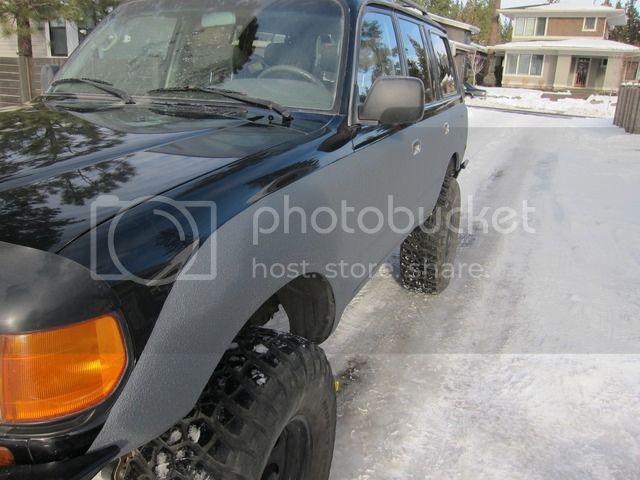

I have done the bottom half of my rig about 5-6 months ago & w/in the next couples weeks will do the rest. For those of you that have went back @ a later date & finished lining the rest of your rig, any special advice to making it blend well?
Used the harbor freight popcorn gun to shoot mine with Als over two years ago and am very happy with it. It took 2 kits that I got on sale using some AA coupons, total said and done was $189. Make sure you let it "cook" for five minutes after mixing before you start shooting or it will run and clump.
