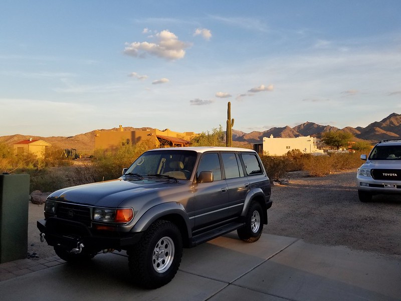

Yea I get the "baby puke" or "pea soup" green comments all the time. I don't care, I love the way the ol' snail looks. IMO the two-tone does a bunch to make it look good, if my whole rig was sans panties I think it wouldn't look as good.

@SmokingRocks the 2-tone definitely helps. I can't believe how different your truck looked in your just washed driveway pic compared to the 2 out in nature.
