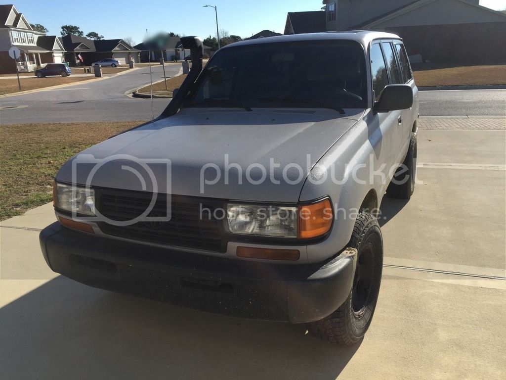

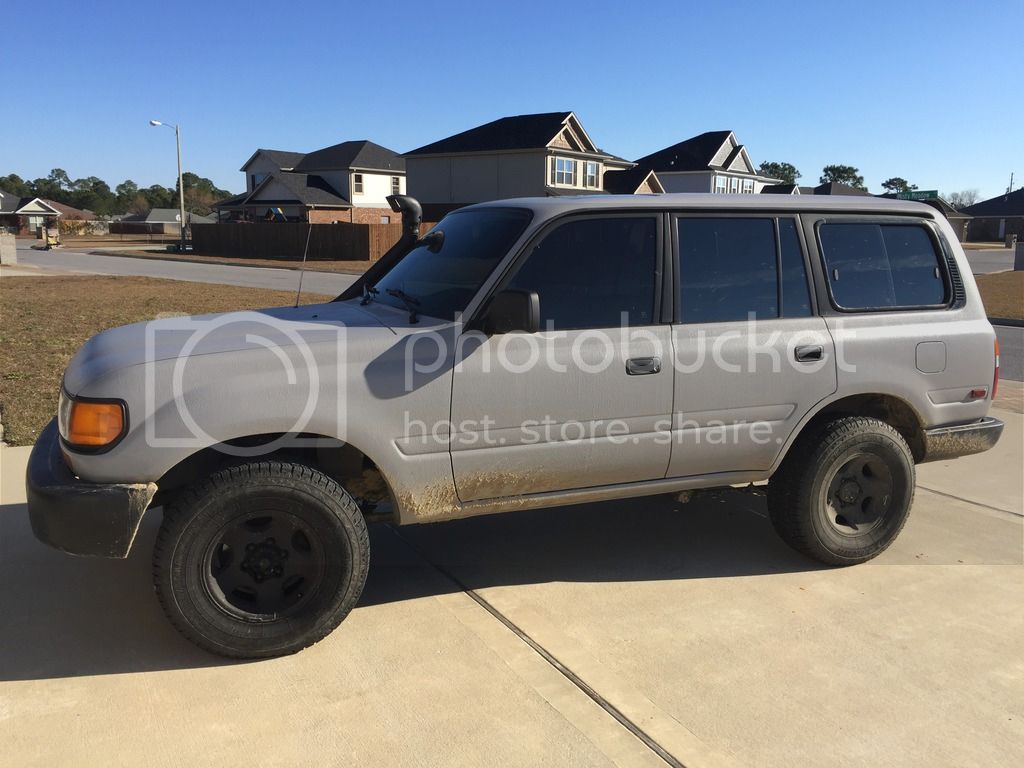

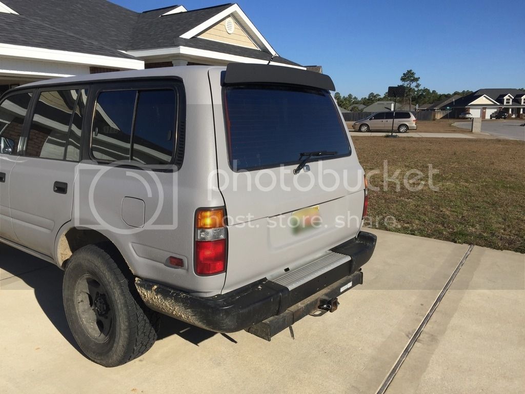

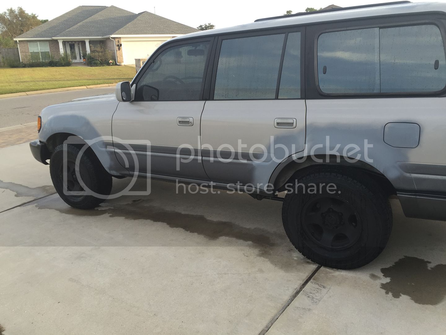

I ended up going with Light Quartz Grey.
Yours is the first I've seen in this color and I like it. Could you post up so more pics of your 80? Thanks
Has anyone done their rig up with the Medium Quartz Grey? If you have, please post some pics .

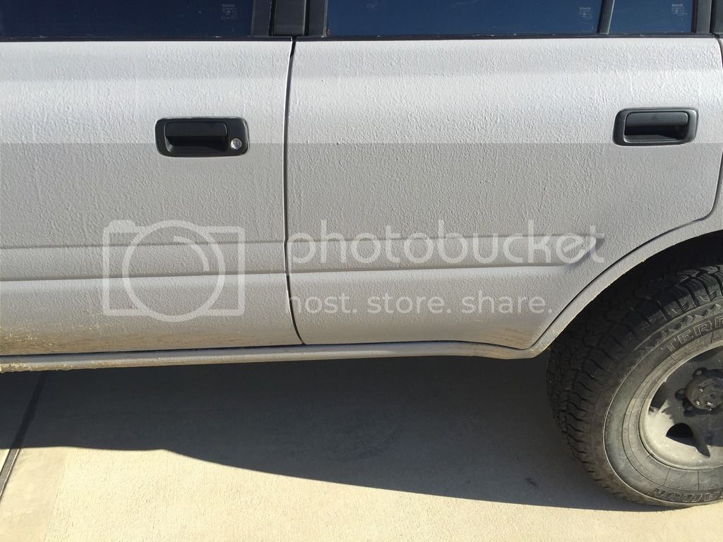

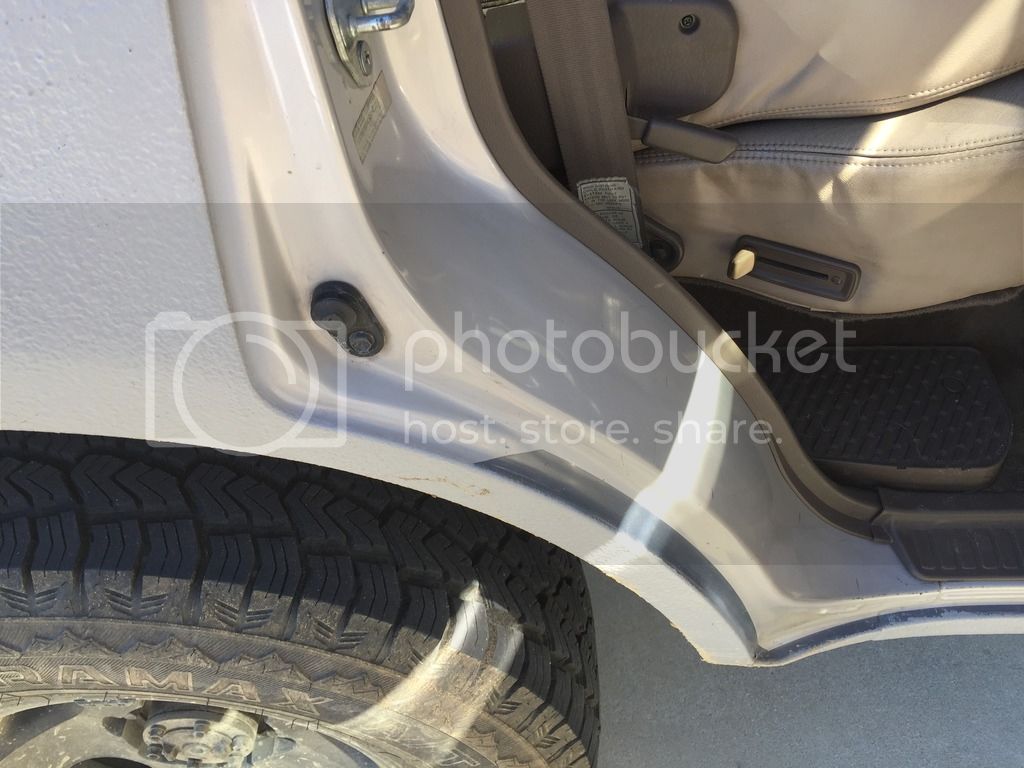

Thank you. It's not too noticable at the door jam. Do you have any regrets or advice?
I should have taped the bottom of the door jamb, it did not end up in a straight line (the rest of the door frame was fine without tape).

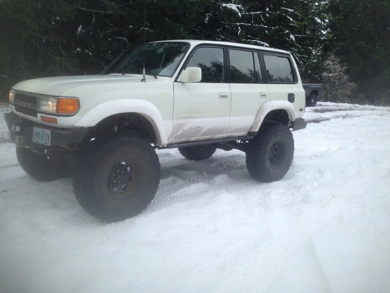

I'm being steered away from tinting my upcoming Monstaliner job Toyota 045 white by a friend who says white will become permanent fly dingy looking so I'm considering other colors. There has been some talk about the newer Subaru Desert Khaki H6Q.
Can I get some opinions on these two colors for my now white 80 or factual comments and photos from any one who has use Toyota 464 beige, the Subaru Desert Khaki or Monstaliner color Medium Quartz Grey?
It appears that you 93 is factory 045 white and you have applied Bedliner (brand?) in a brighter white along the bottom of the sides.
My question: What brand liner? Have you had an issue with the white Bedliner becoming grungy looking and not wanting to come completely clean?
