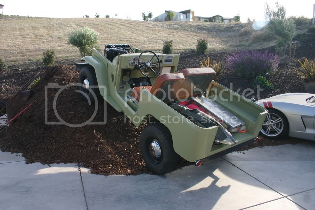

OK, couldn't resist, that pile of bark was mocking me!!!
BTW, I got my ebrake sorted out., pulled the drum and saw that the cable had somehow disconnected, works well now (as you can see!!!)
Having fun!

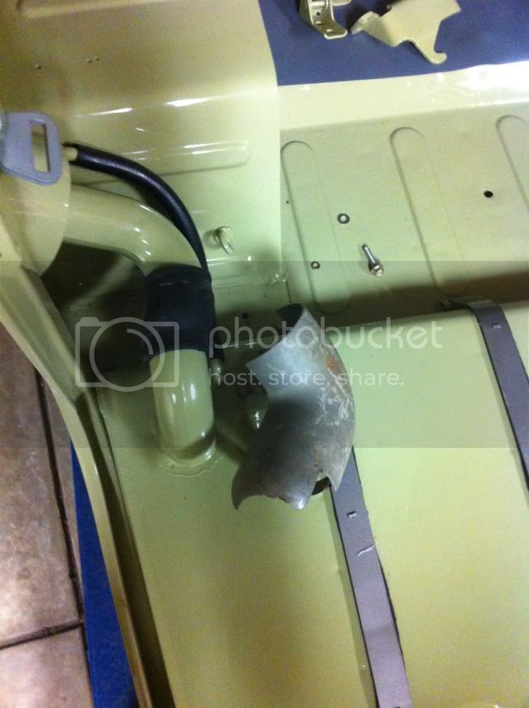

Now, question for you. I was able to score this part off of ebay, but didnt have time to confirm it was correct for a 64. It was listed as taken off of a 65, but fits my rig. Question is, did they use these on 64's? If so, I can restore it and paint (body color I assume) and get her on. This is a shield that covers the fuel hose, is made from fiberglass with an integrated clamp.
Whatcha think?
Chris
Yes, go ahead and mount it. However, it was grey originaly like you see it now. So restore it back to grey.
AWSOME WORK!
:beer:
Grey it is, thanks!!!

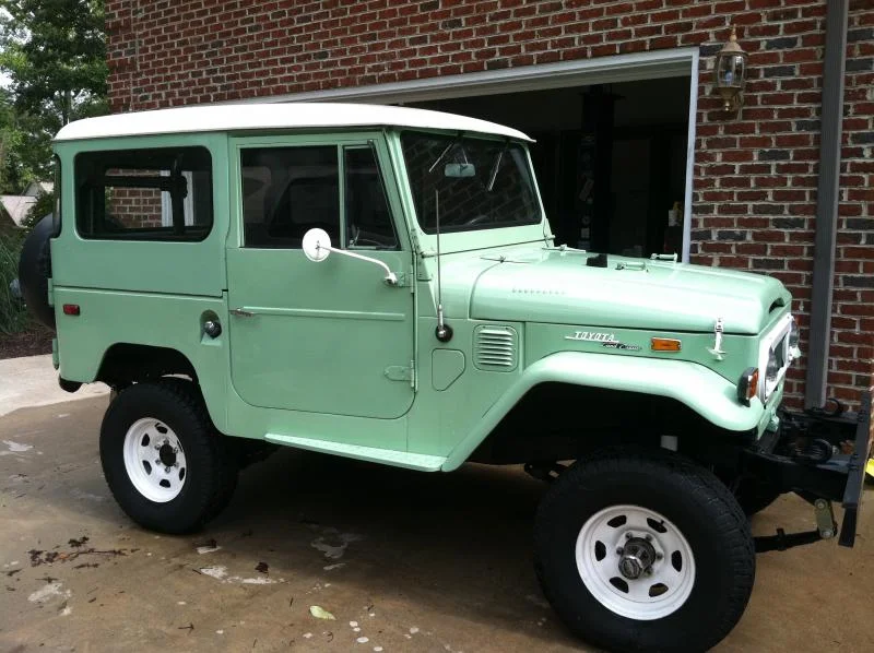

That's a beautiful car! I need some help, please. I have a short wheelbase 1988 LandCruiser and I am decided on painting it Spring Green (T1028) BUT i'm in Nairobi and no one here can show me a colour reference for the paint, and I'm not confident I don't think to match it by sight from photographs... Or am I over-complicating it? Basically, I can't get the original colour from Toyota, all I can get are pictures online! How do I decide on an actual paint colour from this point? I notice some of you guys seem to have already gone through this exercise and would be VERY grateful of your advice on what colour I should be painting the car. I presume once I have an accurate reference I can get someone here to match it.
Thank yoU!
jessica
https://forum.ih8mud.com/attachment.php?attachmentid=570395&stc=1&d=1320709777
Jessica,
Do you have access to a PPG paint dealer? I recall my PPG paint guy was able to find the formula in his computer for spring green for a 1967 FJ. He could have then mixed it up perfectly. You are lucky to have picked a color that is in the computer. My color, sulfur yellow, was not.
If you do not have a local PPG dealer, someone may ship to you. The color is easily mixed from the information in their computer.
Hope this helps.
Chris
Heres a secret regarding spring green, and several other Toyota colors from back in the day. Toyota used the RAL standard for several colors. Spring Green is RAL 6019. Its a universal code. Your Home Depot guy can even mix you a batch. How do I know this is a fact? Me and my paint guy went through this process for over two hours. Spring Green and RAL 6019 mixed at the exact same ratios in his machine.
Dont tell anyone... :)

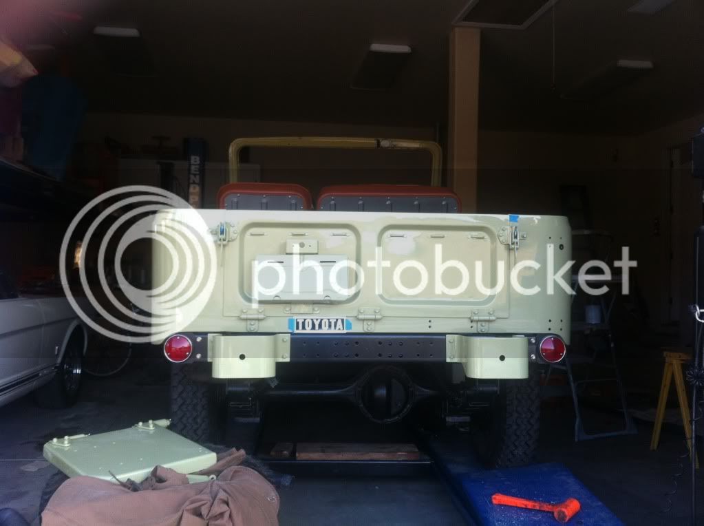

Did FJ's originally have any weatherstrip installed around the dropdown tailgates? My tailgate touches the body in only one place, top passenger side, and I will need something to prevent the paint from getting jacked up. Mine didn't have evidence of weatherstrip around the tailgate, but thought I would ask the pros.
Also, all of the pics I have seen of the 64 TOYOTA sticker installation are on barn door rears, how does this mock up placement look?
Thanks Yall,
Chris.
Not sure the years and corresponding part numbers, but yes the rear gate has weatherstripping. Three pieces
Also - do you have your tub-side hinges rubber gaskets in place? It might be affecting the fit if not.
Firstly,
Thanks Yall,
Chris.
Can't help you with the weatherstrip, but the TOYOTA logo looks great, but looking at the old pics, I would say probably a little more to the right :)

Cool, thanks guys!
I will have to find a suitable substitute for the weatherstrip. Expect a pic of logo soon MWSNFJ. Thanks for placement help.

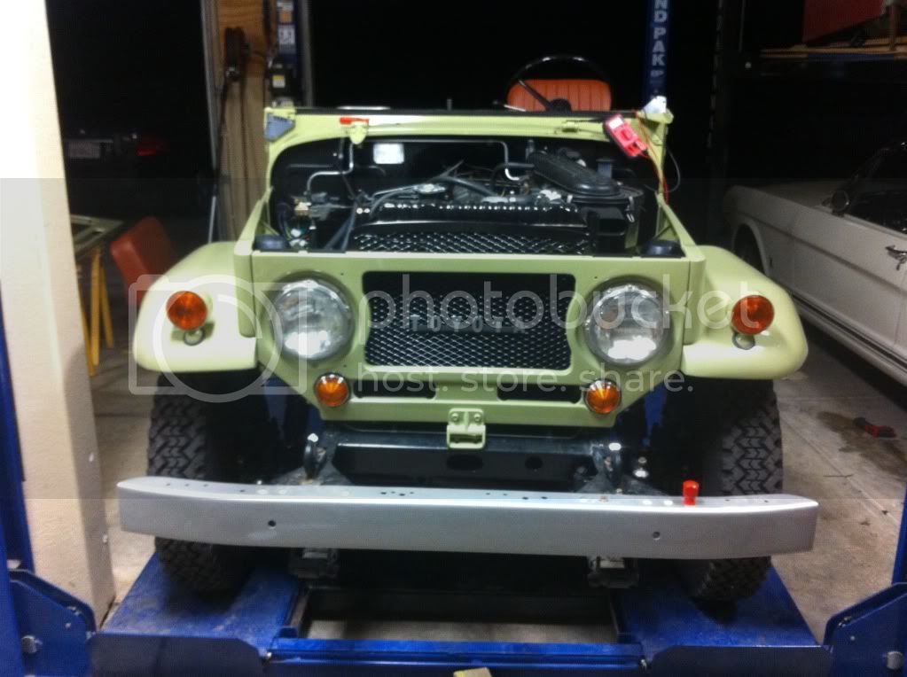

Firstly, I put the body together and hit a snag.... I could not get the front clip lined up properly. You can see it to some degree in one of my photo's, but the front of the hood does not line up with the bib/fender. Especially on the passenger side. Before tear down I recall it lining up...
This was the cause for MANY an "EFF-BOMB" in my garage and way too many hours trying to sort this out. I removed all of the bolts holding the tub on and loosened everything. I used "come-alongs" to tug the tub every which way but loose but could never get this perfect. I will take some better pics... but the only way I could get myself to work on ANYTHING FJ related was to "get over it". The more I thought about how I couldn't solve this problem, the angrier I got. Sooooo, I moved on...

see the front end doesn't line up well here:
