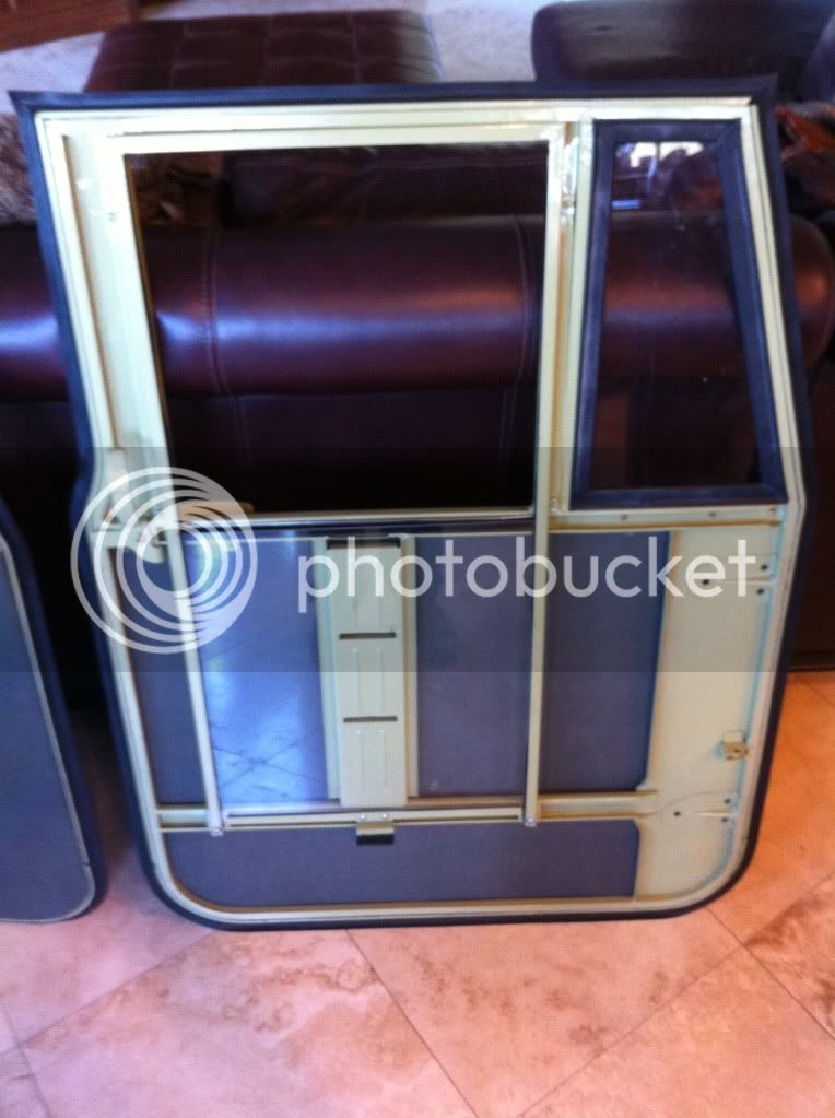

FST Doors rebuilt
Folks,
Thought I would share some status from the weekend. Spent some time working on the doors for my rig.
Firstly,
Kudos to Dave at Genesis 4x4. His door glass and wing window weatherstripping is perfect. I honestly cannot tell the difference between the OEM weatherstripping and his. And I can attest to their build quality as well, as getting that last corner installed takes some yanking and flexing, and everything held perfectly.
Dave also hooked me up with a replacement for one of my window handles/the thing that holds it in place. YAY.
Thanks Alex at Paktops for the OD canvas.
Thanks all else for help and advice.
Sooo, before paint I had the frames sandblasted and had some rust repair to do, primarily on the bottom frame and the door weatherstrip channels. I also had about 50% of the screws holding the channels need to be cut out. So once everything was painted I had to re-drill some new holes and line everything up.
Next I needed to get some replacement screws and couldn't find the right size... A #4 was too small and on a #6 the head was too big to fit in the channel. My solution was to use my cordless drill (thank you santa) as a lathe and use my bench grinder to reduce the diameter of the screw heads. Worked great.
Next I attached the canvas using "Amazing Goop" glue, my wife and a bunch of clamps. Started with tension from top to bottom, them glued and tensioned the sides. Attach the weatherstrip frame/channel and all is set.
Next I installed my new (SOR) door weatherstrip and felts for the window channels. My hands are still sore from the door weatherstrip. It was a pain to install. I ended up finding a heat gun to warm the rubber and a flat bladed screwdriver got the best results.
Installed the window glass and built a few rubber bumpers for the bottom using a block o' rubber I have, and bingo - working windows.

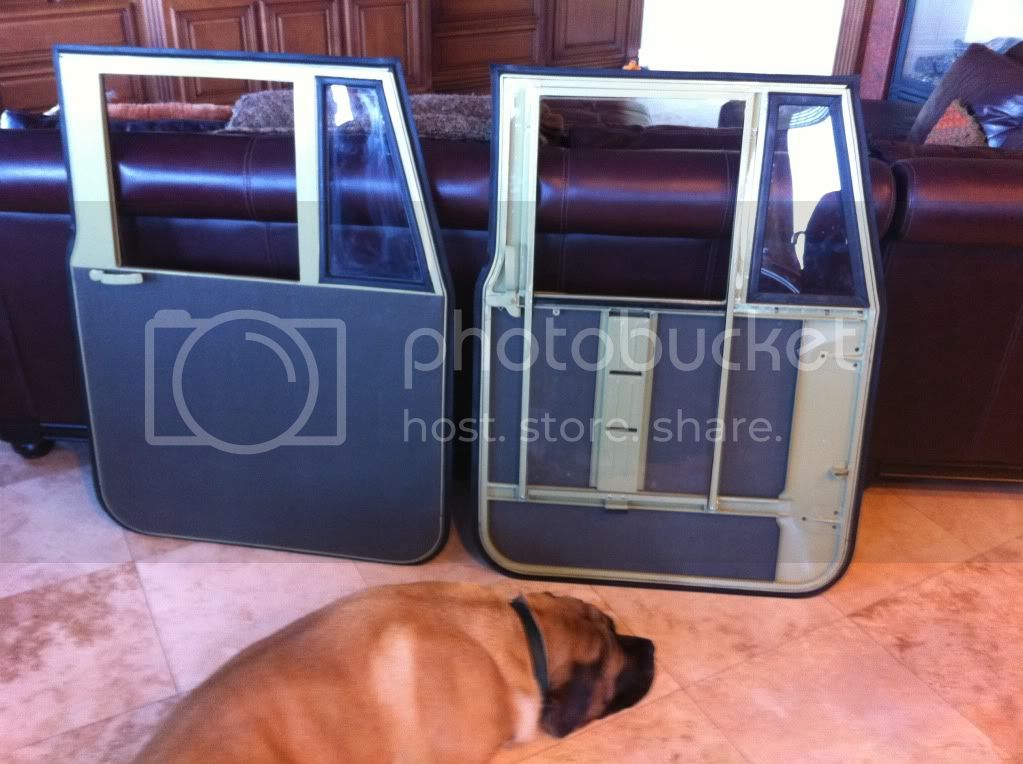

Next up, the door handles. Did I orient these correctly? I think I did.

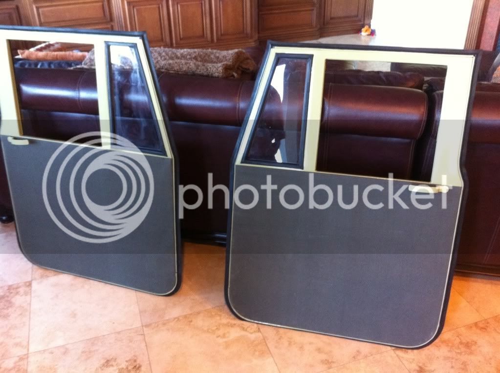

Check out the results. I think the OD canvas on the Sulfurt Yellow looks AWESOME!!! These pics are cell phone, so take my word! ;p
QUESTION - What color should the door handle springs be? Body color?
BTW, This took a while. I was at this for the better part of 7-8 hours, not counting the paint work.
