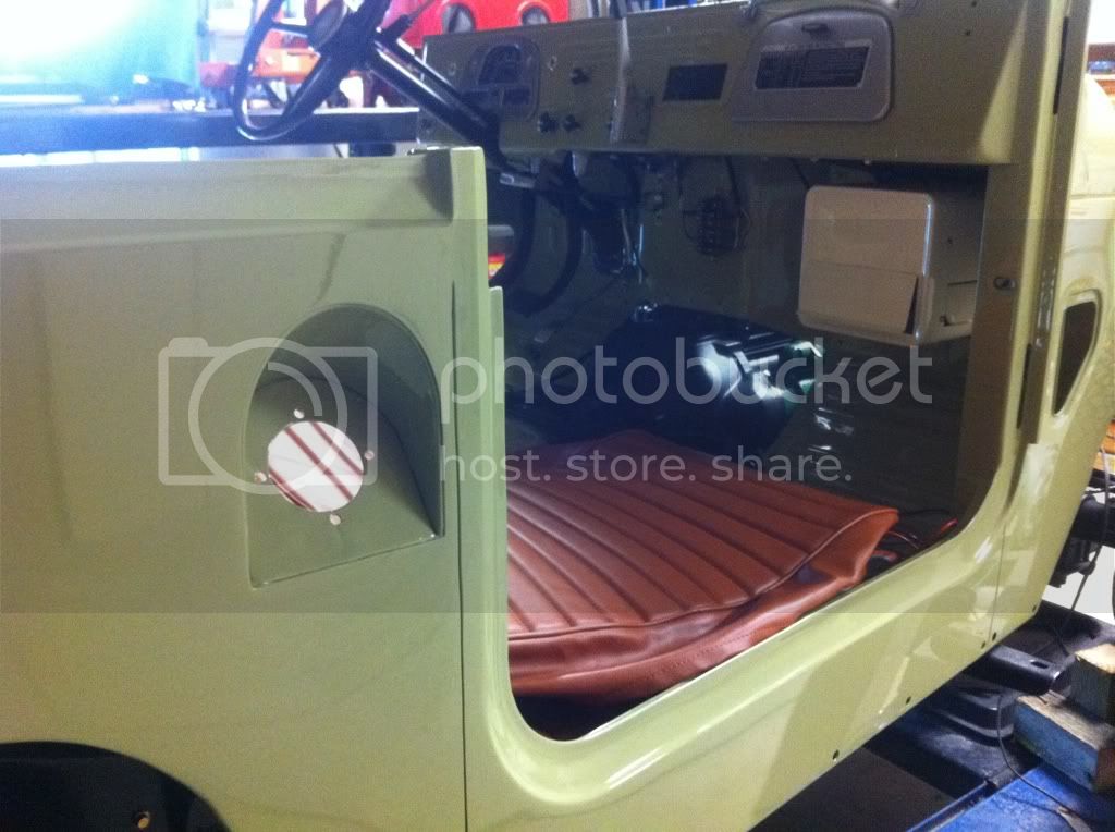

Omg Shane, these are going to look smashing. Not the best camera, but sulfur yellow + Wimbledon white heater + these new seat covers!!! Wowzers.

I'll tell ya, I am smitten with the old school colors. The sulfer yellow is trully unique, then add that creamy white heater and coral seat covers and it looks like a time machine. I am going to start covering my seats this week/weekend.... We'll see how that goes. Seat frames all painted and have new pads from SOR. Need to confirm I got everything I need for the seats, welting and such, from Shane then get into it.
