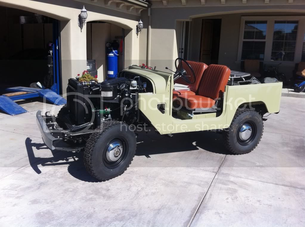

Took my baby out for it's first test drive around the block.
Baby drove great. Brakes felt good and the FD engaged perfectly. Funny without the tranny hump plate how well you can hear a brand new clutch breaking in! Was a nice motivational trip around the block!

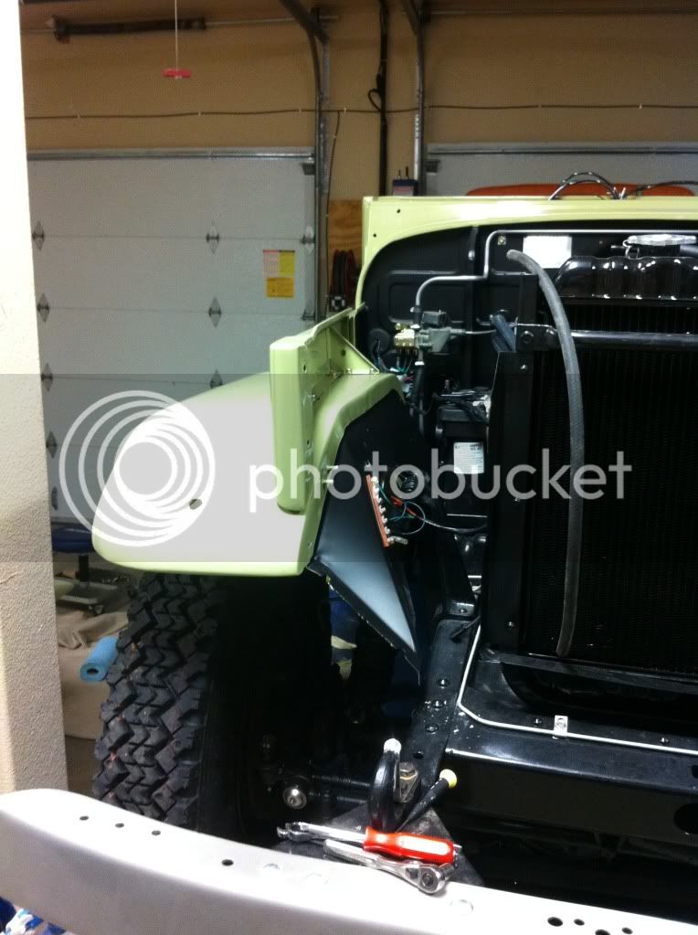

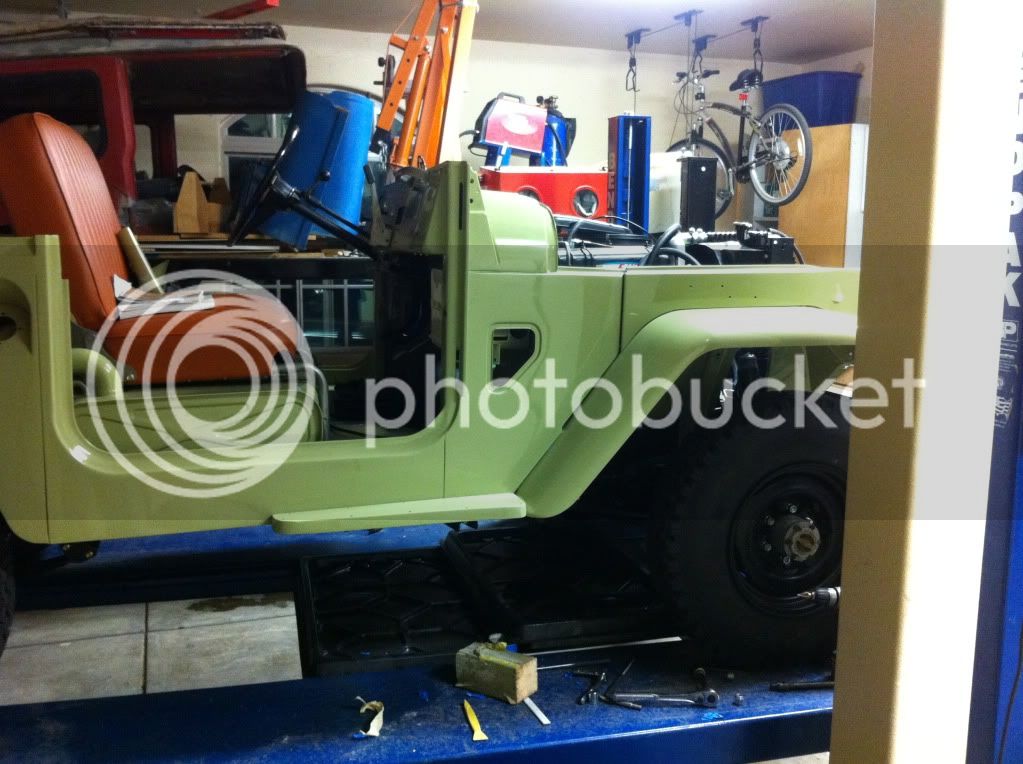

Got my fenders and painted the inner wells black. Stayed up late last night and got them mounted. Alignment is not perfect, I think I may need to shim the front of the cab to raise it up a bit so that the alignment is better unless anyone has a better idea. Take a look at my crappy cell phone photos in the wee hours.
See the transition from cab to fender in the first pic? I need to figure out how to fix that....
Chris
Chris - from the outside picture, it looks like the tub is on top of the running board horn. If this is the case, then it needs to come up. Also, if reusing the old body mounts, they compress and will drop height, but this a little bit bigger than that typically looks. If new (or reused for that matter) make sure you have one of the thick body mounts on the perch directly next to the running board and underneath the front floor. You will also want to get the bib and hood positioned before you lock down your fenders, aprons and tub. It takes some tuning to get right and it is really scary doing that with fresh paint. Recommend using that easy release 3M tape in between moving parts.

Thanks Genesis4x4,
I have a set of the new poly mounts from $OR. Will doublecheck my body mounts tonight and loosen everything up (and am using 3M blue tape) whilst I tweak.
Will let you know how it goes. If you want me to take a picture of something in particular to give you more info let me know.
Chris
The poly mounts work well. They tend to compress easily if over tightened. Also, if the mounts on your tub are a little squished, it will also drop your height. You will be amazed by the impact that a little change in height at the mount will do, downstream. The beauty of geometry. Dont be afraid of a little shimming, but you will want that bib and hood in place before you get that process underway.
I am most interested with that first mount on the tub. As you go. make sure to mind the places where there are connections bridging the body and the frame - transmission linkage, steering column, so on. These can be sensitive to tub jacking and the like.

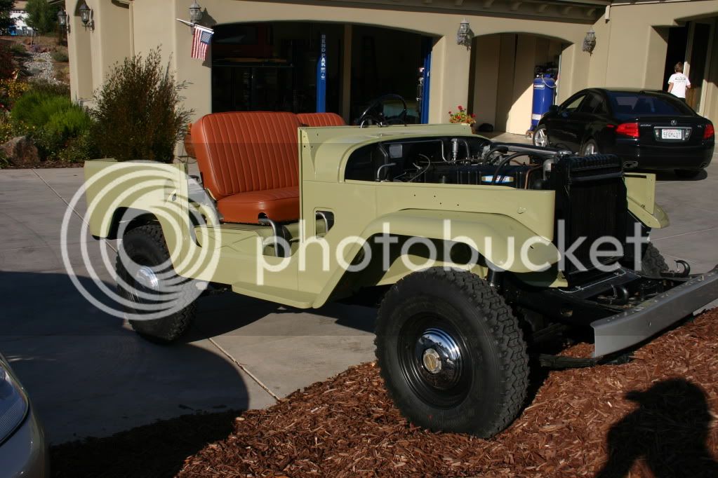

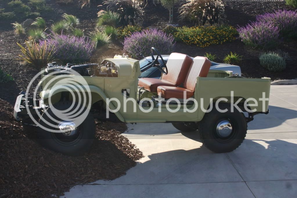

Alrighty,
Got my fenders on (without bib yet) and am pretty happy with the results. Not a 100 pt show car "gap" by any means, but lined up pretty well with room to move on the trail. Took some outside pics of the sulfur yellow with my better camera. Enjoy.
BTW, that pile of bark may need to be abused ;-)
First is shady side...
and sunny side...
