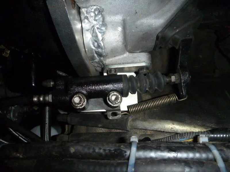

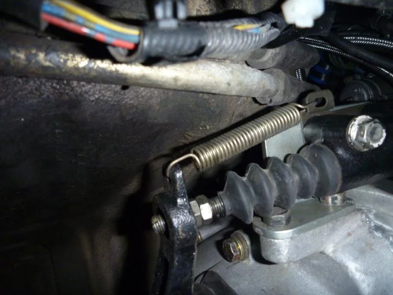

Here is slave mount bracket pictures.
Doug

thank you for the pic, my slave adapter is a little different but gives me more options to think about.

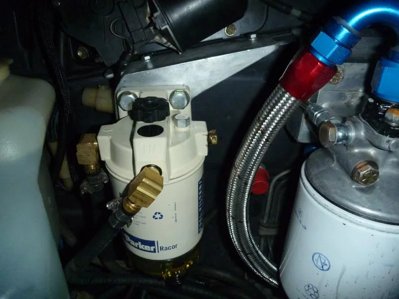

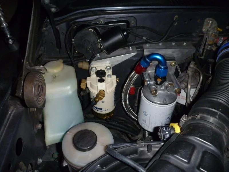

Finished up my fuel filter/water seperator system recently. I used a Racor R230 unit which flows 30 gph with diesel. It works great, has a primer, clear bottom and a drain. Replacement filter units are $12.00 US.
I used aluminum angle bolted to the fire wall stiffener. Nice and solid with good access.
I also have 2 Racor 500 diesel fuel/water filters if someone wants them. I will let them go cheap. PM for price.

that sounds good! If I can get at least 20 mpg. with my 35's and H55 I will be way ahead of my worn out Chevy 350 and 11 mpg. I like your Racor 230 with the integral primer. I have a Wix filter/water separator but it has no way to prime it when you change the filter and I think the way you went is the way to go. I am pulling the 350 tomorrow and then it is no turning back.
