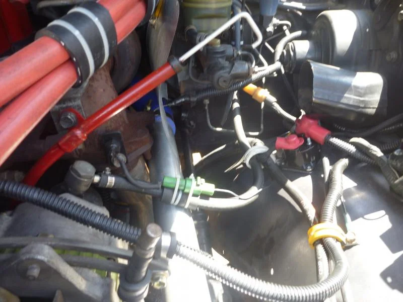

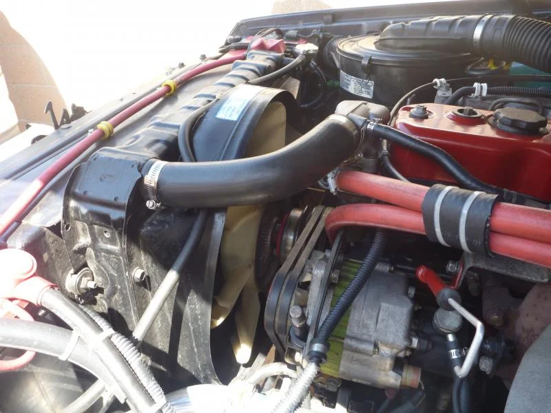

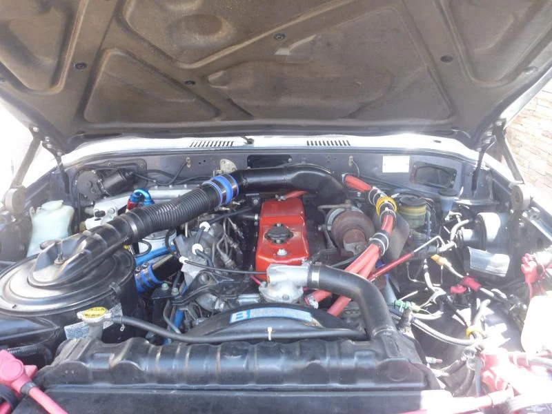

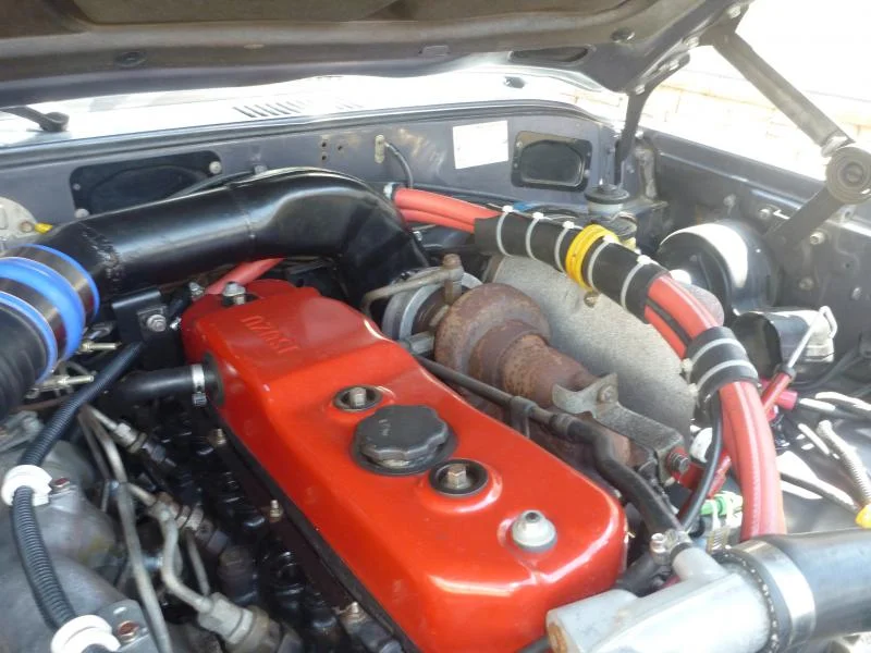

Here are a couple of pictures of how things look now. I have changed a couple of things and added a few;
1) Flex intake from canister air cleaner to engine - The original Hump hoses and hard pipe I used on the swap would/did not allow enough vibration isolation. I was worried it might damage the canister mounts.
2) Heat shield at brake booster - Not for heat but to make a support for the heater hoses and throttle cable. It also can't hurt the booster to shield it too. I kept the stock carb fan and used the thermo switch to blow air on the turbo area. Thought it could not hurt and I had the parts.

Couple more pictures.

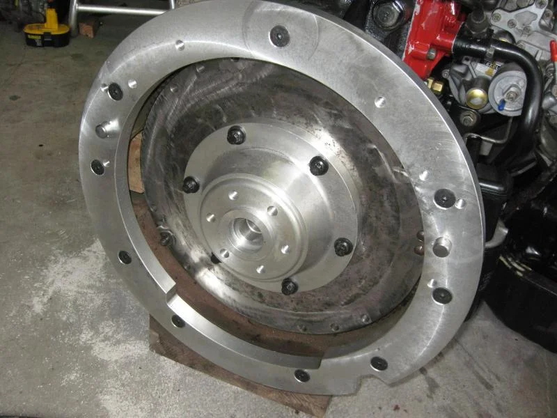

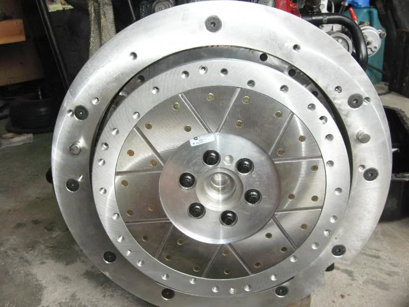

Clint, you inspired me to fix my clutch rattle!
Well I decided to take a weekend and find the clutch rattle problem once and for ALL!
Last night I pulled the engine, for me it's easier to do this than the trans/transfer case route and I had it out in 3 hours. Plus it easy to check all the clutch components this way. I also wanted to do a couple of other things too.
I FOUND THE NOISE! Bad pilot bearing! I'm not sure if it happened putting in the engine or not, but the bearing is bad big time. Part of the race is backed out of the bushing. I can barely spin it and it feels like crap when it moves.
It looks weird, almost like it was made wrong. The bushing bore is not aligned with the bearing? Could be just what happens over time and use? Who knows. It was a brand new Advance Adapters Chevota bearing when I started.
At least I know what the problem is and it's a cheap fix, but a pain in the arse!. But I am making a few minor mods while I'm in there. Adding a block heater, fixing a minor oil leak, and spill timing the IP pump with easy access.
