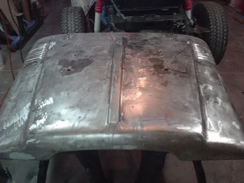

While stripping the hood I discovered that it appeared someone must have stood on it at one point. It was covered in over a quarter inch of bondo. I took the crossmembers out, straightened everything and painted inside with POR15. It is still pretty rough though.
Also worked on the fenders.

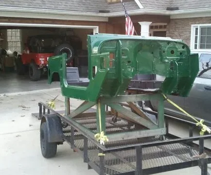

The wife thought it would be fun to mount it on Christmas so on Christmas Eve she made a couple phone calls and we had a few guys come over and tossed it on the chassis.
That brings us up to today.

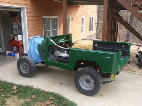

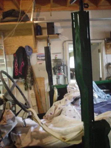

I got the steering in, well, pretty much in. I have a mini-truck box in there.
And am using the later turn signal switch.
Originally the truck was a soft top tailgated truck. I should have left it with a tail gate but saved myself $500 by scoring two sets of really rusty barn doors from a Mud member for the cost of shipping and making them into one solid set. They look good to me!

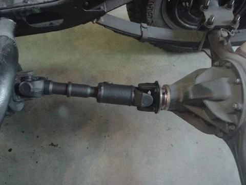

Here is a random pic of the drive train. Shortened rear DS to accommodate the H55.
The front is out of an FJ60 and was the right length.
Here you also see the 2.5" Superlift springs. I think I paid a couple bills for those and also the MAF U-Bolt flip kit and my stock steelies, powder coated gray. And no, those tires are not staying on there.

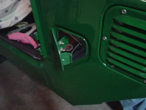

Also the kick vents...

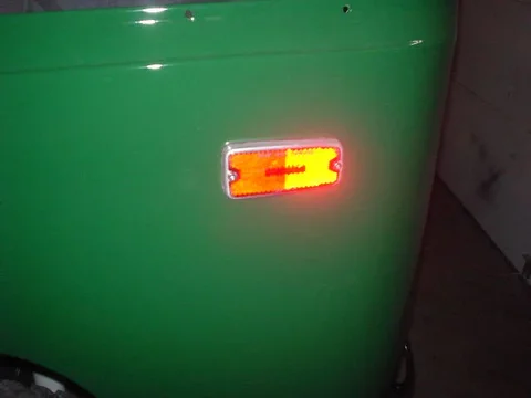

rear side markers...

I wanted to get the painted parts off the basement floor.:hillbilly: Vent doors and lights are all used Mud purchases from deep in the classifieds. As is the top and vent.

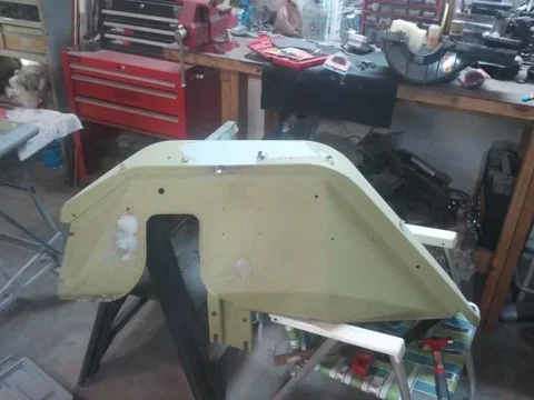

I have two hoods a later one and a split hood. Both are in rough shape. Here are a couple shots of the split hood.
I am going to try to get both straight and then prime them to see just how bad they really are. The primer will for sure tell me how bad my metal working skills are. The split hood was free from a Mud member and it looked like someone was using it as a baseball back stop. The other one I paid $100 for and it had about a quarter inch of filler in it I did not detect. Apparently someone was doing some hood surfing on that one. I was able to get the big dents out of it significantly reducing the amount of filler I need.
