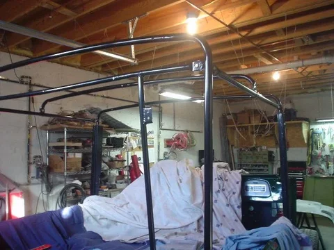

I found the spacer tubes that prevent the windshield from going back to far but I am not sure I ever had the brackets that go in either corner on the inside with the nut plates on them. :hhmm:
Here is a question for Paki Top fans. Is this right? Do I have the horizontal bars on the wrong side? I read in another thread that the middle cross bar goes on the outside but there are tanks on the horizontal bat that seem to be there to assure the middle bow does not twist. I would think if those tabs point out they could tear the top.
Outside passenger.
Inside passenger.
Looks correct to me. I was looking at my bows(original not replica) and mine look just like yours unless I'm not looking correctly.
So I definitely might be partly right?
I think it is Biscuit who posted they should be on the outside.
But from some searching I found this one:
(from joemck7)
Thanks for chiming in. I think it will stay like it is.
I would try switching the horizontal bow so they are smooth on the outside. I would think it would it be look better and one less place to rub. But that is just a guess. All my OEM bows are totally different. The center bow fit flush with the horizontal bows and there is horizontal flange on the inside. Some of my sets have the nuts welded others have the bolt welded.
I see what you mean. I am afraid that the tab bent in on what is currently the inside may do more damage if it were pointed out.
