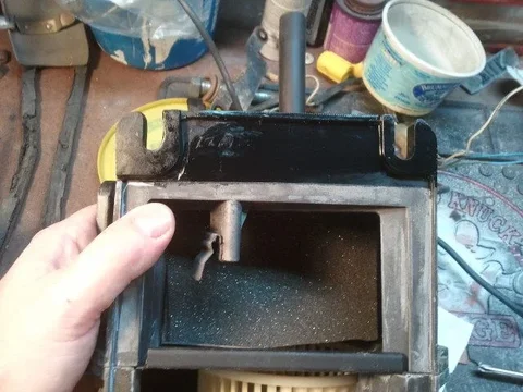

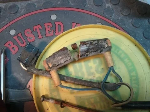

In other news - and I should have taken pics of this but I did not - I had purchased a heater blower from a Mud member. It was a later model plastic one. The metal one I had was really rusty on the inside (I have kept it to see if I can make it into another little project). The plastic on had one of the bottom mounting ears broken off.
I was able to use POR-15 putty to make a new one. First I disassembled and cleaned the whole mess and then drilled a couple holes in the bakelite just big enough to insert a short piece of coat hanger that I bent into a sort of rib. Then I caked the putty on. Once dry, I used a highspeed angle die grinder and a Dremel to properly shape the ear to accept the 8mm bolt and look like the other non-broken one. I then painted the area with some black plastic spray paint. Although if you examined it you could for sure tell there was a repair compared to the other side but the putty shapes well and is very strong. Plus, the repair is not really visible given the location.
This is what I used:
I have used it to repair other bakelite items in the past and it is really great for that. The shelf life is excellent. I think it have had it since I rebuilt my M416 so a few years and it is still perfectly pliable. :cheers:
