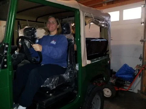

Bleeding my own brakes :D
She did exactly what she was told! She is good at the pumping. :D
I had forgotten to adjust the mechanical adusters on the rears and could not figure out why the brakes were so spongy :doh:

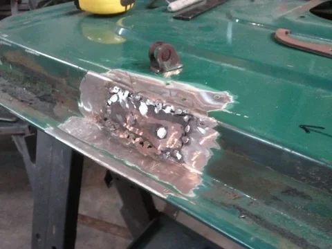

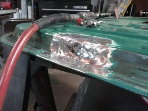

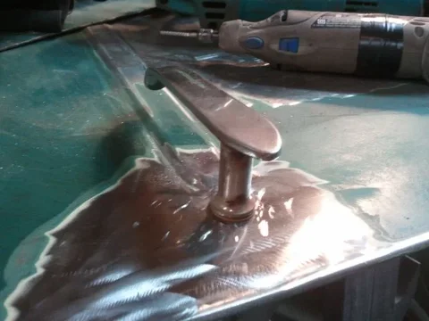

The part around the lock was much easier to fix than I thought it would be. Since it is a soft top I am not going to bother putting a door lock on there.
That other spot is oil canned like a bitch and I am not having success in defeating that.
