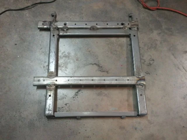

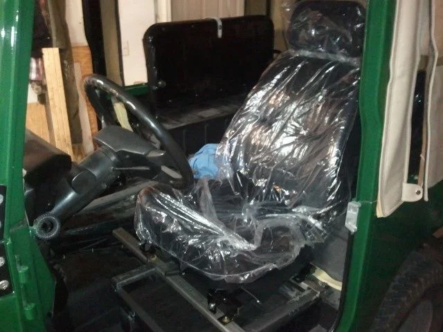

So I have been on travel or doing other s*** with the wife on the weekends and now I findelf working 12 hour days. WTF right?
But the wife is out of town so when I got home tonight I spent a couple hours on the driver's seat.
I modded the original flip up mount since I am keeping the tool box (because I think it is neat).
And I mocked the seat in place about 5 times before welding the pieces in.
These are the Scat seats and the scat mounts for the driver's side of a 40. I could have probably made the mounts or something that would have worked but for $100 per mount they will take only a small amount of modification if any to work in my application which probably saved me time and money in the long run.
Yep the seats, mounts and all probably hit $1000 but when I figured in the cost of trial and error with other stuff and other fab work and then getting the seats recovered to match.... well, the recovering would have run me about $600 so I said screw it. The seats are comfy and operate nicely and for this truck, putting some other sweat stained mismatched seats in just did not seem like a good option after screwing around with those Ford seats I got from the junk yard.
I have to clean up the mount a bit, drill four holes in it for big mounting bolts and paint the mount and then get some lap belts. The passenger side mount I got from Summit will not work so I sent it back to exchange it for another driver's side. I tested the one I have and found it will work great.
