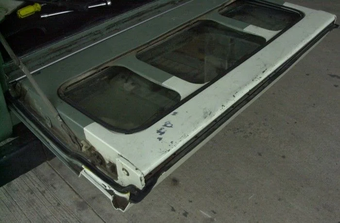

Does anybody have good pictures of the upper tailgate weatherstrip installed , that Slo Cruiser sells ?
Lou
What EXACTLY do you need to see? I can take a picture of mine.
Correct me if I'm wrong, but this is installed on the tailgate and I have not seen it installed and how it fits with the tailgate open and when it's closed. It's never been posted here in detail and I'm considering ordering one from SloCruisers. Does it close the small gap between the upper weatherstrip that the tailgate glass slides into when the tailqate is closed
Lou
Take a look at post #14 in my POTM thread https://forum.ih8mud.com/fj55-iron-...972-september-potm-cruiser-guy-guatemala.html and you can see my install of the piece I think you're talking about. If you need more detail just let me know.
I'll link to them:
attachment.php
attachment.php

Any idea on where I can get the channel that the window rolls down into inside the tailgate? Thanks! :beer:
channels that the glass slides in? (thats what it sounds like but just in case) vs channel that holds the window glass at the base?
John, I thought so as well. I recall someone just using felt and adhesive. I have not reviewed it here yet. BTW John...I tried to email you the other night but your box was full.
Eric, the piece in question is the two side channel felt/rubber pieces the window slides in.
I could swear I saw a post in here about them but now I can't find em:bang: I need to get something in there for mine also:rolleyes:
Around post 342 and variously thru bout 367 on this thread.
Can anyone verify the following: I lowerd my TG and ran the window in and out with the inspection plate off and looking down the drvr edge into the barrel (so as to speak) of the inner side channels. what I observed was that the glass never contacted the sides of the felt as it moved. It seemed to be held static relative to the side channels by the regulator channel that holds the glass?
This makes sense as I never heard glass scratching on metal when I was raisiing and lowering the window on my 7/70 which had no felt in the side channels at all.
:hhmm:Eric, don't think mine makes contact either.........seems to be held in place by the regulator channel rubber......HTH
Lou
Hey Lou, good to see you back here. I watched it pretty carefully. I am thinking a combination of FJ40 lower door window felt and maybe edge gaurd might do well for the rear side channels. It is 11/16 wide but not 7/8 (1/2) I think. The old window felt in my 7/70 is closer and might work as well.
I'd like to see what the door felt from an early 40 door with wing windows looks like how it measures out.
