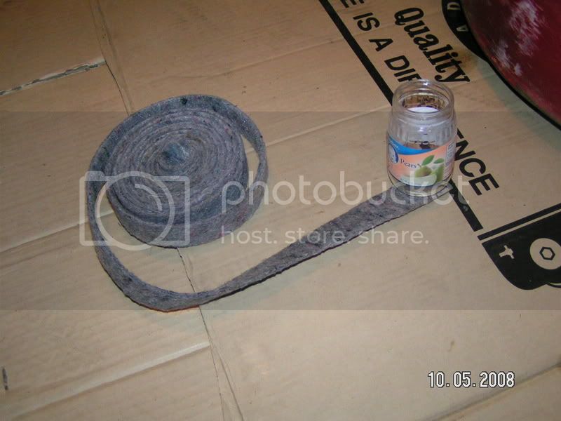

IIRC, the window channel on the rear windows is deeper than the doors. This was one of the parts I could not order out of a catalog, but had to "wing it" with stuff from the hardware store. I meant to do an update on this thread when I finished, but apparently, in my rush to finish, I neglected to.
Maybe read my thread on the rebuild. post #147 talks about the rear window tracks. Vague, but it is all I posted on the issue.
https://forum.ih8mud.com/fj55-iron-pig-preservation-society/118502-fj55-deconstruction-5.html
I know I used spray glue, and some flat felt about an inch or so wide and maybe 1/8th of an inch thick, folded it into the channel, and trimmed off the excess. I wish I remembered where I found the felt stock.
I wish I remembered. Could have been Home Depot, Could have been Ace Hardware, could have been JC Whitney.
I'm sure Ace could have it, but I saw that & tons more different sizes & colors at Home Depot. They had 2 rows about 20 ft. long of misc. styles. Most of what they had is self sticking rolls of generic rubber w/s.

Woops didn't see the earlier offer from Wallace. How well does the felt hold up if it gets wet?
:hhmm:personally am a bit leery of felt because of its ability to hold moisture..............:eek:that is all we need in our piggies innards; moisture against high carbon steel in those unobtainable tracks;
