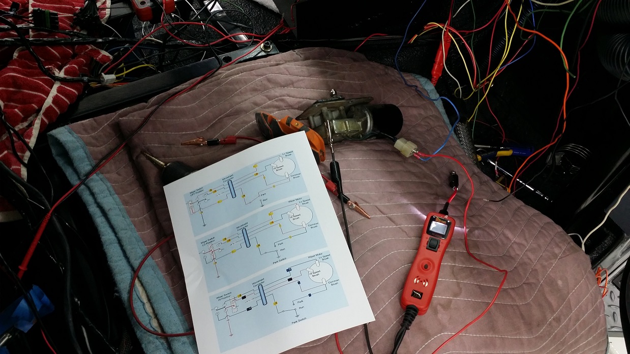

Were you guys able to get the high, low, and park working with the original wiper motor and aftermarket switch? I did, but it took a LOT of brainpower, a few hours, a couple beers, 2 relays, a Coolerman wiring diagram, and my trusty Power Probe!
Good question, Yes it was a challenge. With some creative wiring and a few extra pieces we were able to make it work.
