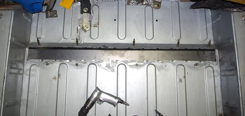

What about the channel in the rear floor? Is that finished already? That looked like a mess! :eek:
Working that today, just picked up the metal. Going to be a bit of a trick with the tub on the rig?

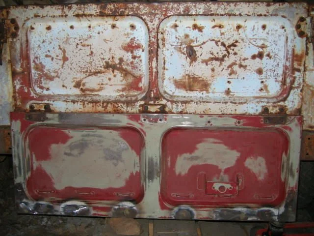

Part of the 99 hole fillup program!:hillbilly: This tailgate has had a hard life, most of the dents came out, but is slightly twisted, will solve that when it's on the rig. Does not have rust, but like the rest of the rig, will have some "texture" so, will match perfectly!
What is the history on the tailgate? Just trying to date the design change. The tailgate on the top is from a 1960 FJ25, have a 62 tailgate which still has footman loop bolted not welded on. Bottom tailgate is from a 71.
I bought the tailgate at the CSC meet from a really nice guy who isn't on MUD - I didn't ask for the year - he had gotten it with a pile of parts when he got his 40 and decided he didn't need it

if I were there in person, I would just about now drop an underhanded remark about the somewhat arbitrary appearing placement of the future spot welds :p - but since I am 1500 miles away, I won't :hillbilly:
not that it really matters, there'll be carpet over it :flamingo:
if I were there in person, I would just about now drop an underhanded remark about the somewhat arbitrary appearing placement of the future spot welds ;p - but since I am 1500 miles away, I won't :hillbilly:
Those are not spot weld holes, they are Cleco clamps, placed were needed to pull the parts together/maintain alignment. There will be a constellation of spot weld holes and the Cleco holes will be plug welded shut, likely the last things to be welded on that part of the project.

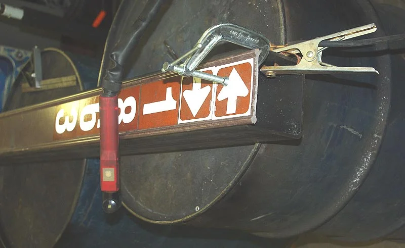

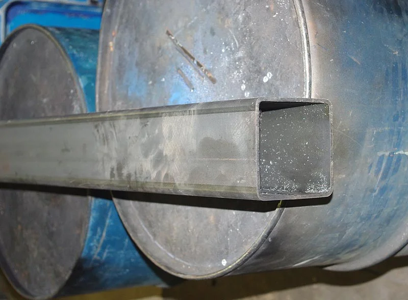

While they were playing with the body, I went to work on this 4x4" tube. Clamped on a non-conductive straight edge and went to town with the plasma.
There was a pair of new HD rockers in there!:hillbilly:
A bit more chopping to the front ends of them and they fit on the rig.
I am so stealing that one build two That is going to look awesome when your done. I freaken love this post mostly because I am on Deck. I am curious to know what the back edge will look like. Are you going to angle it to match the small patch piece. Last question with the back side will you weld a back plate on it so it appears to be capped off?
