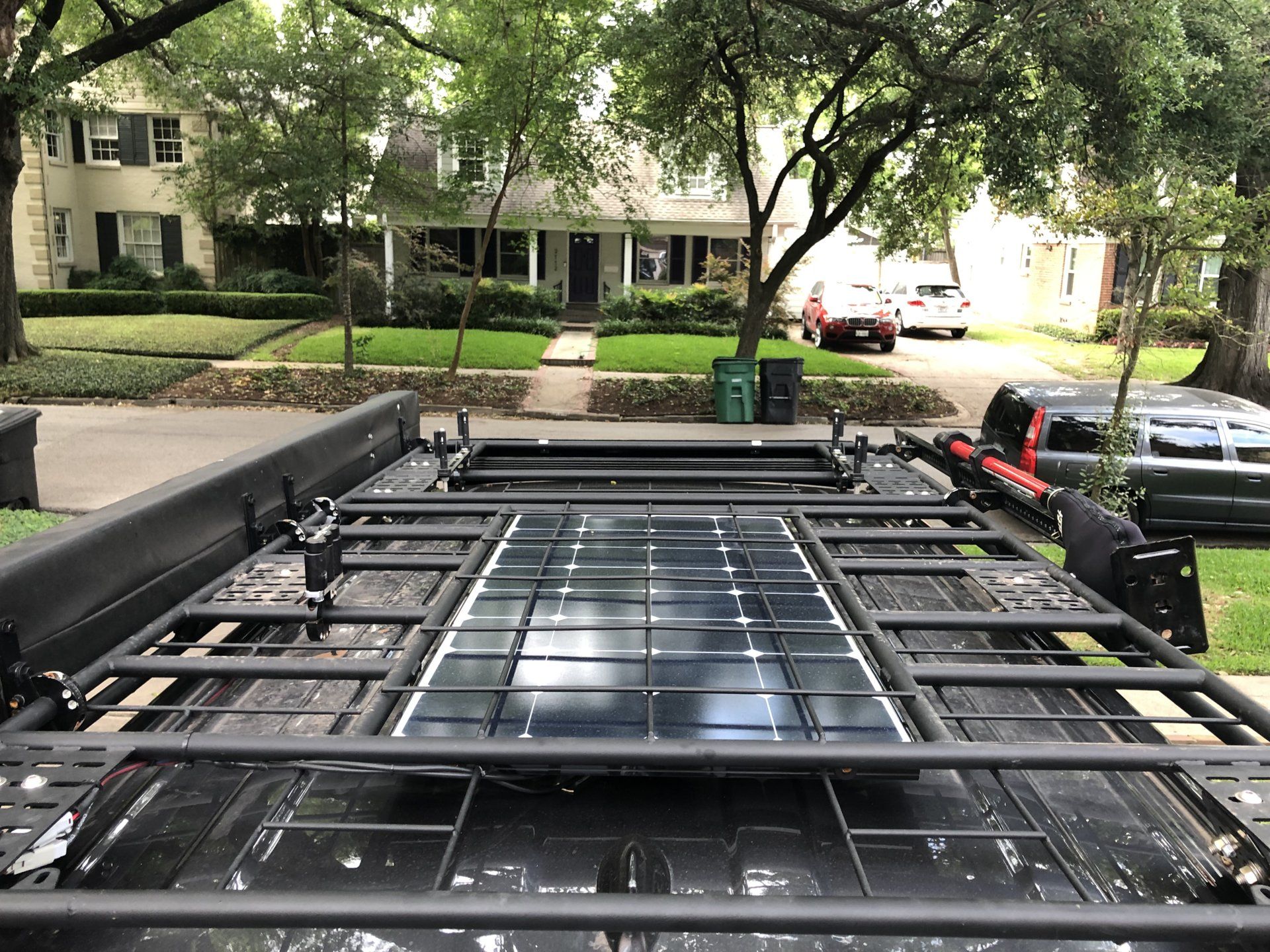

I knew I wanted to run a solar panel on the roof, but it needed to be stealthy and protected against gear being thrown up top, and keeping the rack as low-profile as possible was important so I can still get into taller garages.

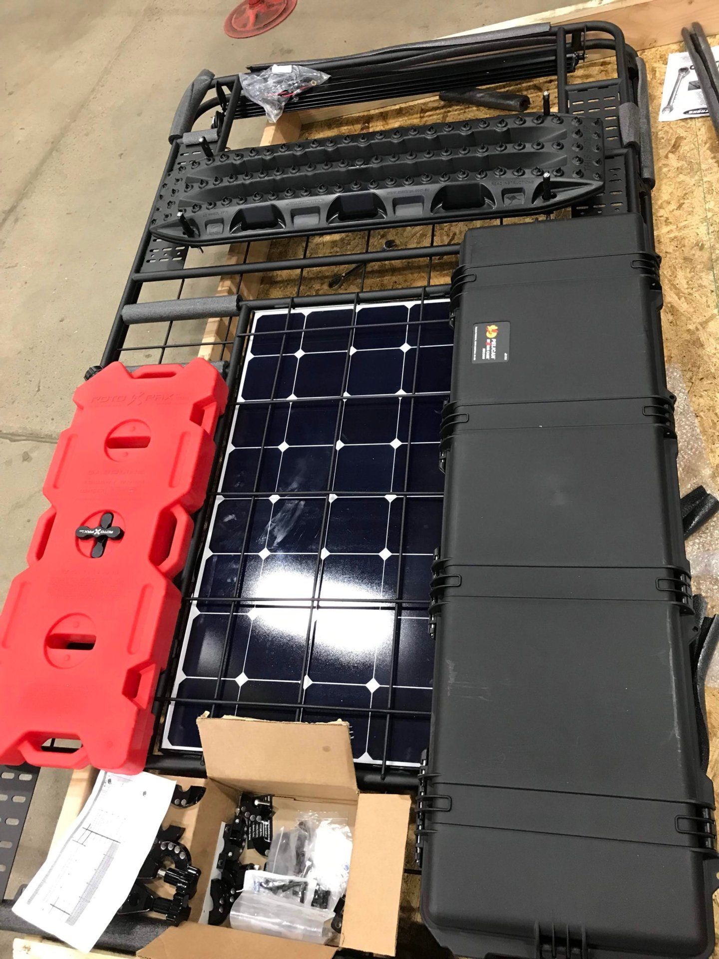

Huge thanks to Tim at Gamiviti, who worked with me to customize one of his Expo racks to my specs. Essentially, we created a secondary reinforced opening similar to the sunroof cutout. The panel is mounted to vertical tabs that line the rim of the cutout. The grid that runs along the bottom of the rack switches to the top of the rack over the solar panel for protection.
I decided to go with the Renogy Eclipse 100 watt monocrystalline panel. The size allows me to mount a rotopax on one side and a low-profile pelican case on the other for waterproof roof storage. A pair of maxtrax are mounted forward of the panel but still allow full use of the sunroof. All are low enough that they don’t interfere with the panel that much. Initial testing shows the Renogy Eclipse still pulls in a surprising amount of juice even in partial shade or overcast weather. Since returning to civilization, I’ve removed the rotopax, maxtrax and pelican case for optimal (fixed) panel performance.
Tim did an awesome job. The panel fits the cutout like a glove and it is completely hidden unless you physically climb up on the rear bumper. The panel doesn’t protrude under the rack at all, which allows me to run the rack very low to the roof.
Tim also customized the front opening to fit the 40” Rigid light bar.

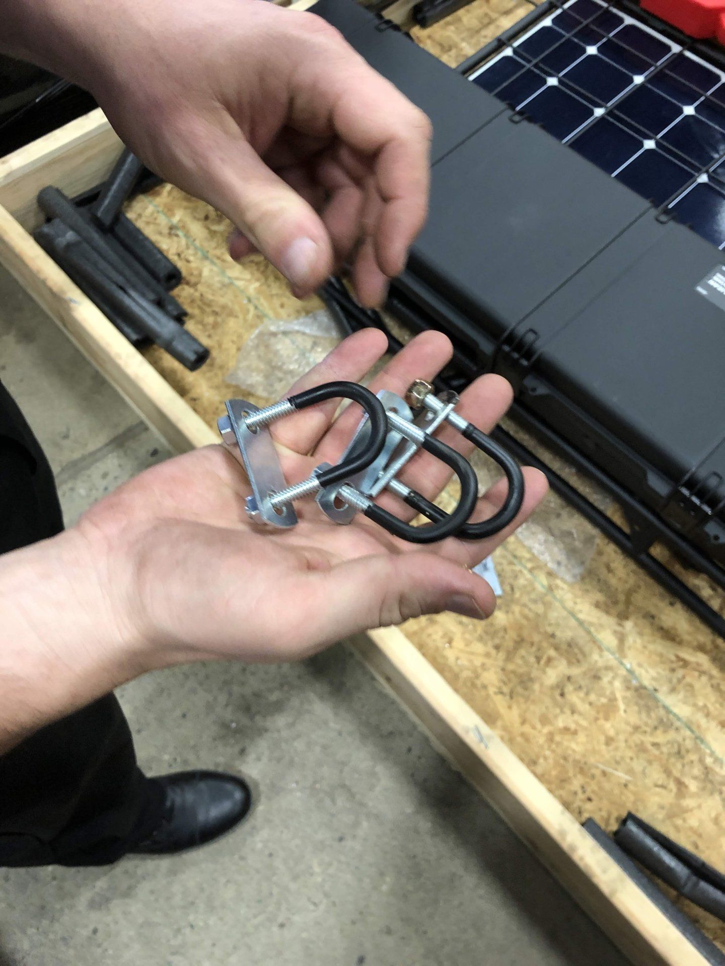

Rotopax, maxtrax, hi-lift, and awning are mounted with four-treks aluminum mounts. The Pelican case is mounted with PVC-coated U-bolts that pierce the bottom of the case through IP-rated grommets.

Wow. Extremely similar to my hope to do solar on a rack, without ipreventing occasional kayaks, etc.
Nice a low. I have imagines a larger pnel, or perhaps 2 or 3 smalls like that, but I am interested in this for sure.
Any details on the panel itself, manager etc. would have me all ears. :cheers:

Here’s a shot of the panel mounting without the accessories.
