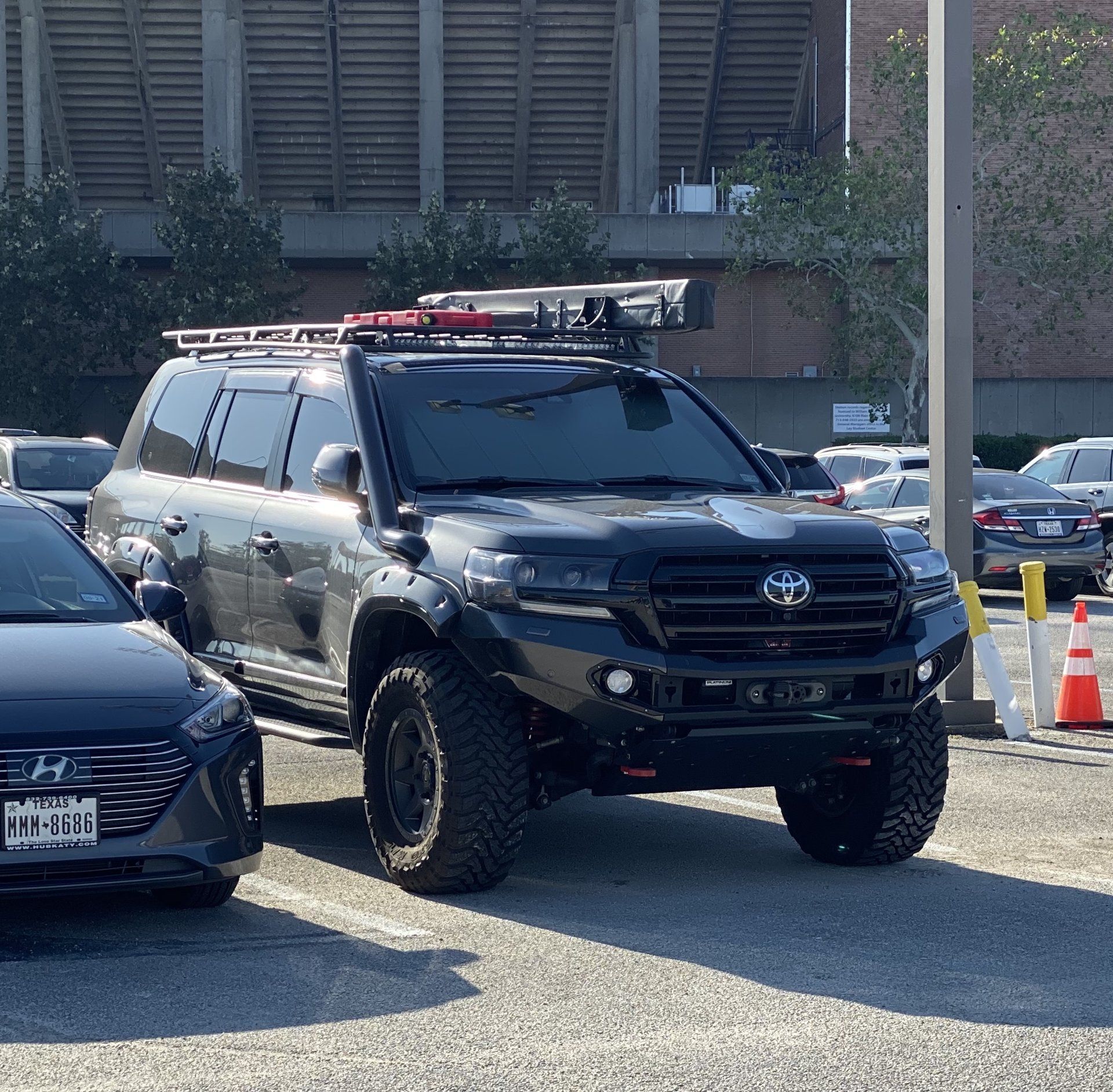

Haven't been able to update this in a while, but I wanted to share some progress we made on the build over the summer.
Trekboxx, Rhino bumper, and Warn Zeon 12k were installed. Rewiring all of the electrical was no simple feat, but the result is super clean and I couldn't be happier. I also switched the rear springs to 2723s and it's a big improvement. Still need to do a post on the whole electrical system (LiFe battery/Inverter/Manager30/Solar etc.). Soon!
Who did you have install the Rhino bumper!?
The Rigid reverse lights in the custom housing look great. I asked a shop here in Arizona about doing that and they thought they would need to 3D print a housing to replace the reflector. Is that what you did? Also, are those wired into the normal reverse light, or did you put in a separate switch?
We made the reverse light by hand. It's the OEM reflector Dremel'd out and filled-in to fit the Rigid D-Series Pro Midnight Edition diffused light. We are working with a local company to make and sell these. Anyone interested can sign up for updates here. Probably 3-4 weeks from first run.
Thanks! As Eric said, it was a custom housing but it sounds like they'll be offering them for sale soon, which is awesome.
I chose not to have them wired as reverse lights because they are extremely bright, even at their lowest setting. I run them (along with several other lights) through a switch pro controller in the sunglasses holder. And it's nice to be able to turn on/off and dim all the exterior lights from the bluetooth app on my phone.

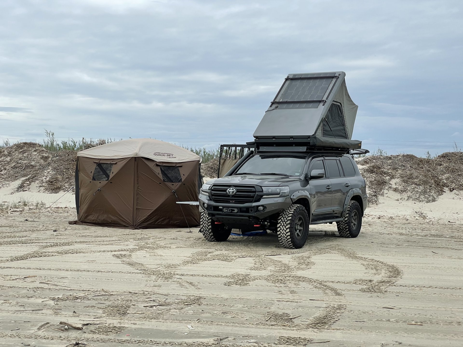

Love the setup, I can't wait to eventually get Kings on ours. So now that it's been a year, how do you like that tent? Been wanting to get a wedge. We have two FSR tents which have been great, but want something with faster setup.
