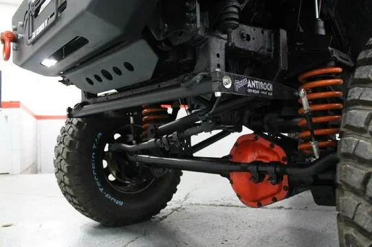

FYI to the future owner, front diff is not a D60 as stated :rolleyes:
Seller does NOT know if it has lockers in both, or only one, axle. He also does not know what gear ratio is in the diffs to pull those 37"s under that nice high wind sucking profile. John
It looks like a 60 to me. If it's not what is it (not mocking, I don't know much about axle identification)?
First picture is the front pumpkin from the FJ ad
Hmmm may be I'm under the false notion that a D60 has more cover bolts than a D44. I figured the one in the rear must be because of all the bolts. After further investigation I would say its a GM 14 bolt in back (3/4 ton). And hard to say in front. In any case they don't match.
