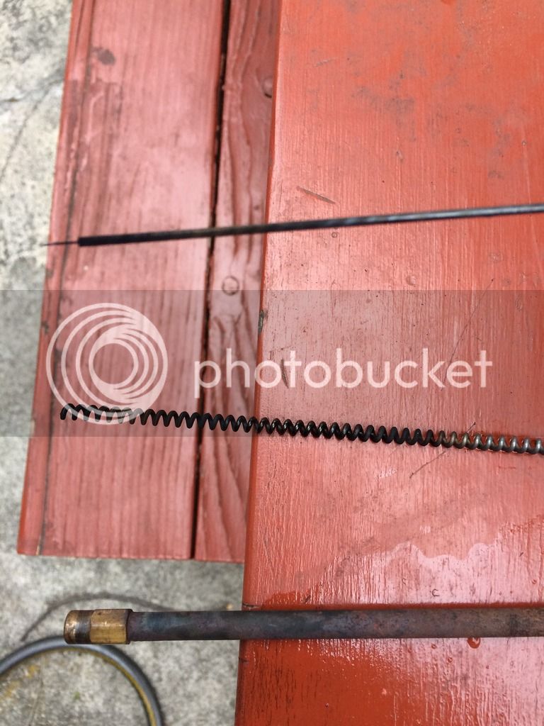

I just pulled out the orifice, spring and some type of needle. I hit them all with some carb cleaner.

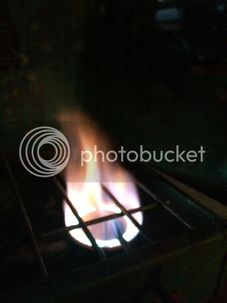

According to my iPhone we have a 19mph wind. That can't be helping. I took it inside and lit it. It finally started and stayed running. It had a good blue flame that got bigger and smaller as I turned it up and down. I lit the left burner and independently adjusted it with the side key. I let it run for 5 minutes indoors. I turned it off and took it back outside. I am going to let it cool and fire it up again when it gets dark and y'all can evaluate the flame. Generally do you need to keep pumping it after the initial 40-50 pumps?

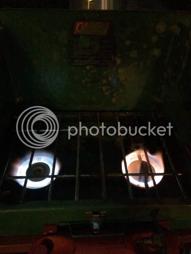

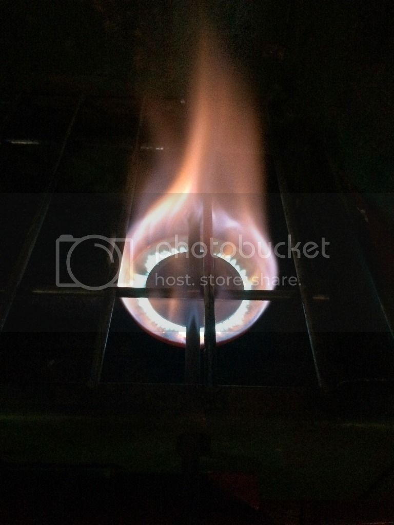

My $5 Coleman is now humming along. I have started and stopped it 3 different times. I let it cool down completely 2 times and it started right back up. I did pump a few times after turning the trim switch down. I let it run for 5-10 minutes each time and it purred right along. There are wind gusts of over 20 mph currently and I was able to light it up. Do these flames look OK? This is the right burner on full blast.
And this is both of the burners on full blast at the same time.
I did the same to mine today and it made a big difference. Much more flame. I soaked my parts in lacquer thinner, took some steel wool to the rod, wire brushed the tube and spring, stuck a small wire in the orifice until I could see a nice round hole thru the pipe. I found this site helpful:

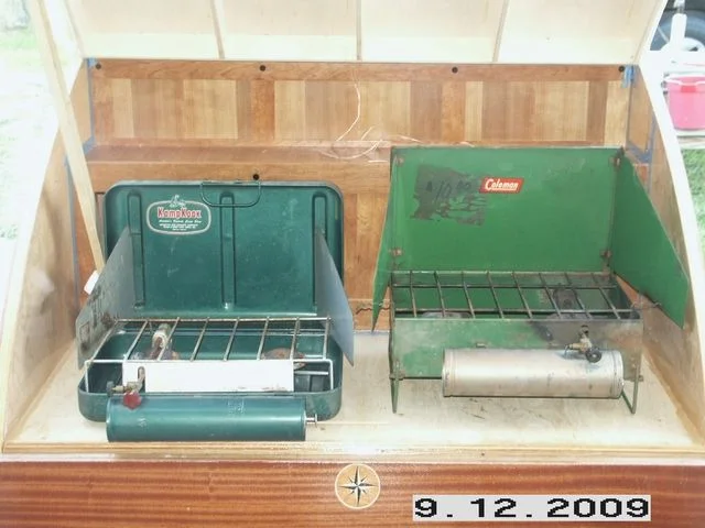

Been wanting to add a two burner to my camping setup for a while. Still want to get my grubby fingers on a centennial 502a but they are pricey buggers. I posted some photos of some of my other Colemans earlier but my favorite lantern of all is this jewel I picked up about a year ago. The case is nearly as cool as the lantern itself. Just waiting on day I have a remote cabin up in The Rockies so I can hang it up next to my nickel plated coach gun
