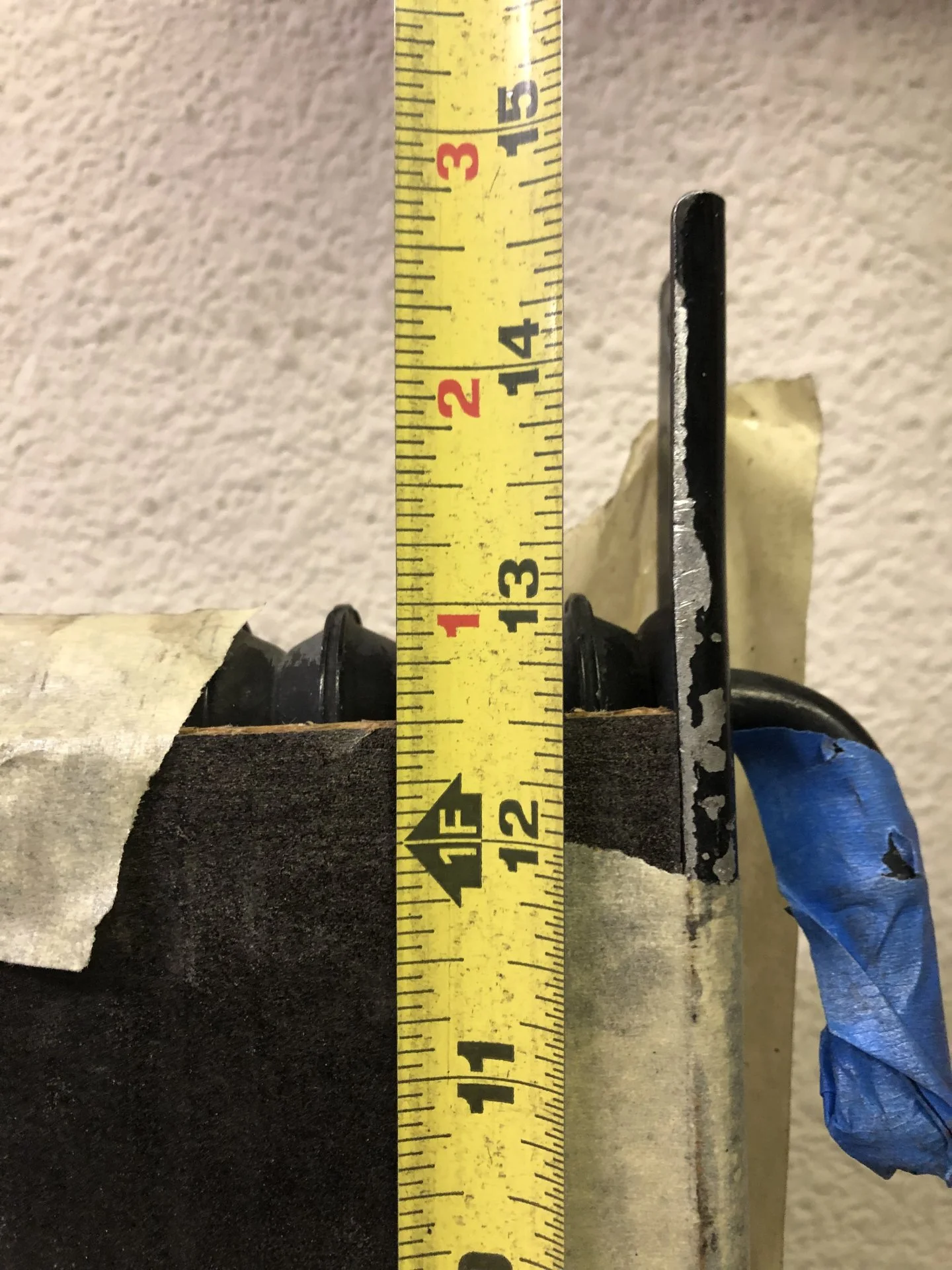

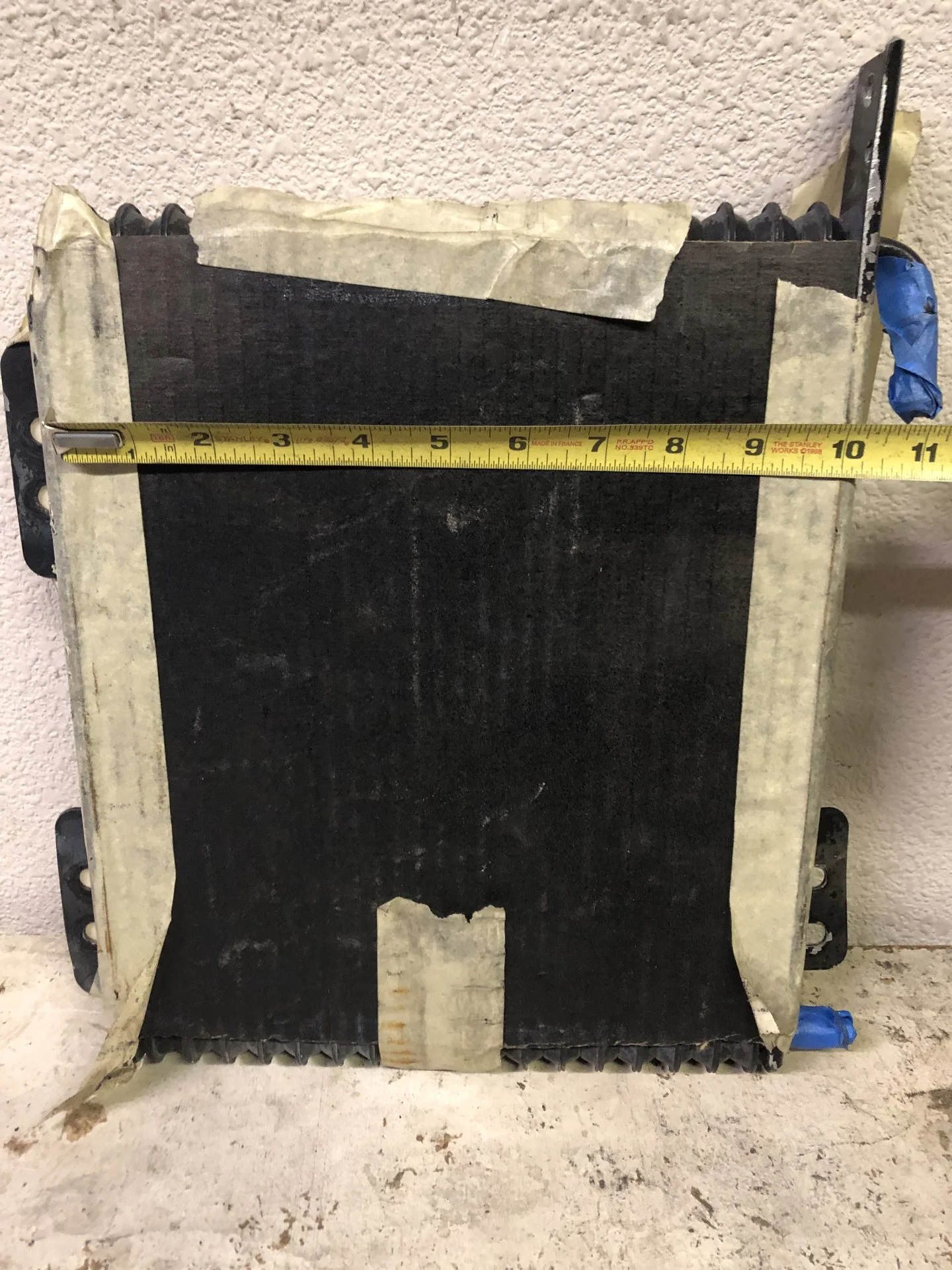

The orl cooler is a 10x13 plate and fin unit and does the job well along with the coolant to oil cooler.
Then my 9*23 will work just fine.
And I'll follow Rodney at WAT and bypass the radiator anyways.

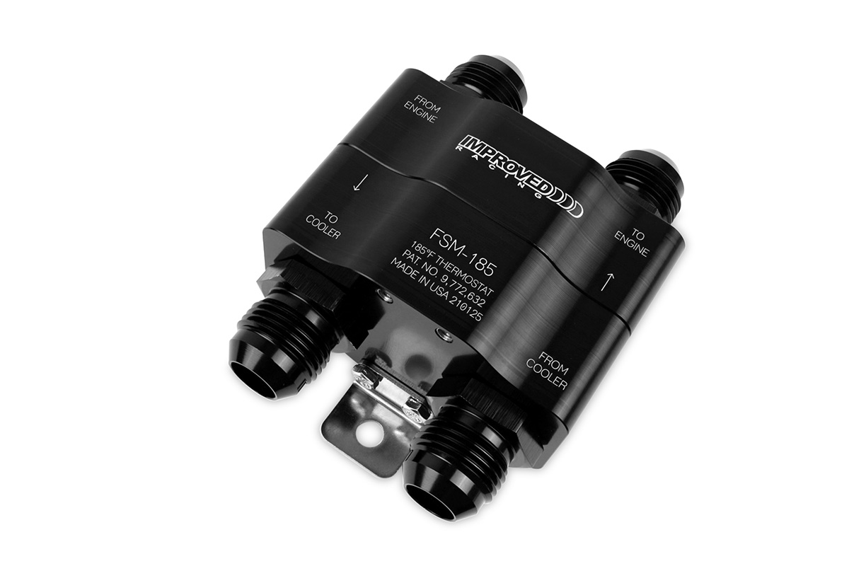

Yours is 159% of the oem cooler size. With out using the radiator and having no thermostat in the cooling system you may be forced to block a portion of that cooler during winter n order for trans fluid to rise up to optimal temp. Looking forward to reading about this set up and how it works.
Cooler only, no brackets.
Rodney stated that for areas that rarely see below freezing bypassing the radiator on these older diesels was the way to go. So I'll trust him.
I'm not spending 240 on the off chance it's cold. I can just run my trans unlocked and I promise it'll warm right up.
If and that's a big if I have issues I can simply fab a few new lines and viola.

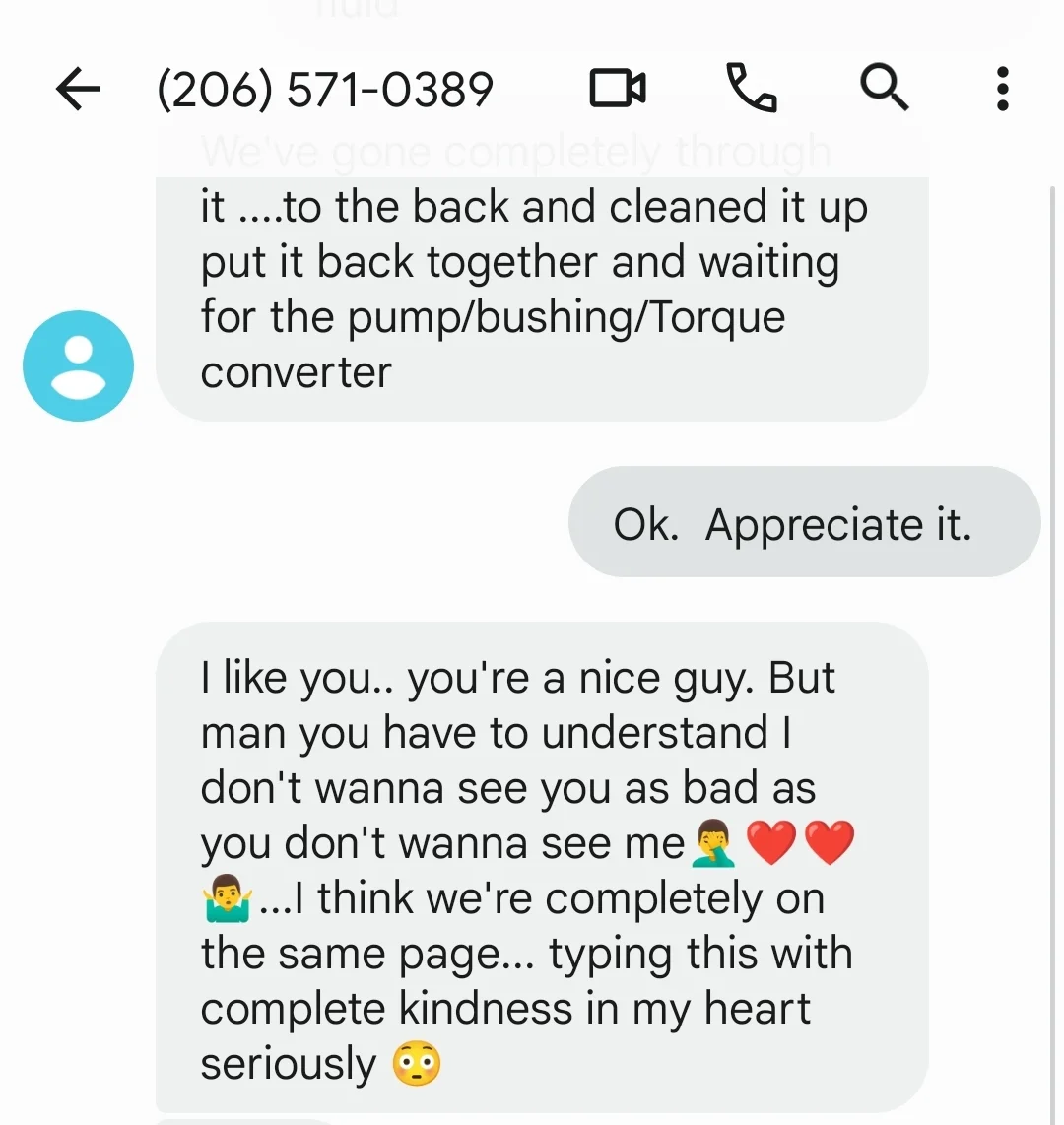

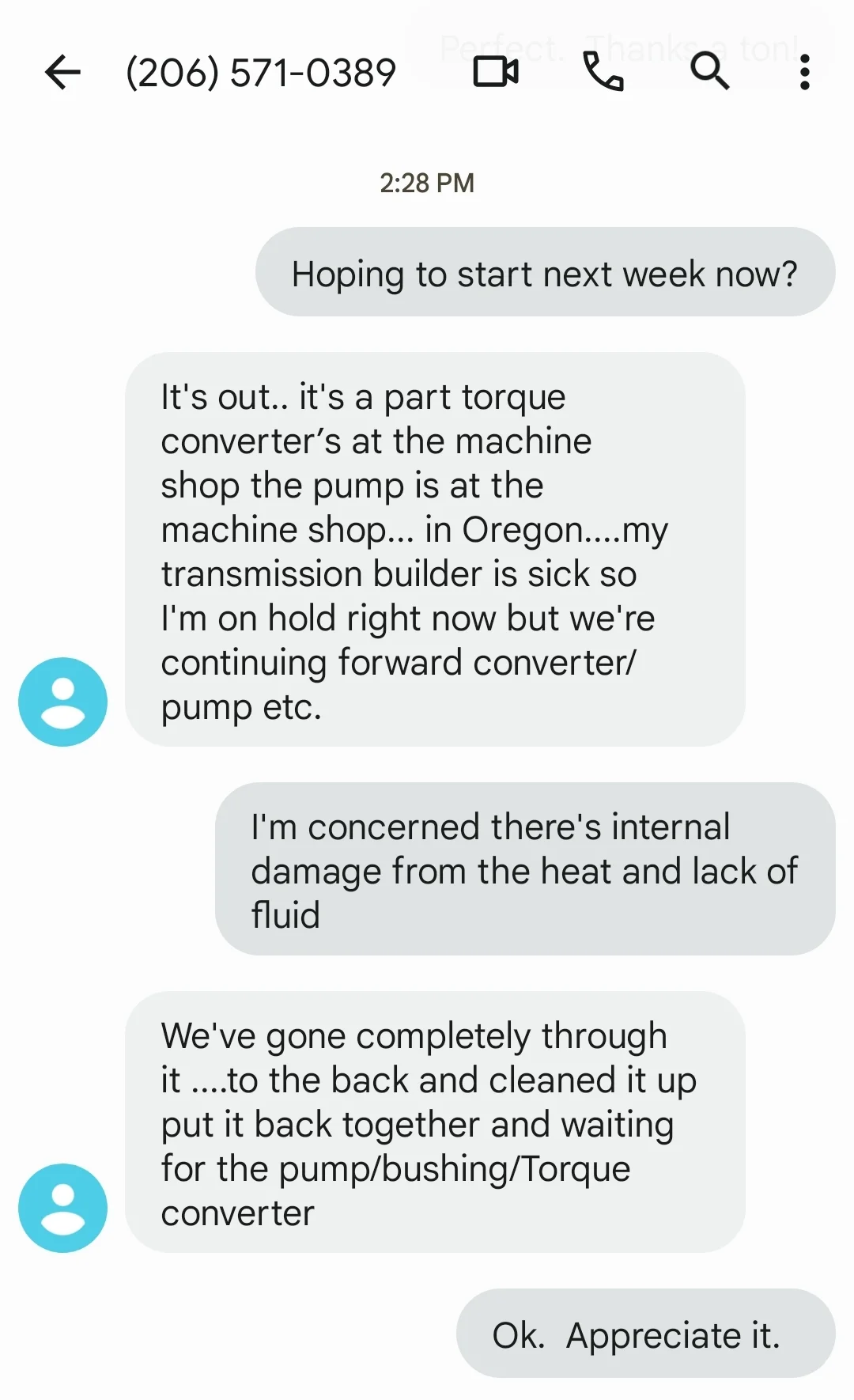

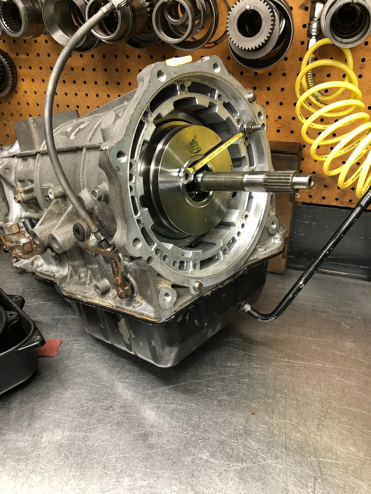

Texted the shop today. Last Friday they told me they planned to start this week and would update me. I hadn't heard anything so I sent a simple "planning on next week now?"
This is the reply and images. Progression.
Good honest shop and a stand up guy. you know he loss his ass on this one. 🤷‍♂️
For sure. There's no money in this.
The t5 in my 68 needs rebuilt and I told him as a show of good faith when I pull it out this summer I'm going to bring it down to let them rebuild it for me
