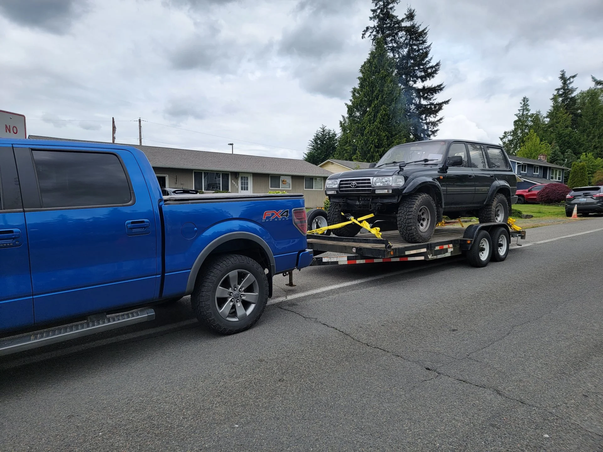

Swapped out the sketchy U-Haul, which was my only option on a holiday weekend, for a real trailer.
Someone on here recently posted acquiring the trailer the po of their rig used to haul it. It was a single axle landscape/utility trailer. I was going to chime in with something regarding the inappropriateness of said trailer, but I left it alone. IMO any uhaul item I've had my hands on has been way over built, but ridden very hard and somewhat sketchy looking. That flatbed you have in the latest picture looks proper.

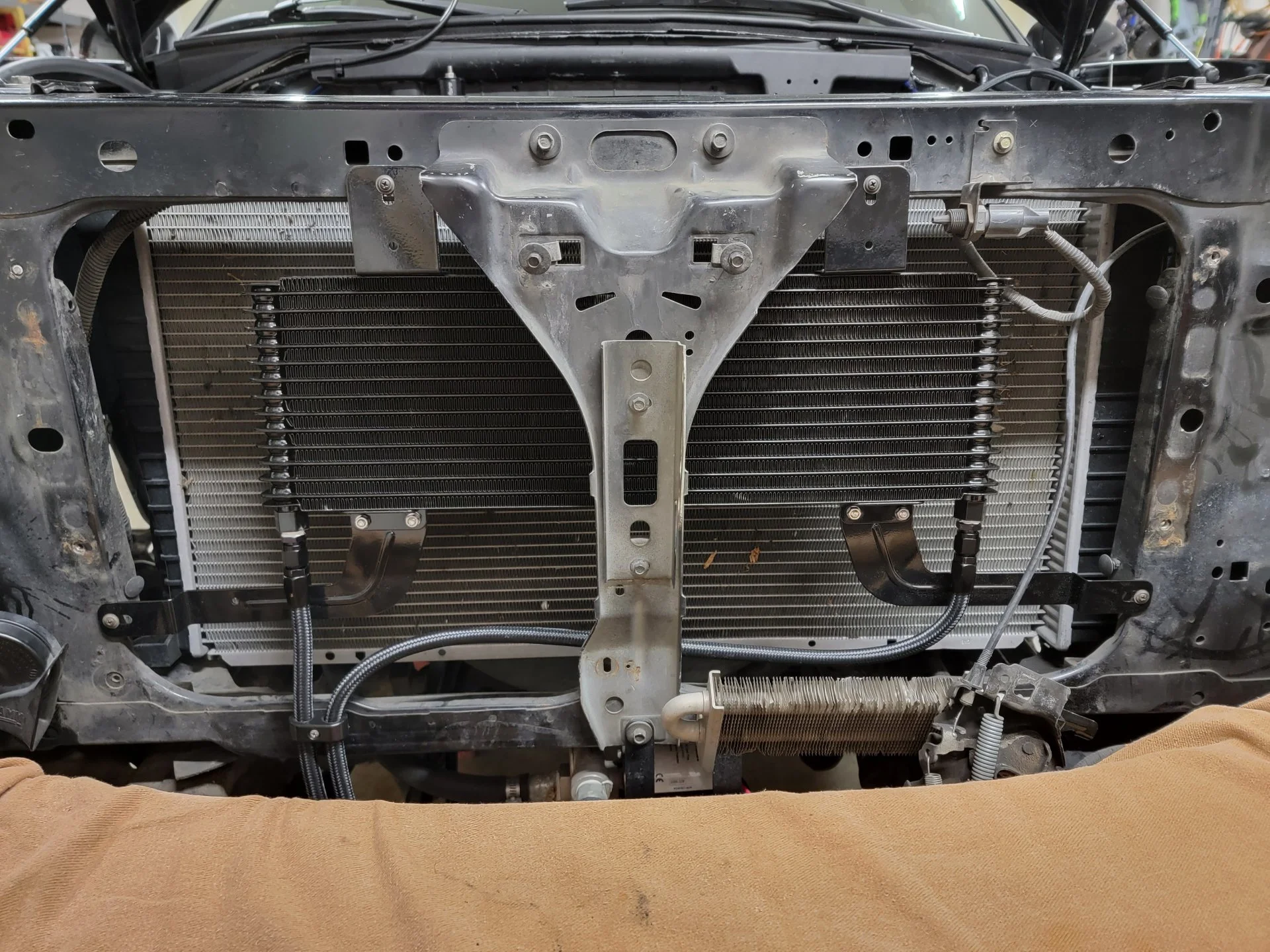

It has a shady trans cooler on it that needs to go.
So today I ordered a tru-cool trans cooler. Isspro 100-280 trans temp gauge.
Some -6 braided line and a pile of fittings to run everything as an instead of rubber hose and barbs.
Following Rodney at WAT's recommendations I am going to bypass the radiator. It's rarely below freezing here.

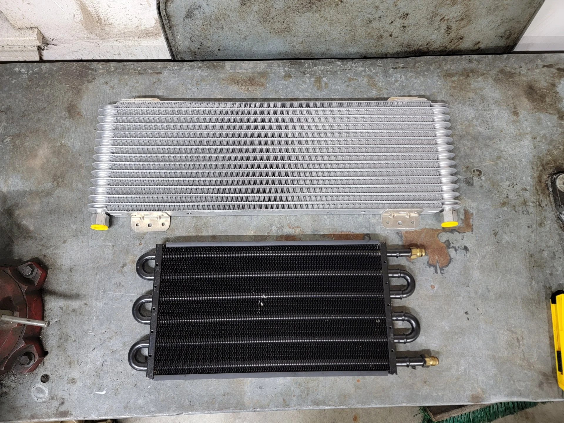

The trans cooler:
It's fairly common on the forum. It has good reviews and is over kill. Which is perfect.

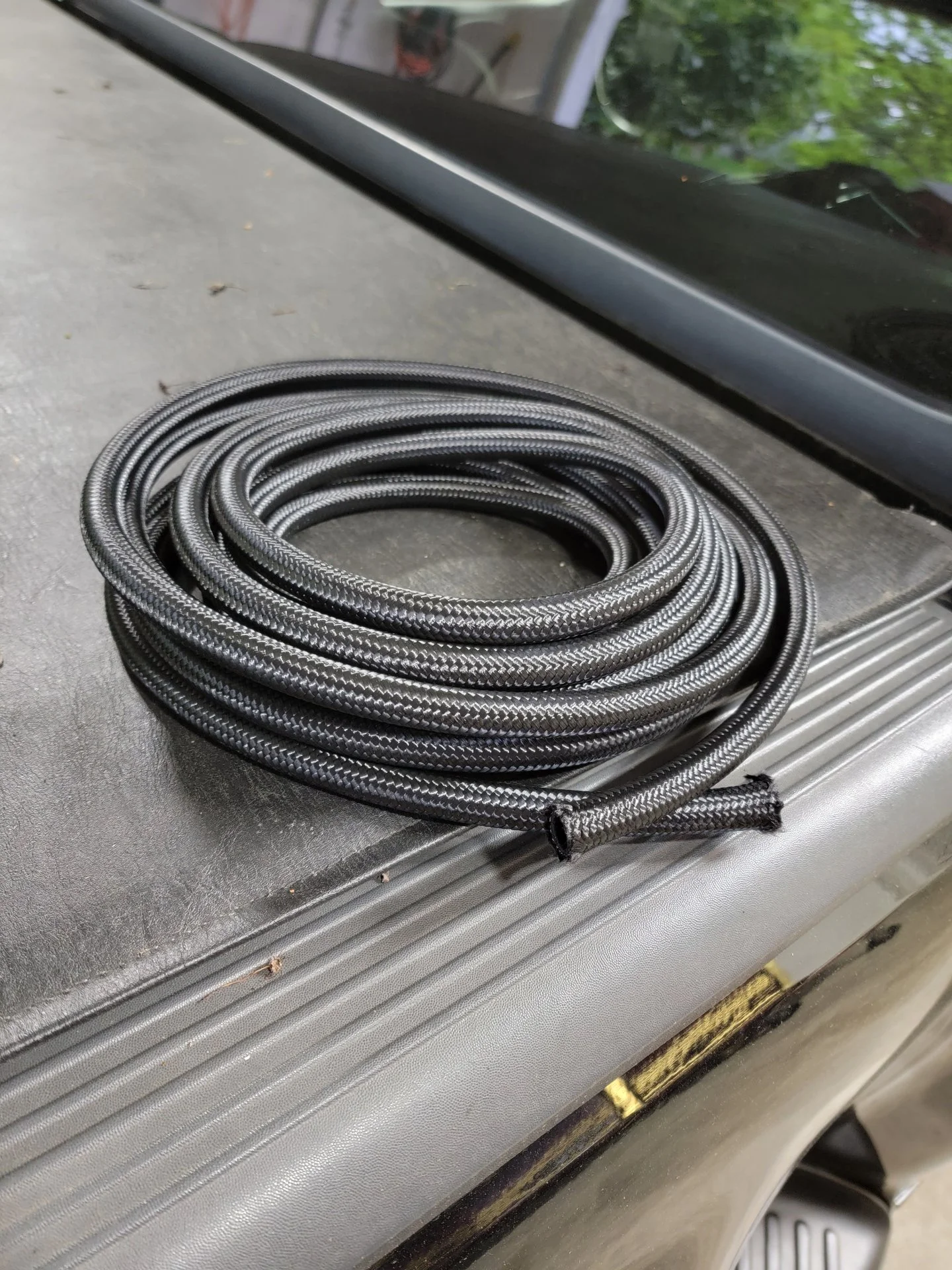

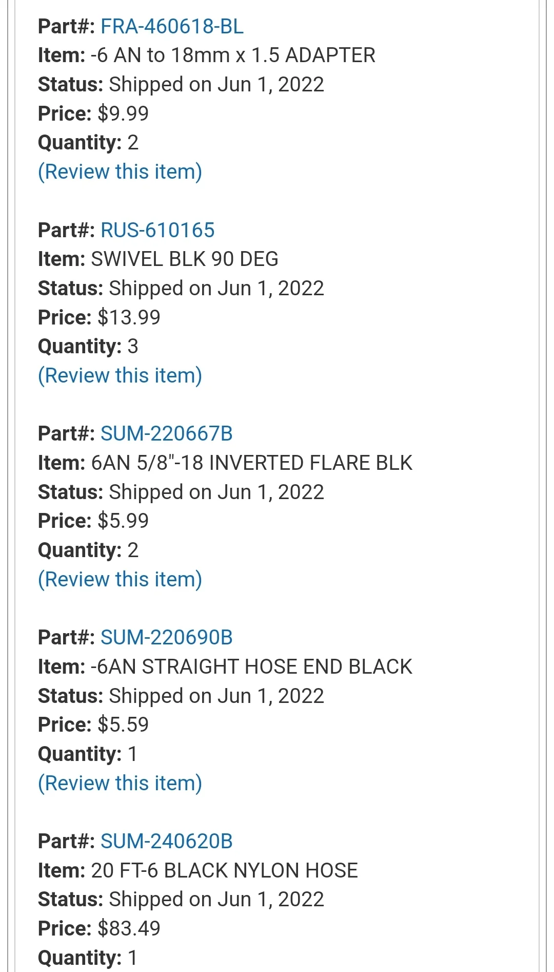

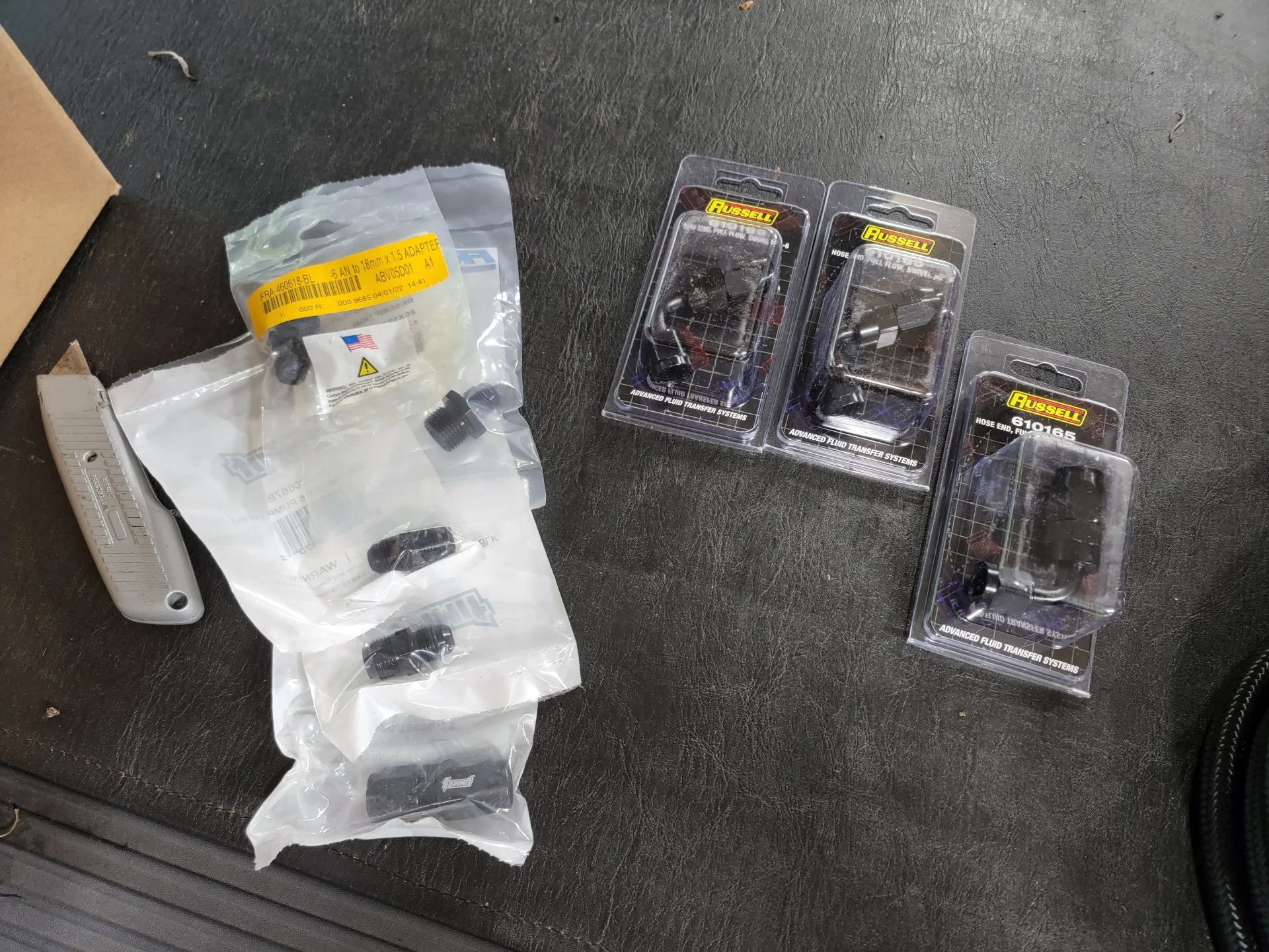

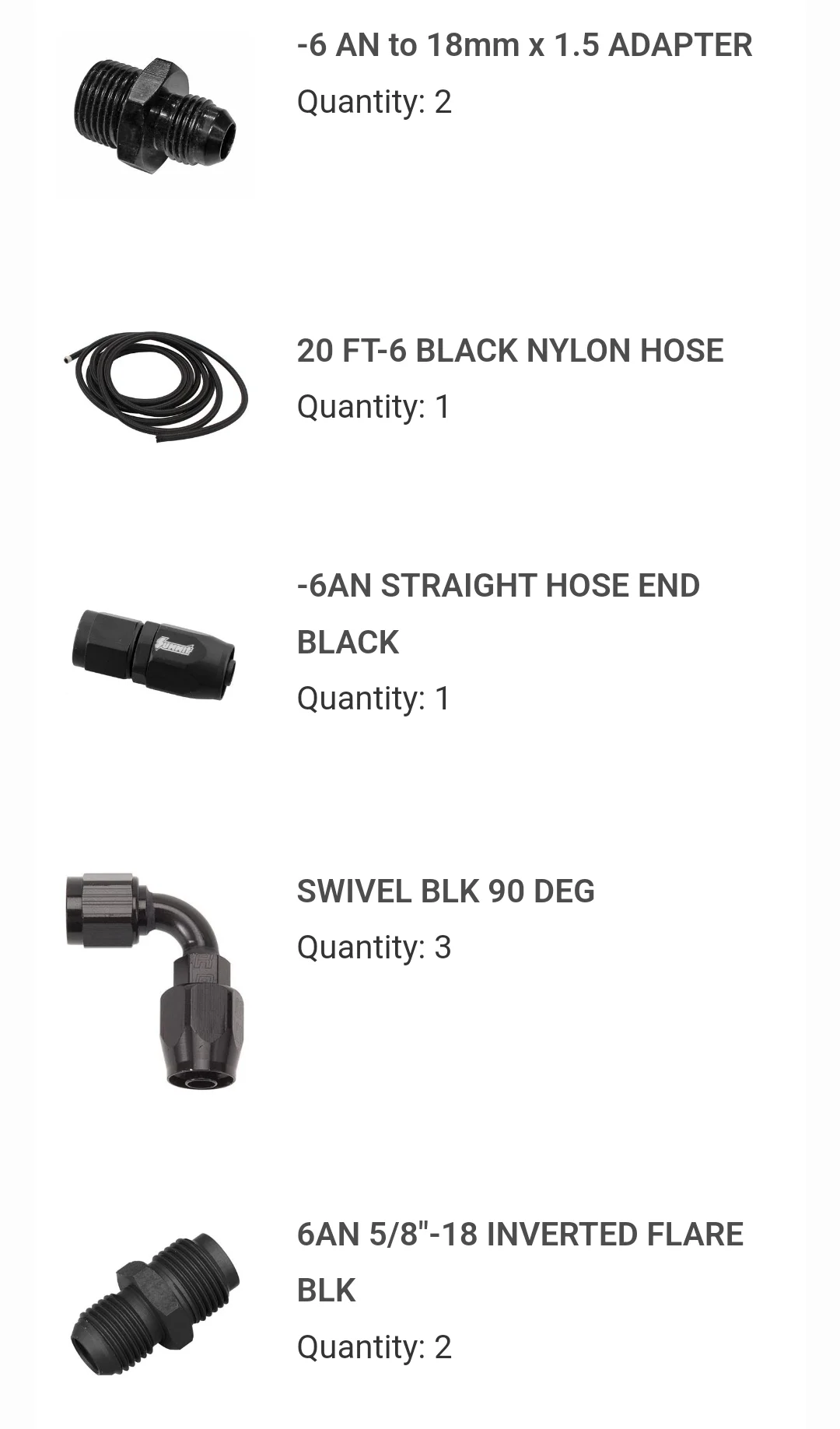

The fittings and hoses.
Some are to adapt -6 an to the trans. Some are to adapt the cooler to the -6 an hoses. The rest are for the hose ends that I'll make.

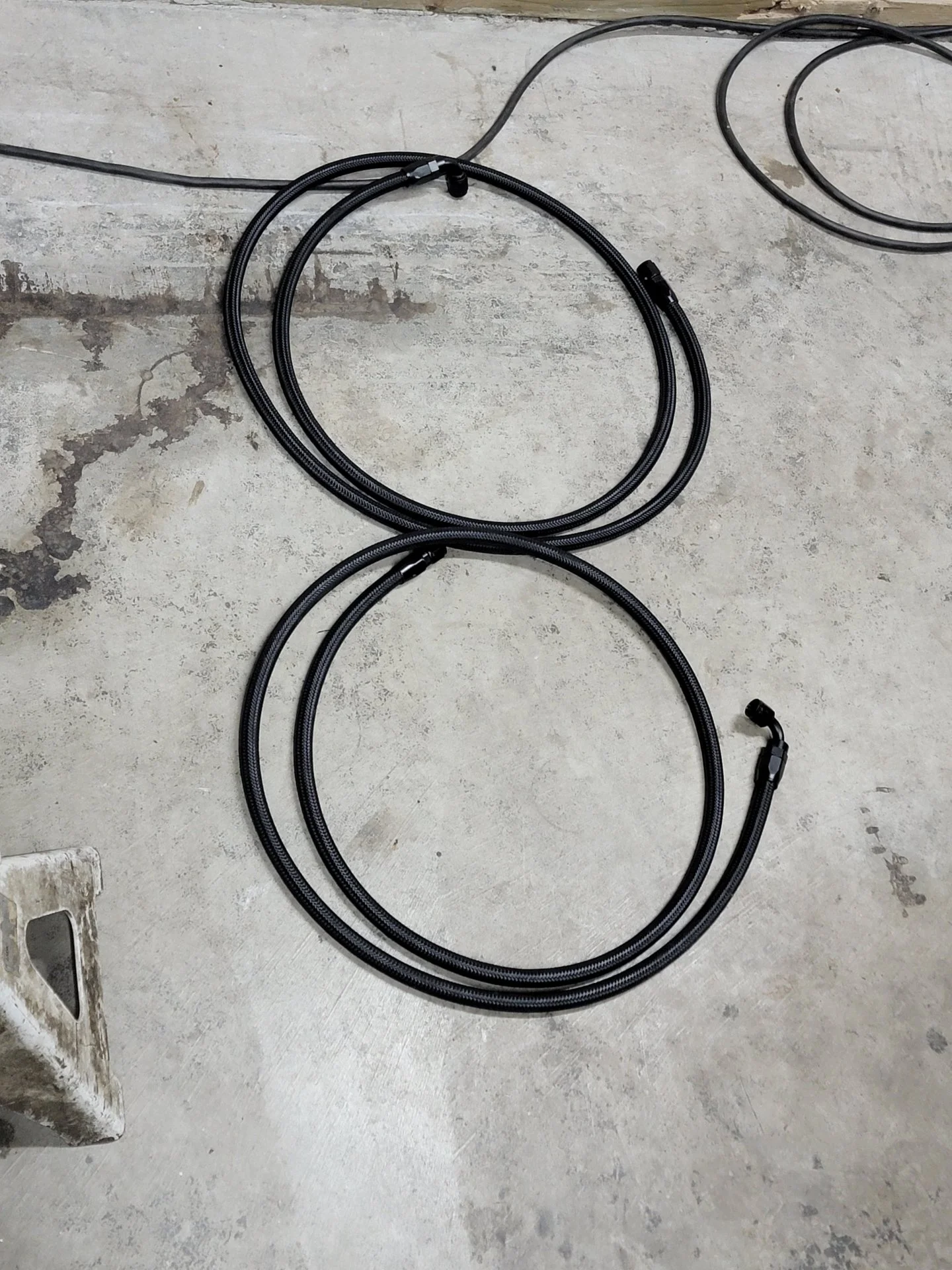

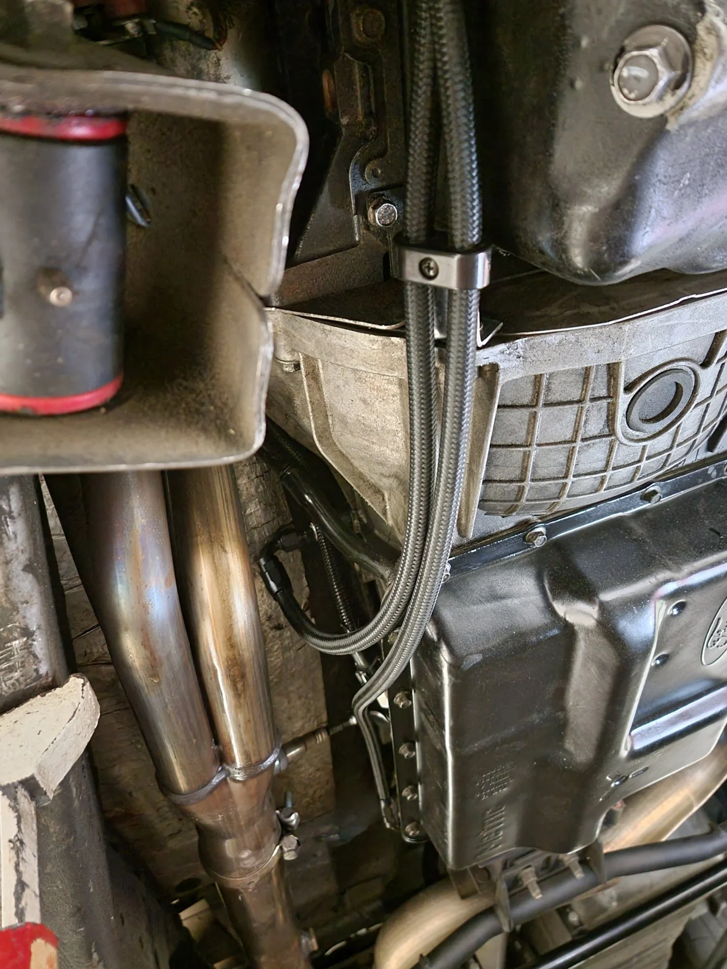

I'll be running braided -6 an lines from the trans to the cooler and back.
I'll post up images of the parts when they're here.

Small package from summit
The bottom cooler is almost identical in size and type to what's on my land cruiser. It's a tube and fin style and not over efficient.
The top is the new one and is a stacked plate style. It's far more efficient and obviously larger.
The upper cooler in the photo is the same type as what’s in the USA market 80 series.
