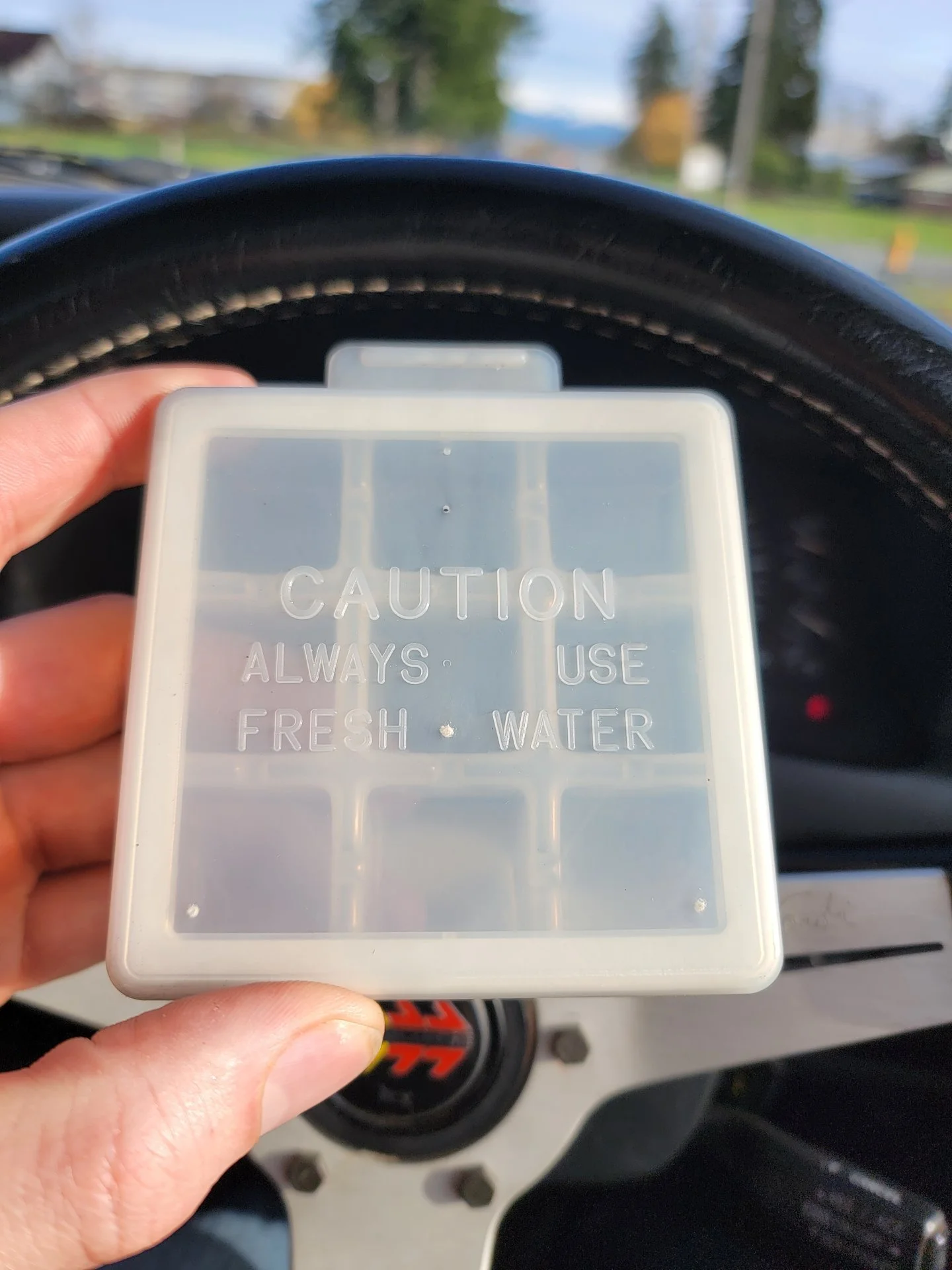

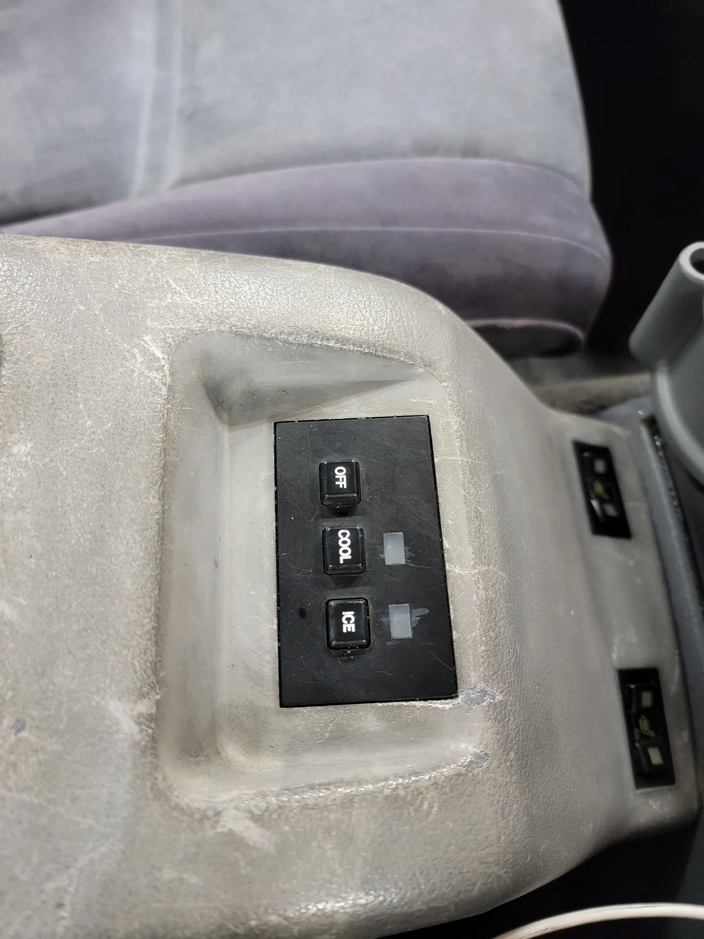

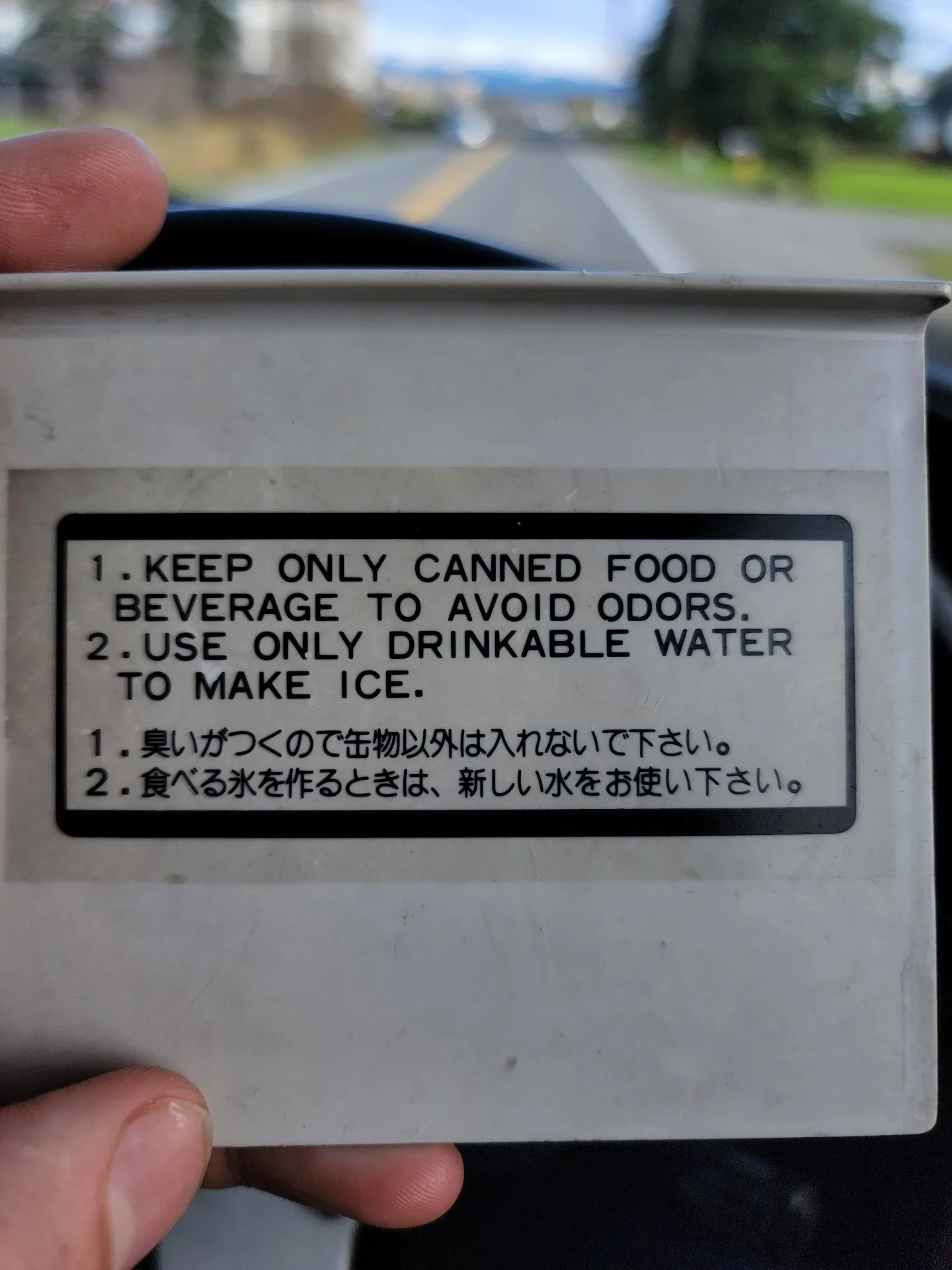

Here are a few random shots of the rig and some neat things i found.

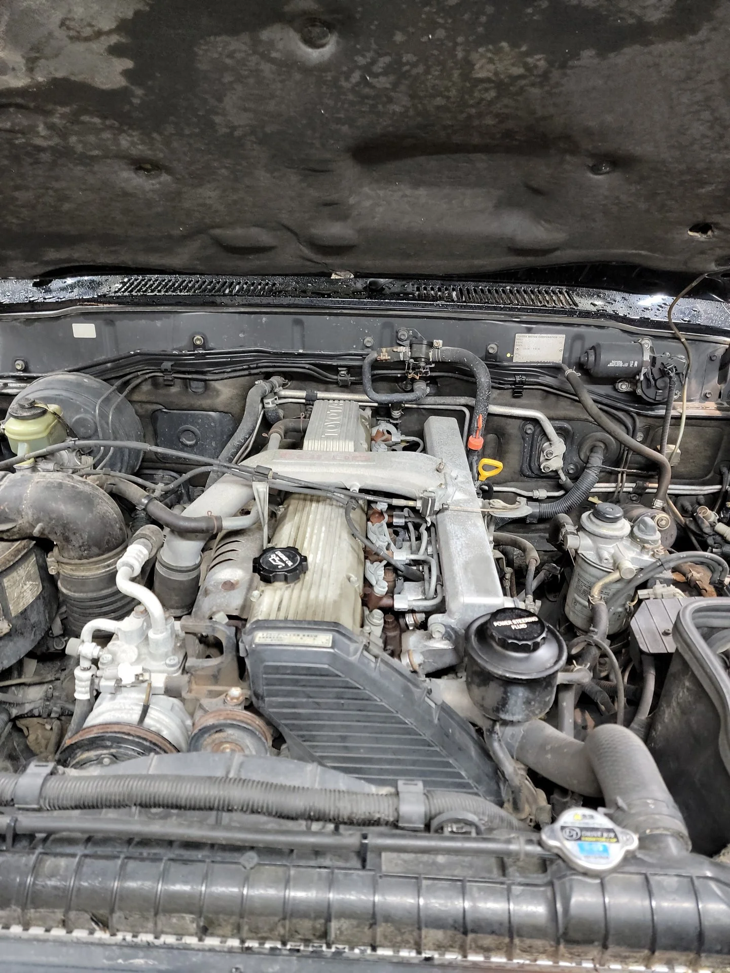

Today I finally turned a wrench on it.
Some parts showed up from cruiser outfitters, and Australia.
I did the timing belt. The truck has 199,500 km and the decal under the hood says 98,xxx so it was due.
I saw a lot of people mention fighting the tensioner spring. I looked at it like a drum brake spring. I used this
Which is a hook style pick and I looped it around the stud for the spring. I looped the spring over the tool and just pulled away from the spring while prying on the tab. The spring stretches, slides down the tool and pops into place.
I did a fuel filter and oil change while I was in there.

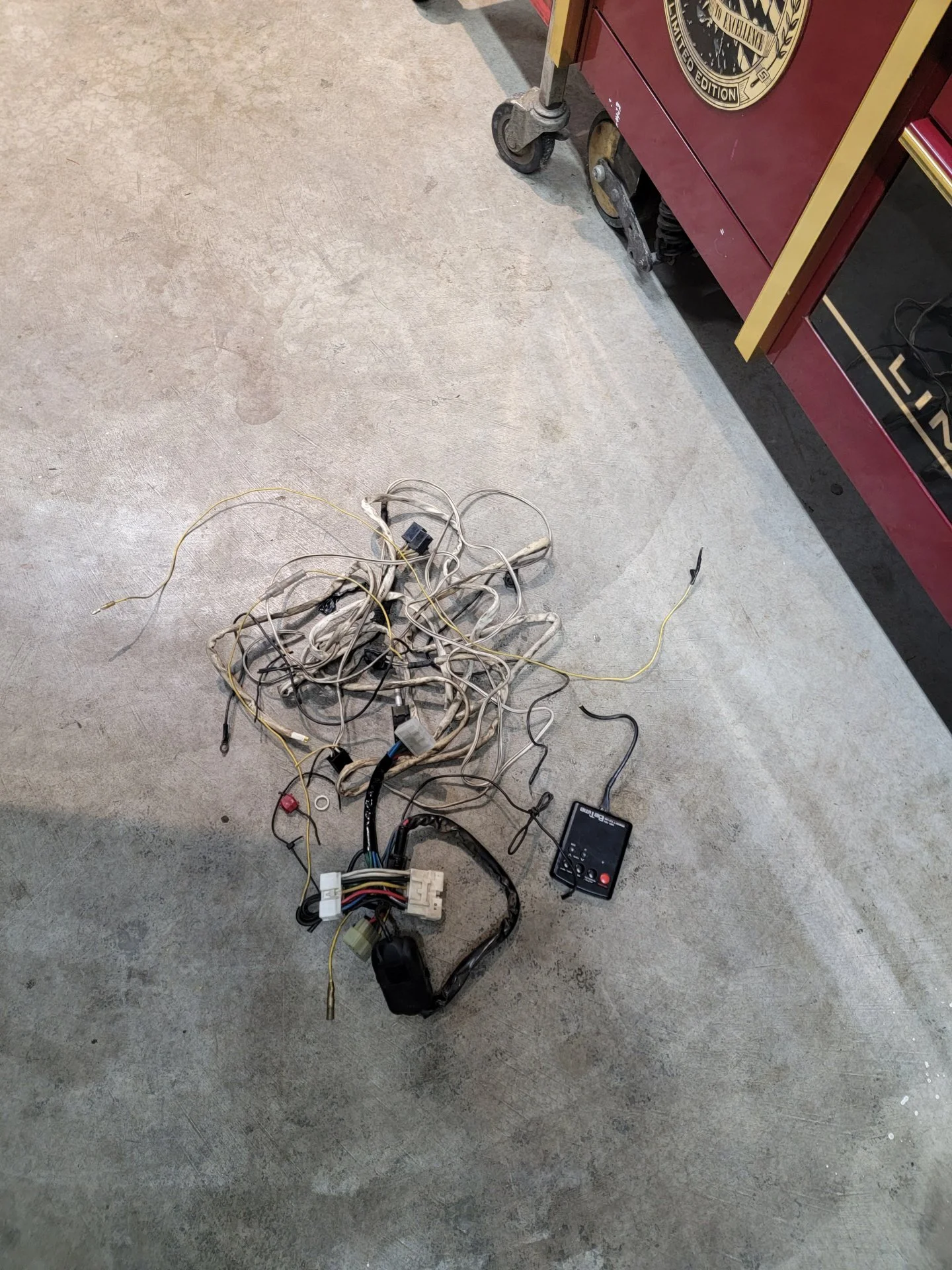

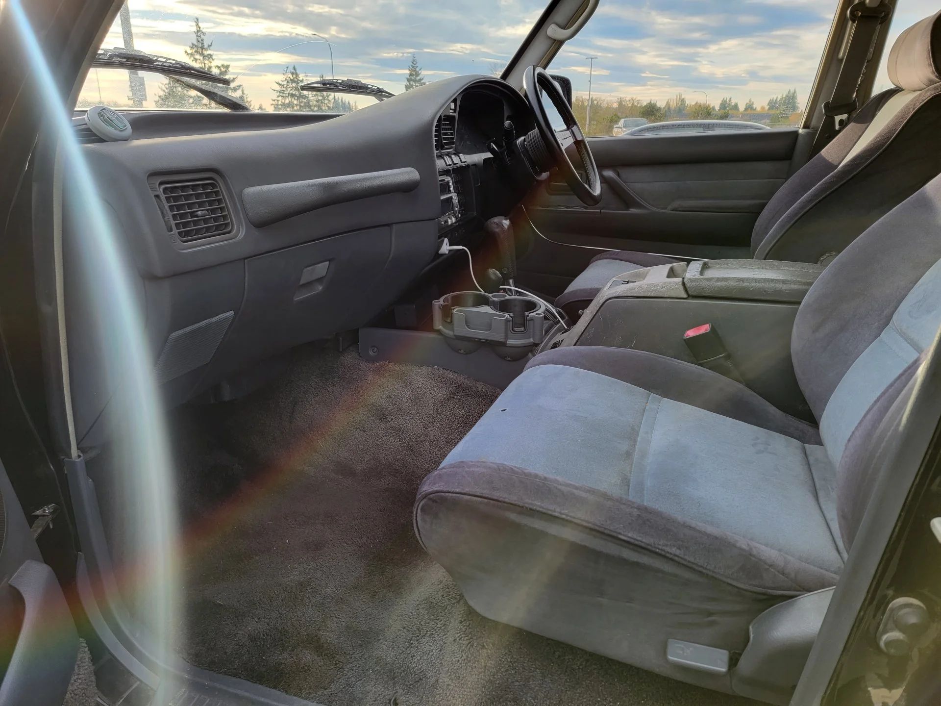

I decided to clean the interior up and remove some left over s*** from previous owners.
The truck had a non functional turbo timer. It also had an ipf light setup that had no lights.
So I gutted all that.
I also painted the letters on my center console.
I really need to rent a small shampooer.
I also used a little megiuars ultimate compound to see how the paint would respond. It cleaned up good on the hood for just hand polished. So it'll get a paint restore soon.
