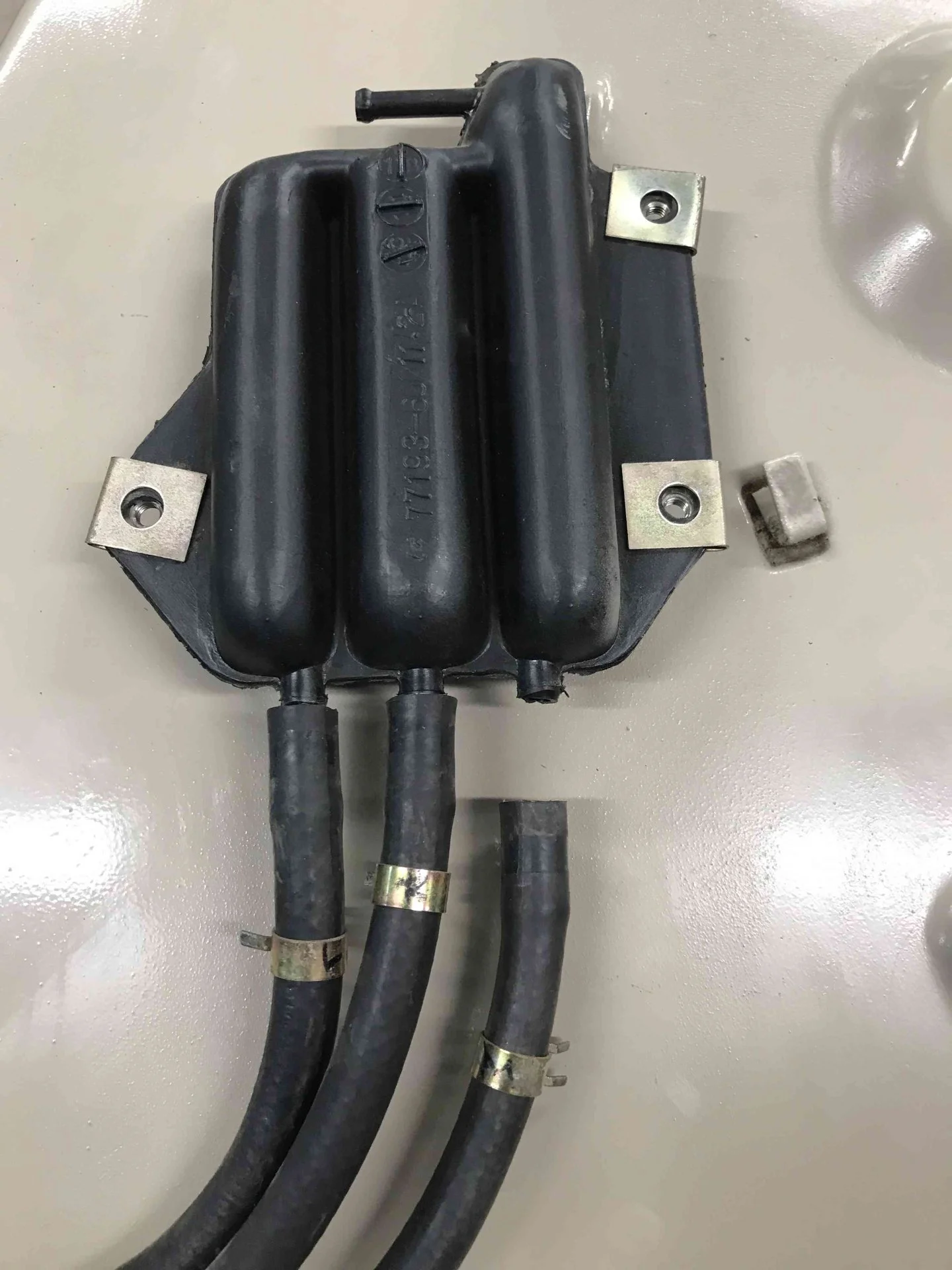

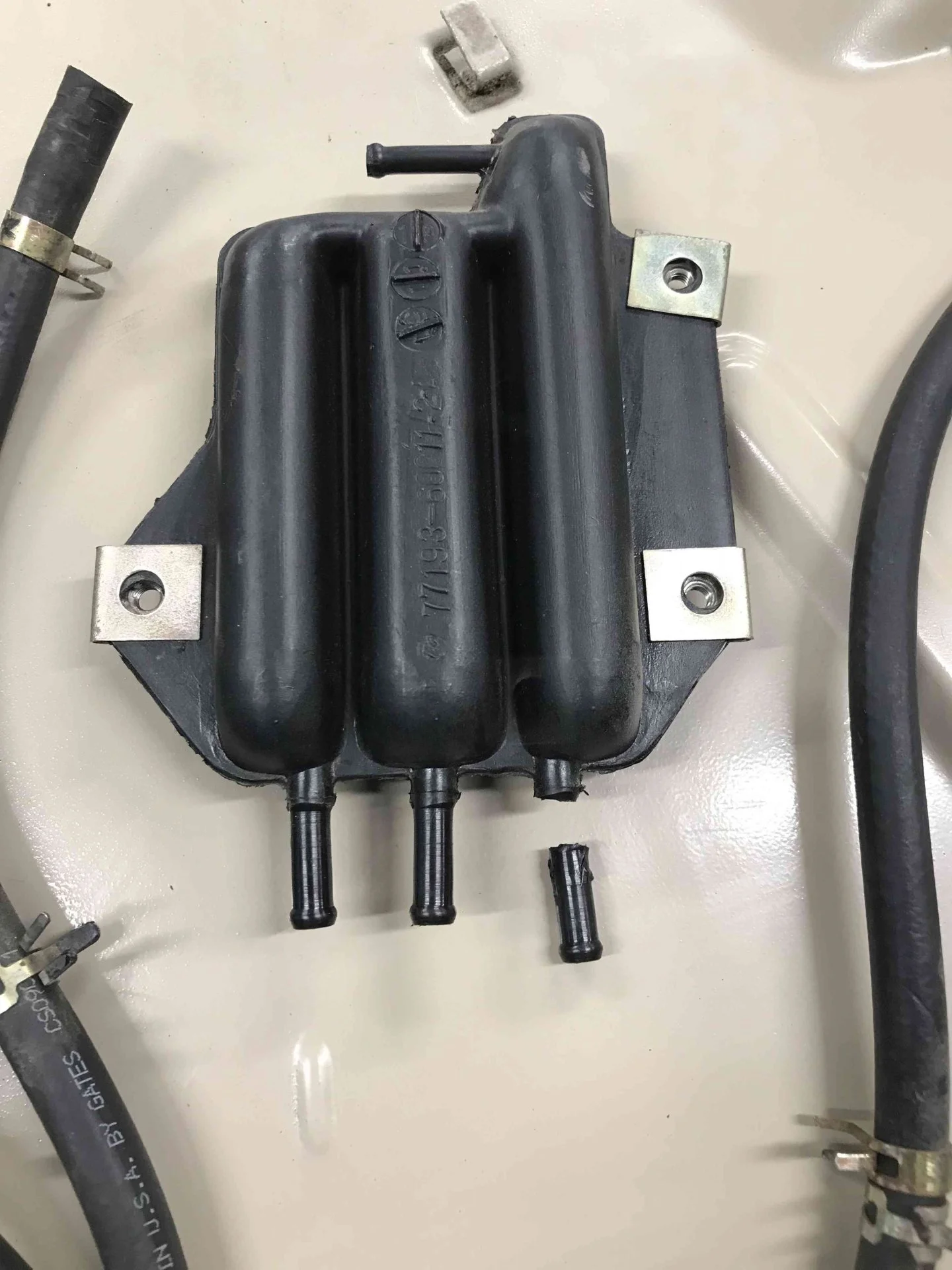

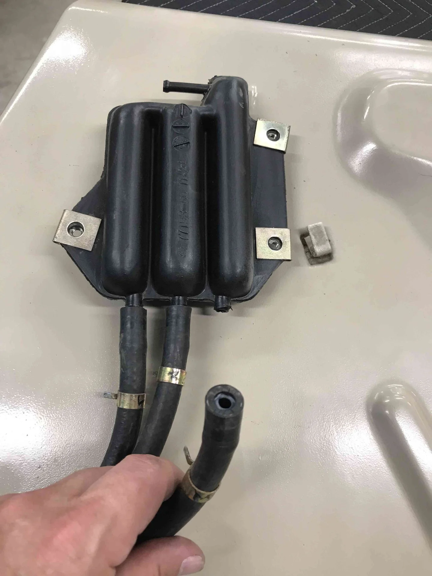

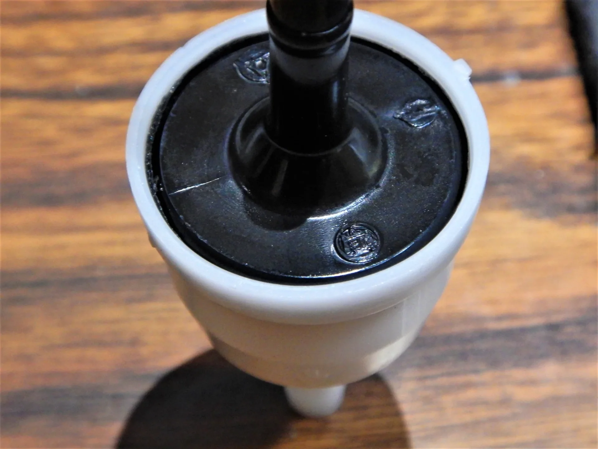

For the past month, I've been noticing a pungent fuel smell from time to time while driving. I initially thought my Sniper fuel lines were leaking at a joint, but upon investigation, no joint shows fuel residue. Thought it might be my charcoal canister lines in the engine bay, but not them. Goodness, I sniffed all around the fuel tank, not there....then I got a faint smell from the fuel evaporator separator area. Upon investigation, here is what I found. You guys see anything wrong with these pics?

I’ve since replaced it, but in about ‘91 I repaired mine that broke there with a male-male hose coupler to replace the broken off piece. Glued it up with ‘Seal All” and had no more vapour leaks. 5 or 10 years later I came across one that wasn’t broken and swapped it out.
I mention it because they do break, and couplers are readily available for field repairs on the road.

What is nutty, the fuel smell inside my 40 wasn't all the time, and didn't fill the cab during the day sitting out in the sun. Also the fuel smell wasn't that noticeable when I got in to go home from work. Seemed like it was more noticeable during down shifting or coming off throttle. I can only surmise that is when the fuel return is at max flow and creates vapor pressure inside the tank, only to purge thru the vents. Thus the strong raw fuel smell in short burst. None the less, it will get resolved here soon.

I really want one of those stainless units I've seen that someone here had designed and had fab'd up. Best to get away from the plastic long term.

Perhaps this: Olfactory fatigue, also known as odor fatigue, olfactory adaptation, and noseblindness, is the temporary, normal inability to distinguish a particular odor after a prolonged exposure to that airborne compound.
There’s a check valve there so it could impact when you smell fumes. I believe you’d only smell fumes when the pressures were right.

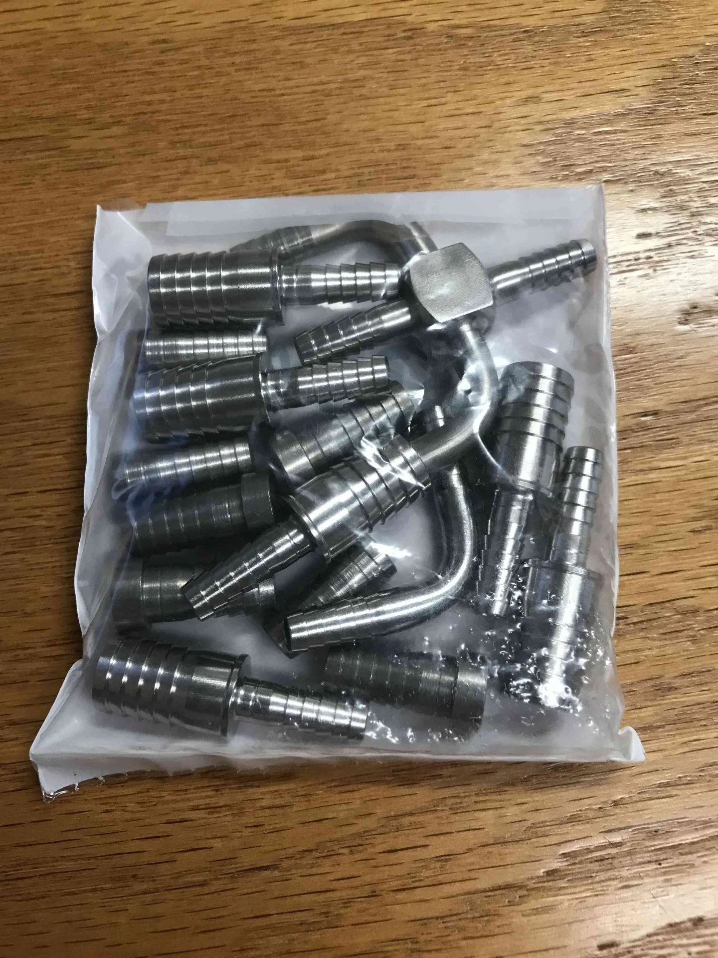

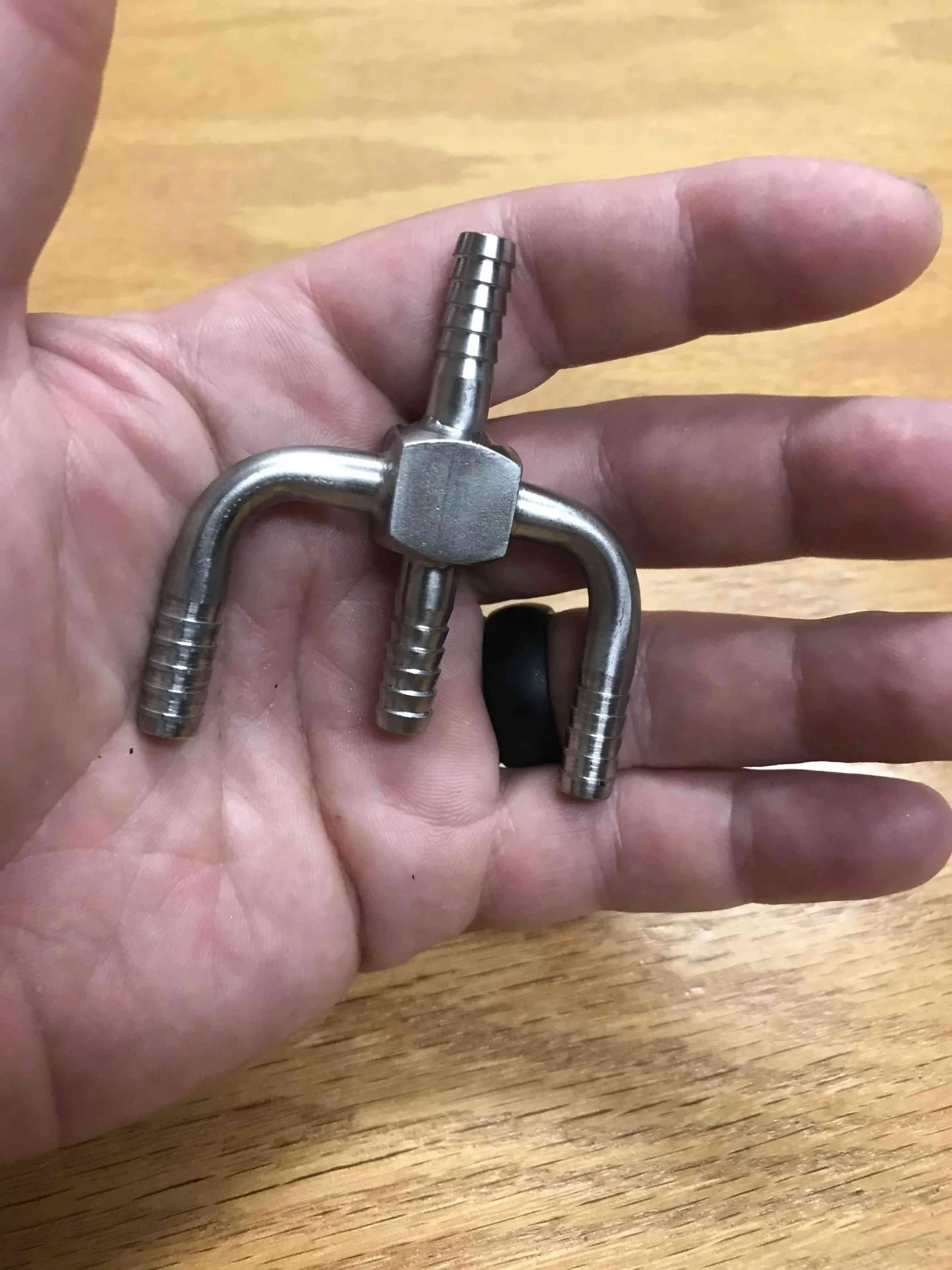

All right, got it put back together last night. Installed all new 1/4" lines and used a stainless steel barbed Y-Cross Fitting to tie the three vent lines together.
Y-Cross Fitting -> Click here <-

Rick- that's a nice solution to the vapor separator. Curious to see how it will work without "chambers" to allow the vapor to collect and condensate to drain.
Yeah, I thought about that. I have these to make the chambers if it becomes a problem. -> click here <-
Should I need the chambers, I would probably make three 2.5" high chambers out of 1/2" gates fuel hose and the attached fittings.
Tell you what, I'll make it up tonight and post a pic tomorrow.

50yr old plastic is going to do what 50yr old plastic does. Just had a plastic TS pedestal give up the ghost recently. So now I’m casting knowing glances at all my plastic/rubber pieces and parts😡..

I really like the simplicity of this solution. I'm curious if you experience any issues from not having the "chambers". This seems such a straightforward and obvious solution...
