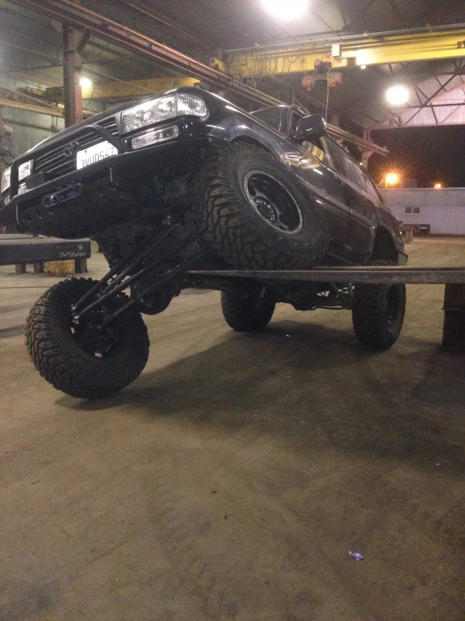

Tough for some, sure, tough for most, maybe. I got absolutely no prob cutting off factory stuff. I don't even want to drive an 80 with the stock motor and won't. I think I have said plain as day what my issues are with it (3-link) so no need to say more.
I think you might still touch on the c/o's. That axle is going to swing a bit side to side in the rough, unlike you can simulate in the garage with a jack.
