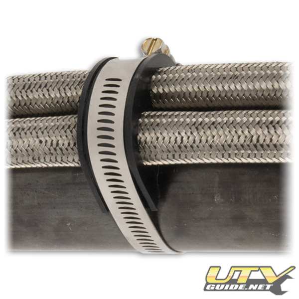

Waiting on these little clamps to finish the brake line routing
Sweet brake clamps. Where did you get those at?

I would worry about them moving and abrading a hole in the line, what about heat shrink around the brake lines where they clamp?
The brake lines I bought already have a steel braid + the outer sheath.
Also, they won't be sliding back and forth the way I'm planning on attaching them. They'll go from the frame to to the lower link where they'll be attached similar to this. This is where the slack will be for maximum down travel. The little clamps will be used to route the line along the axle housing to the caliper which really won't have any movement.
