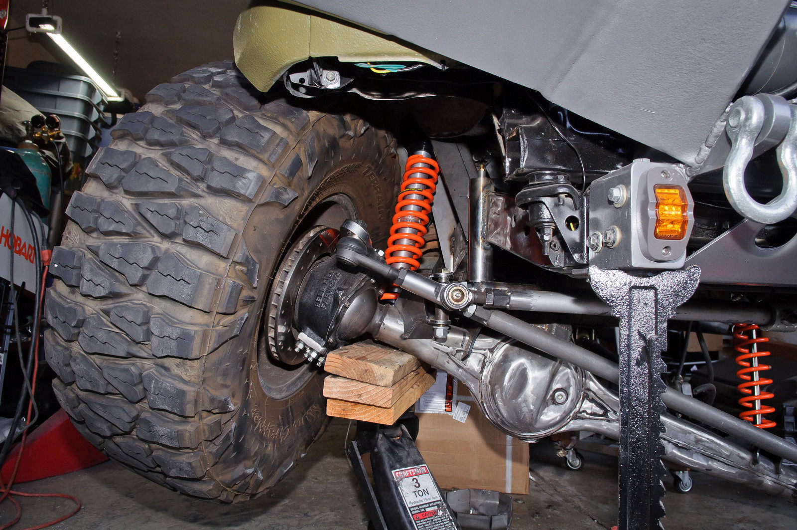

Updates are starting to have some substance now! Finished cutting and tacking in the passenger side tower. Now I can finally do some REAL testing and clearance checks. This one has some pics you guys have been waiting for.

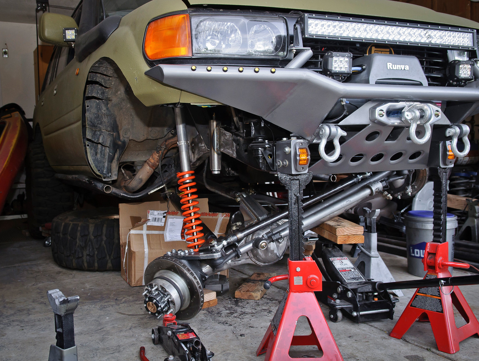

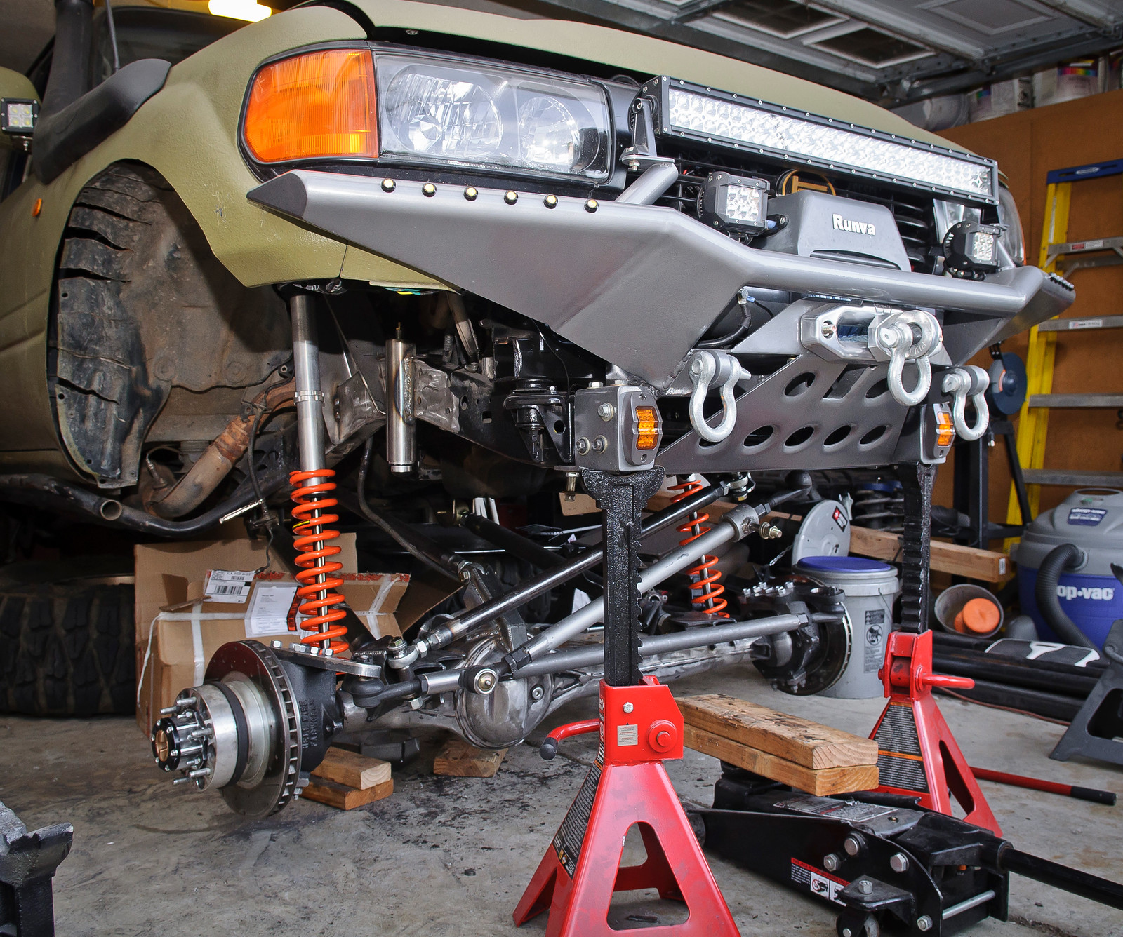

Here's full droop on passenger side with shocks installed

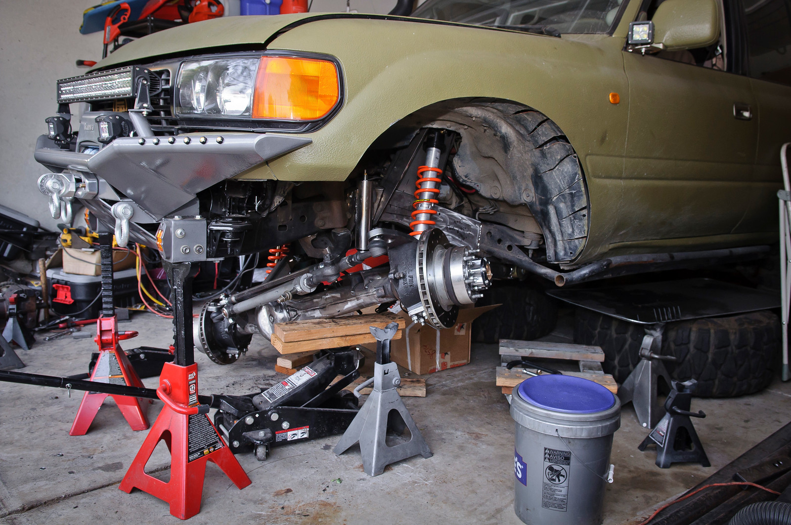

With full stuff on driver's side

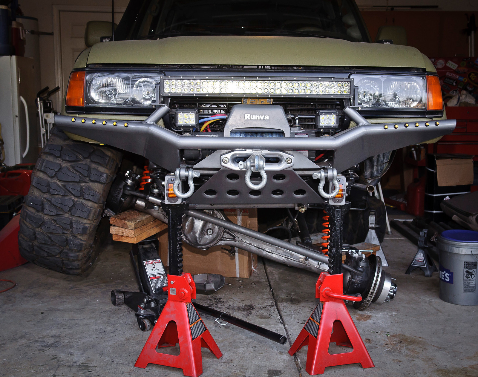

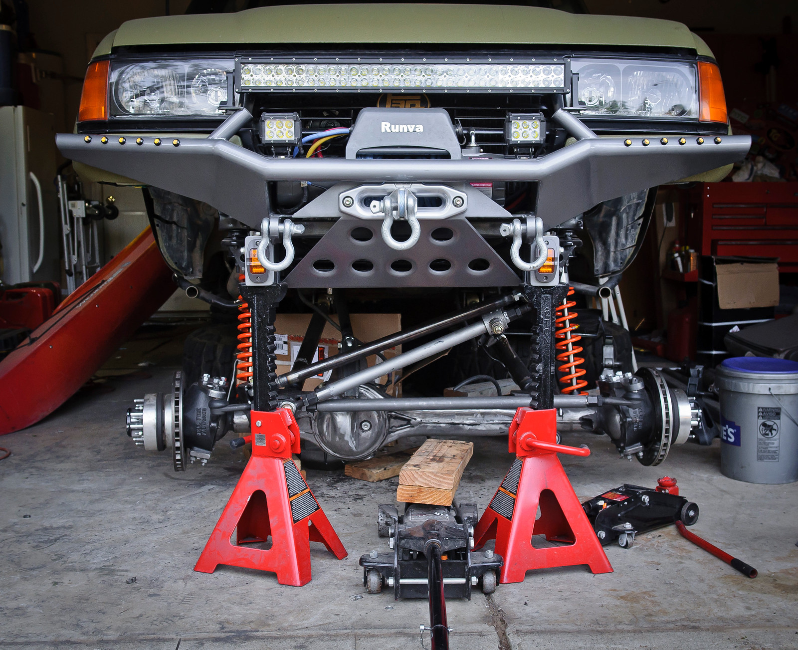

Full droop on both sides. I swear you could fit 16" coilovers on these things for ridiculous down travel

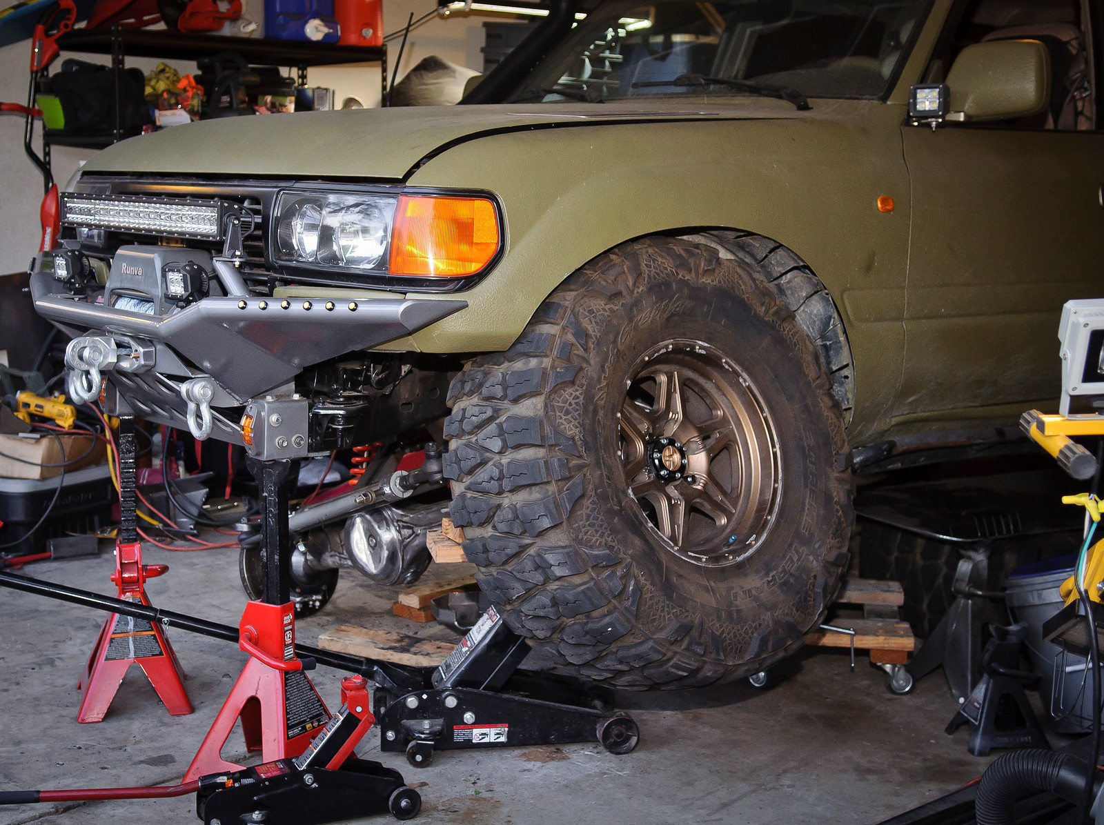

Now lets test with the tires on

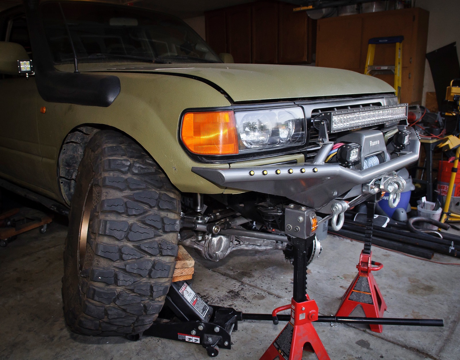

With my trimming the tire can fully stuff no problems. But you can't turn the wheel left because of how the axle moved forward. I will need to cut more out of the front part of the fenders. I'm going for maximum travel and don't mind cutting sheet metal. Those that aren't willing to do so will need to lower the shock towers accordingly.
I couldn't even turn the wheel here. All this will need to go
Now the wheel turned all the way right
No issues with the sheet metal

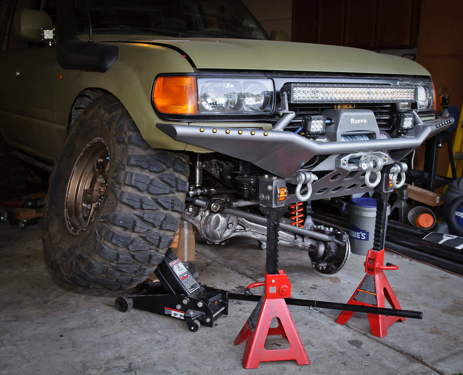

But here's a problem. Tire touches the springs about 1/2" before hitting the steering stop. I think what I'll do is slightly modify the towers so they angle in towards the engine bay just a bit more.

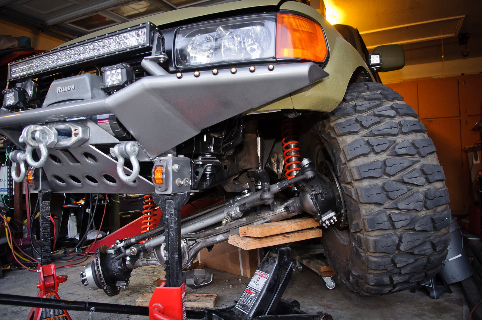

And driver's side tire mounted
Turned all the way left
And similar issue on this side with the spring. This is actually full turn, touching the steering stops. I was able to move the spring over enough to get it fully turned.
