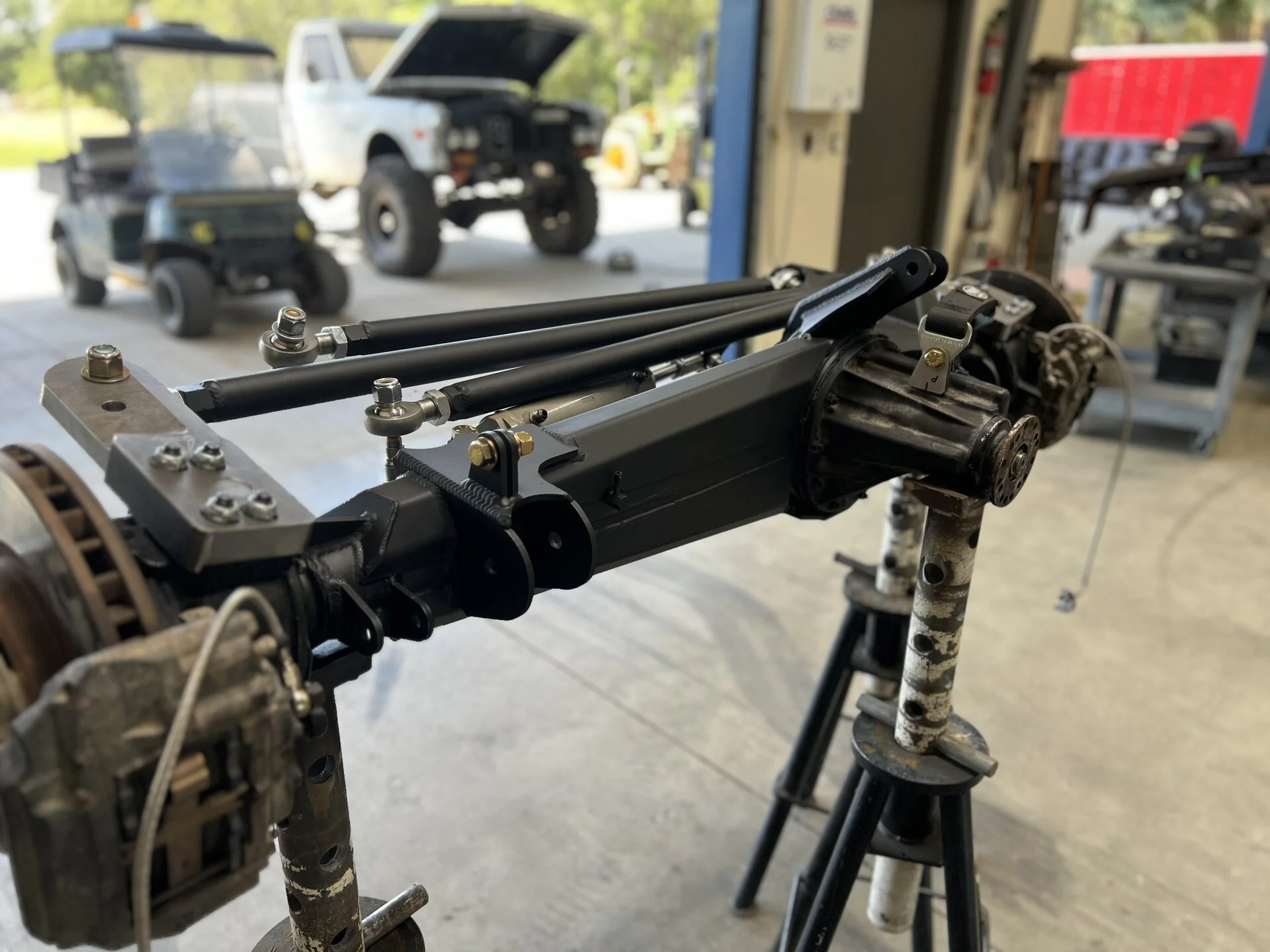

Hey! I just went though this whole thread. Very awesome and your rig is amazing. How has this 3link kit stood up to the test of time? You've had it on for nearly 3 years now? And I just saw you're selling your rear suspension setup, whats the new plan?
Front suspension has been flawless after several trips and lots of road miles. Take a look at my full build thread. This is the last post where you can see what I'm doing to the rear suspension (and lots of photos of past trips as well).

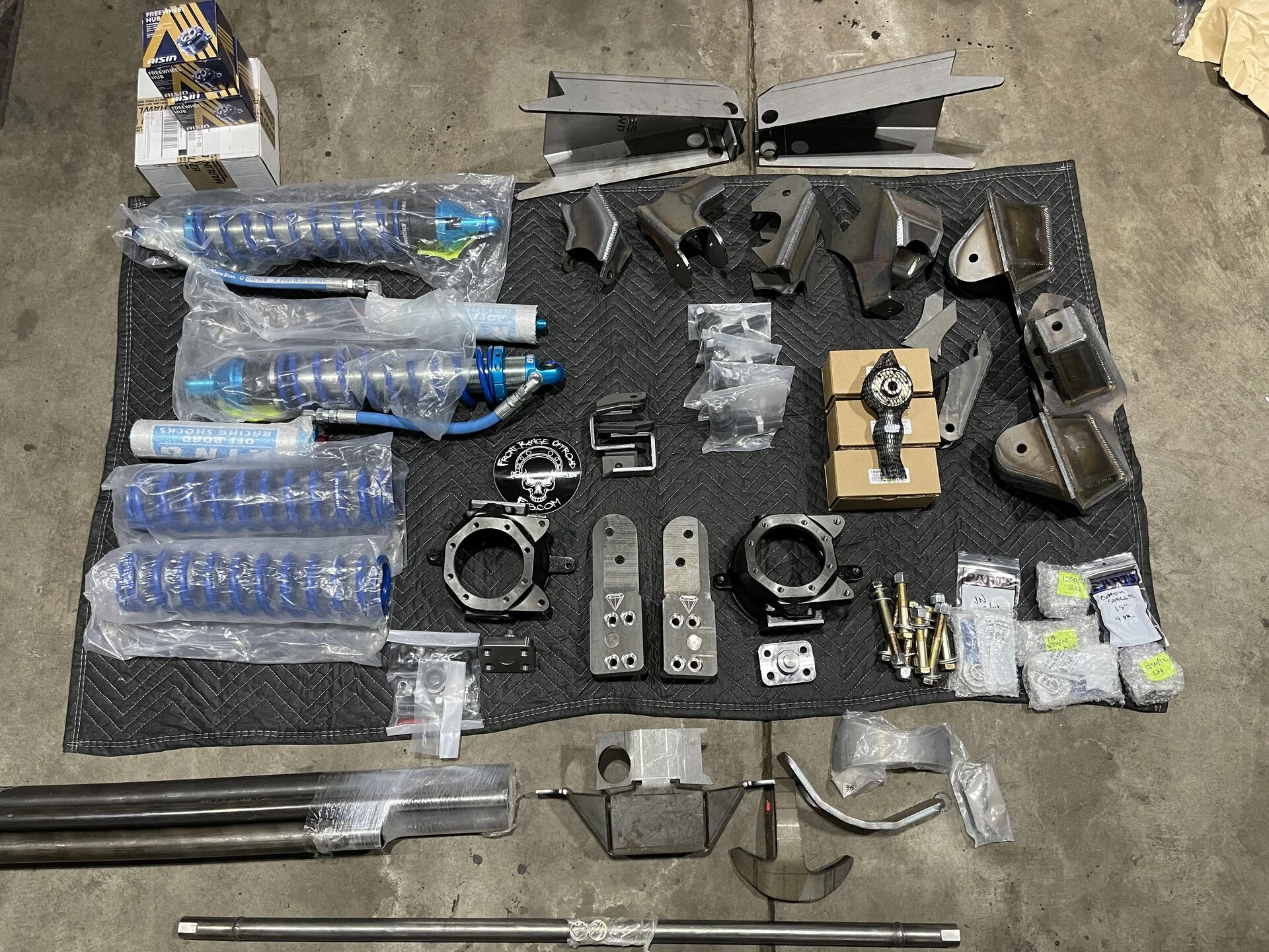

8 months of collecting parts...

I'm getting this done by a local fabricator. He's done a bunch of my buddy's trucks.

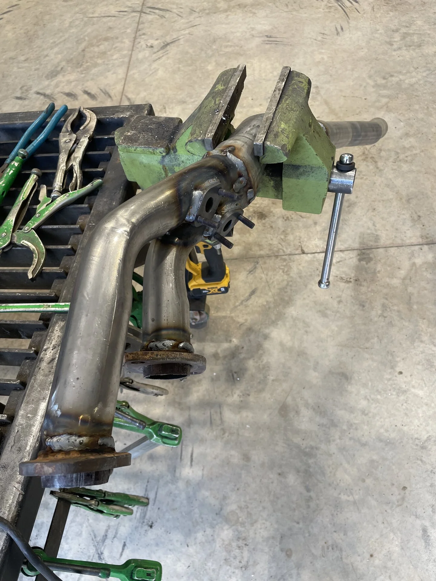

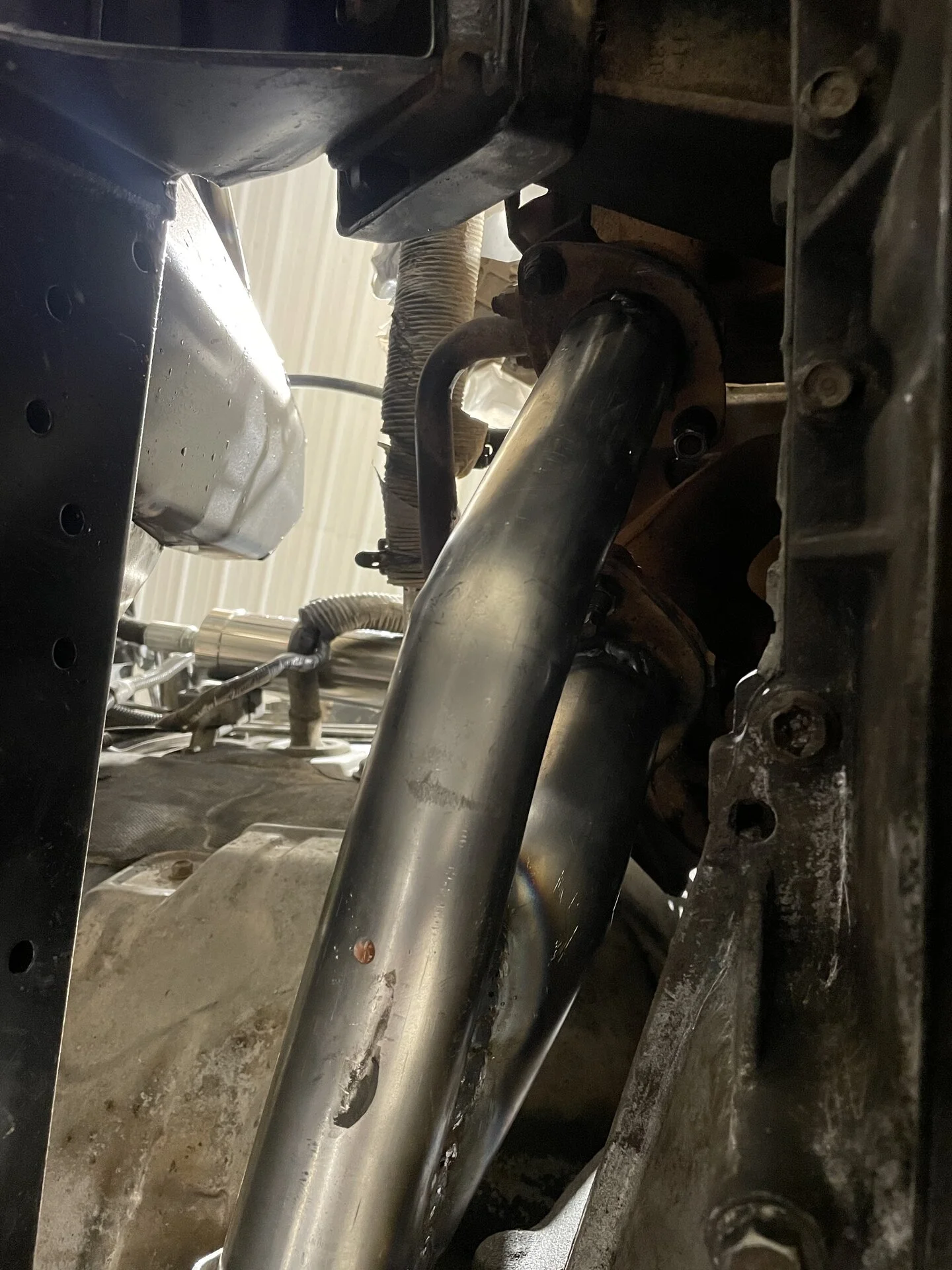

Some say you need the Australian manifolds from the solid axle 100 series 1fz to get the exhaust in the frame but I did a 2 into 1 Y pipe and ran mine down the inside of the frame rail so I could mount my towers where we wanted. It also required deleting the rear heater. @petwhookie you’re making me want to take mine back apart and paint it all back up nice! Looks great!
