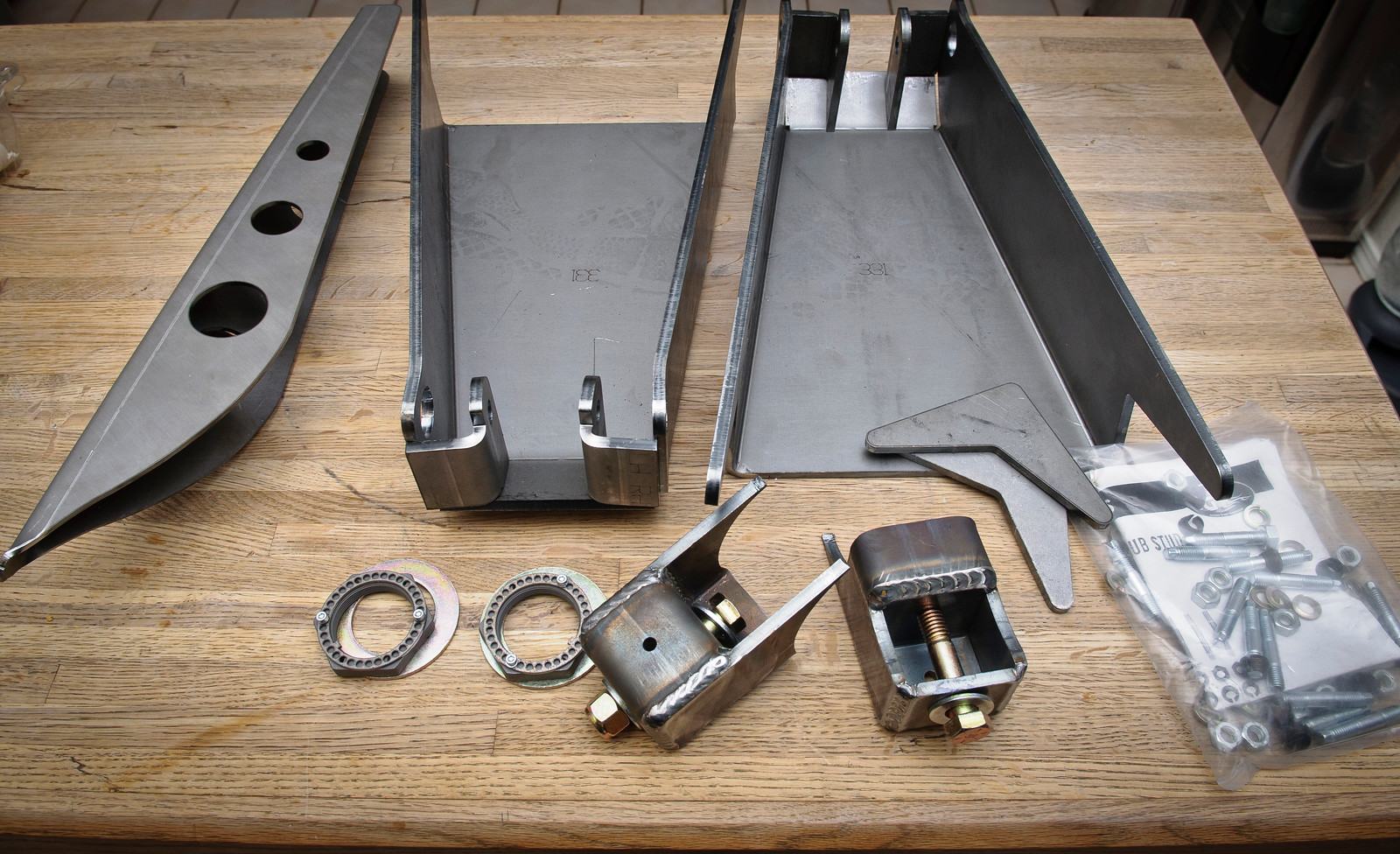

And of course we need to thank Brian @4WheelUnderground for paying attention to the cheap but demanding 80 crowd. To-date nobody has been willing to put out a comprehensive 3 link package specifically tailored for these trucks http://www.4wheelunderground.com/fj80front3link.html
Parts started arriving back in December and I've just recently started the demolition.

Panhard bracket really only goes in one place so I started to tack that in. Not much room to get this one wrong so no need to wait for the axle.
You could tell Brian put a lot of thought into this intricate bracket.
You could see the part of the OEM bracket I left in place. No way in hell I was going to try and remove that in between the steering box bolts.
Driver's side control arm bracket
Passenger side bracket that has the 3rd link mount built in. This thing is a BEAST!

Does the 3 link put that much more stress on the axle that you need to gusset it or is that a "while you have it out" upgrade?
A radius arm binds and asks the axle for stoppage. This is bound by rubber bushings, so we don't have bent up axles by stock suspension fallacies. But that gusset is 'while you have it out', nothing 3 link specific. A 3 link does not bind.
