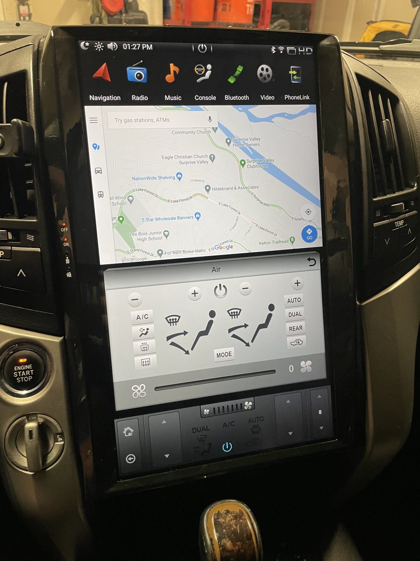

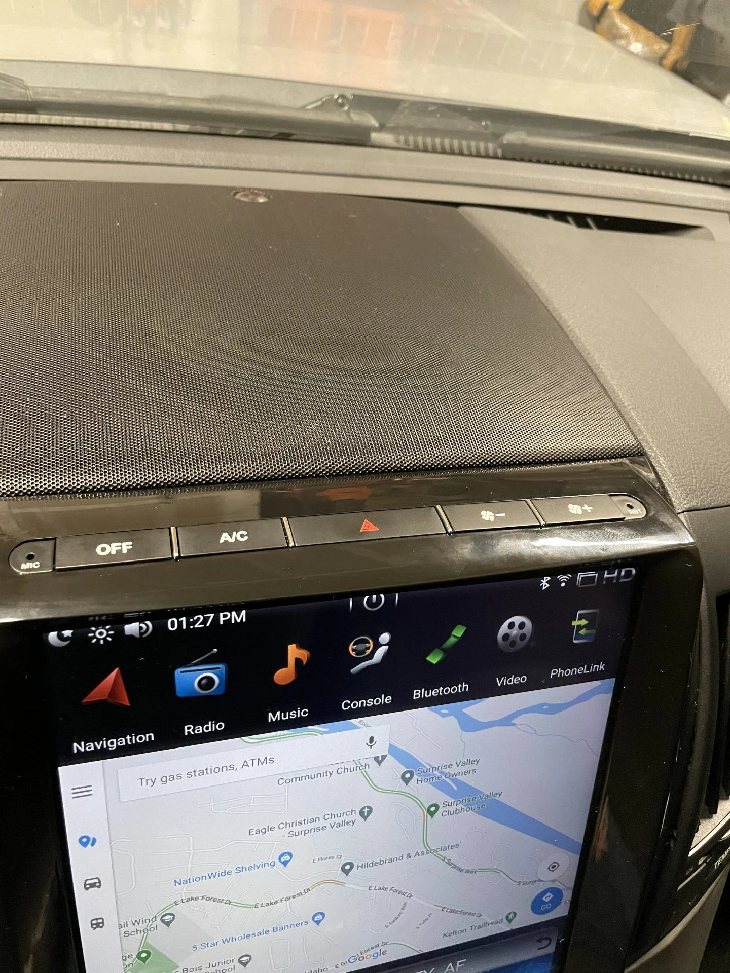

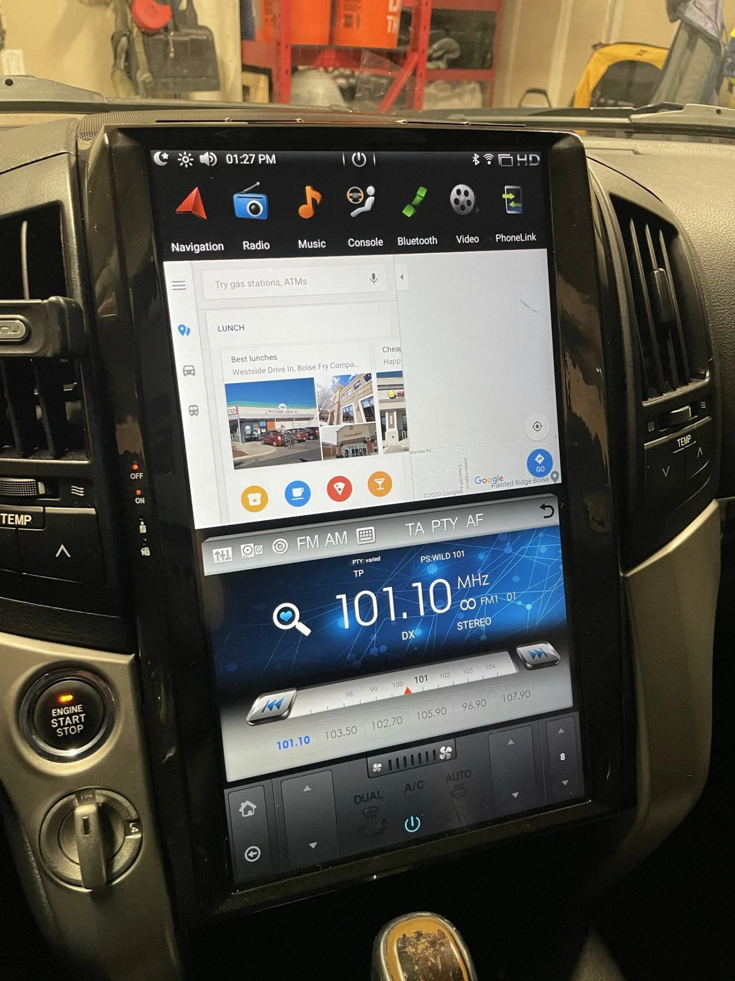

Installed the new 17” version in the LC today. Pretty straight forward, I think it took longer to figure out what harness (4 to choose from) to use than the actual install. HVAC buttons on top
Looks good. Does everything work? How does it sound compared to the original? What year is your truck?

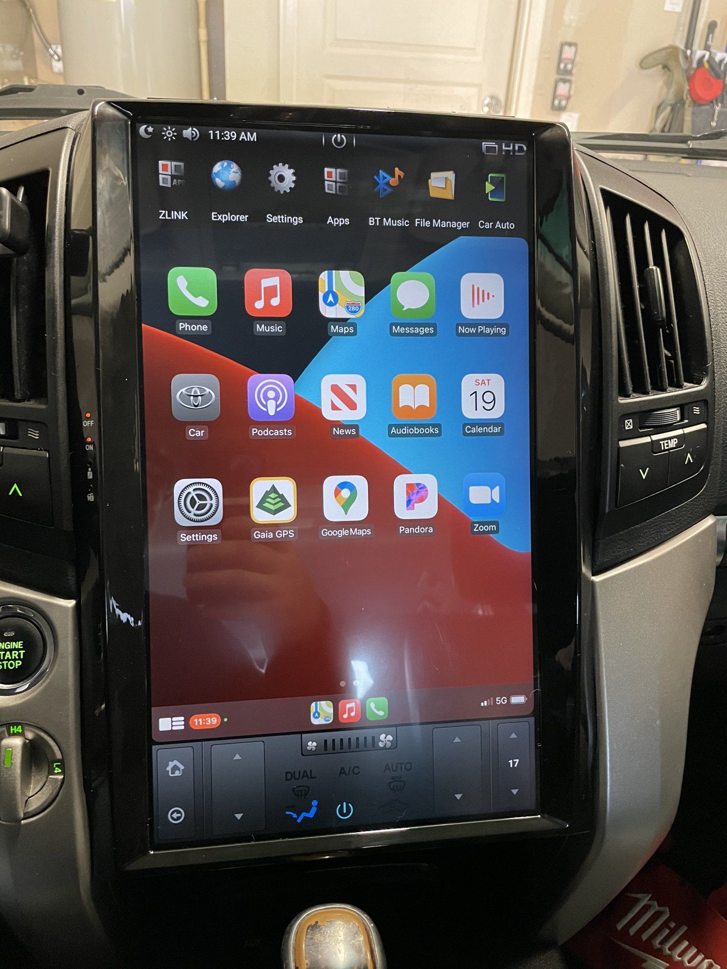

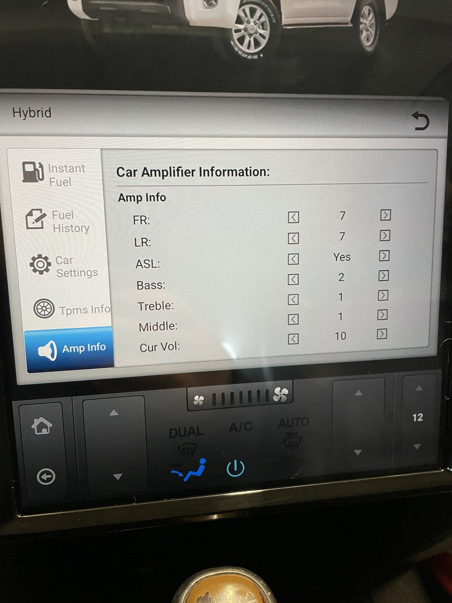

I have a 2008, everything works well. There were some adjustments in the settings I had to do to get the volume level right ("Cur Vol") but it sounds better than the OEM to me. There are tons of adjustments you can make. I'm still getting used to some of the apps, and there are multiple ways to connect the phone for Bluetooth car play, etc(pic below of Apple Car Play using Zlink). When I get some more time over the holidays, I'm going to see if I can connect the rear monitor. I would think they just used a negative trigger or something to activate the drop the screen but not sure. The video and audio wires seem straight forward. I have the electrical wiring manual for it but I'm still trying to decipher some of the abbreviations for the OEM wiring.

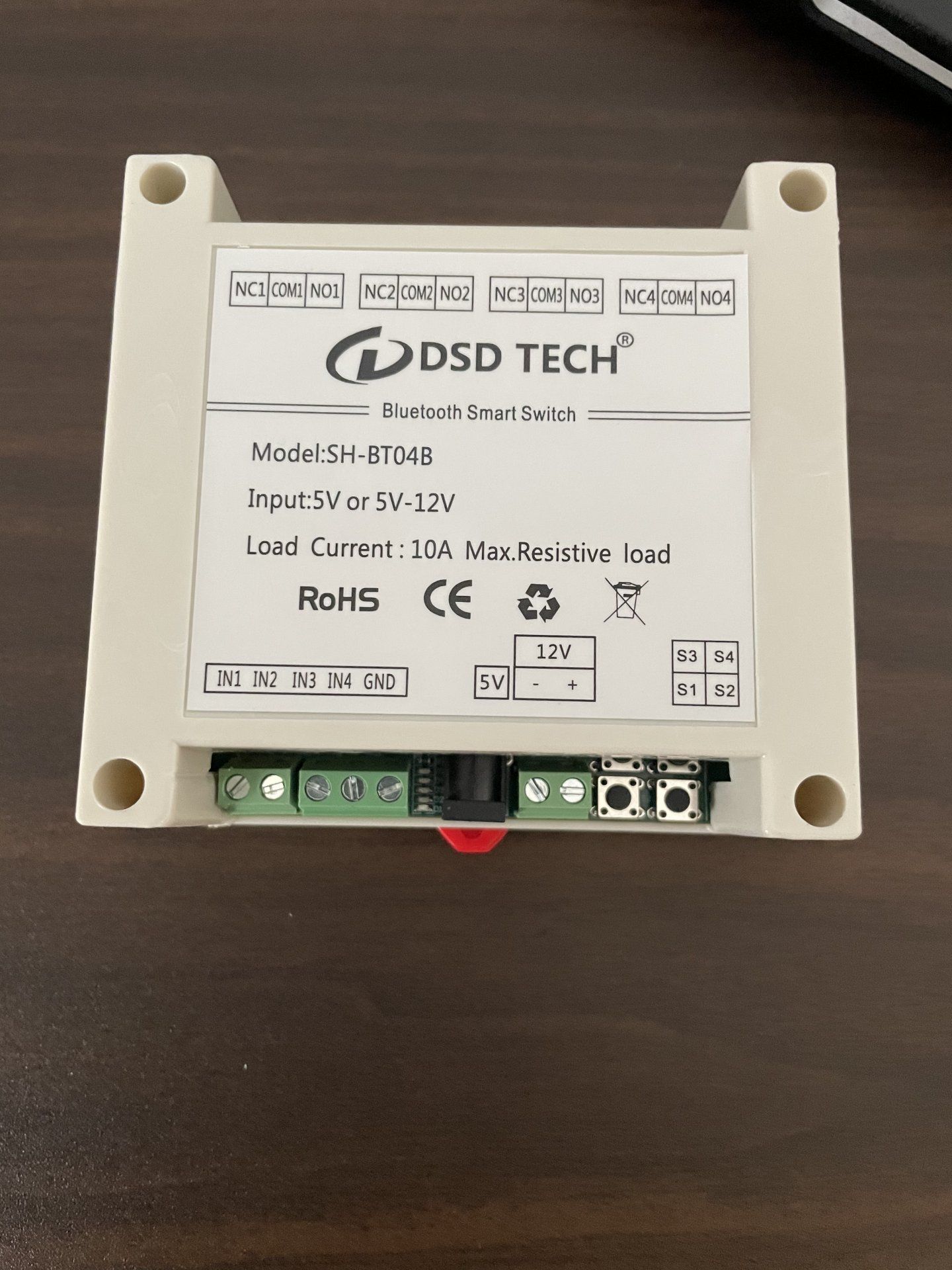

I also ordered a Bluetooth app controlled relay bank (DSD TECH) to work the drop-down screen if possible, and I was going to connect the reverse cam trigger to it so I can view the cam while going forward (to see a trailer, etc). The relay has both android and ios apps so it can be used right from the radio. (Worst case I'm out $18 for it lol)
While there is still a big learning curve for me, overall I'm pretty impressed with the system.
I’m using that Bluetooth relay to run my light bar, rear locker, and compressor.
How do you like it? Any issues? I liked that it also was rated for AC as well (up to 277V I believe) and had slots for din rail mounting.
The software forgets the custom label. Occasionally I have to reboot the iphone to reset the bluetooth stack. Not huge inconvenience considering I didn’t have to breach the firewall and didnt need to figure a mounting solution.
overall love the concept and give 8/10 to the execution.
I’ll probably add an 8 switch clone I got for Christmas gift last year at some point, but rolling the Bluetooth for now.
it also makes a great debug, temp solution. Like you said, $20.

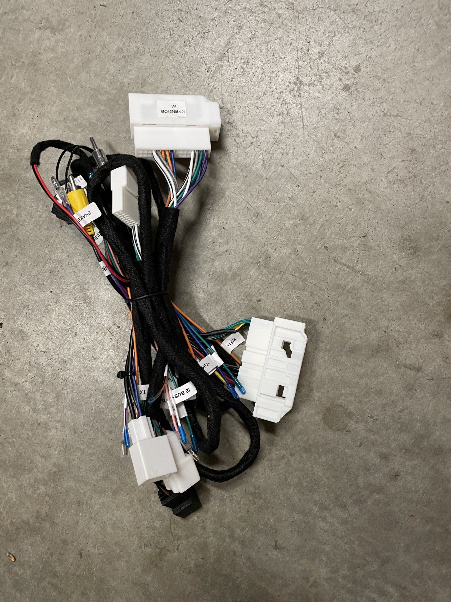

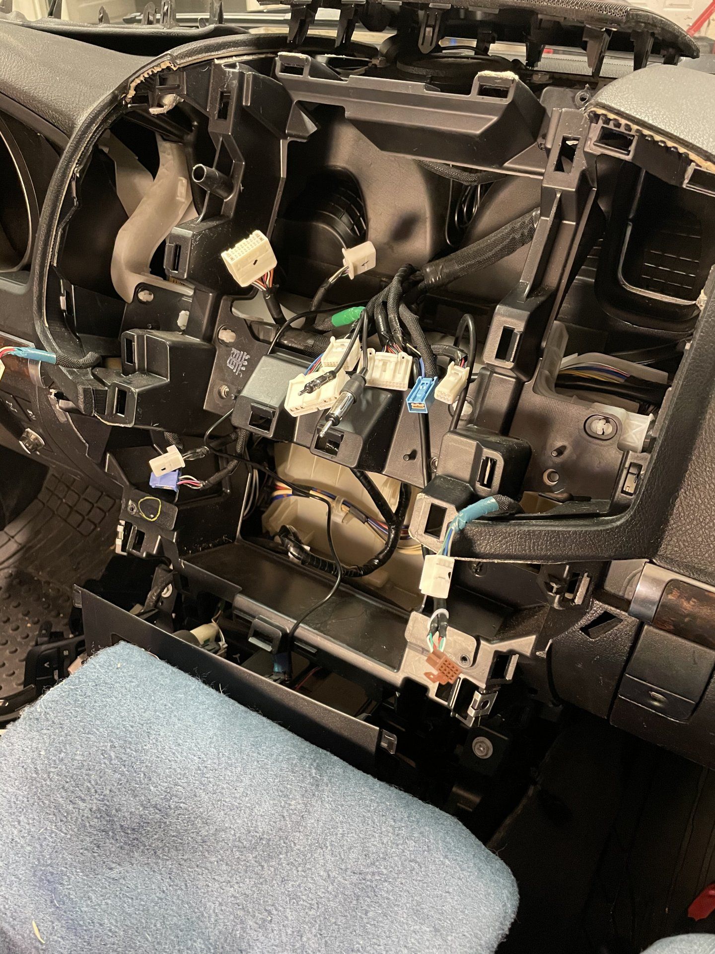

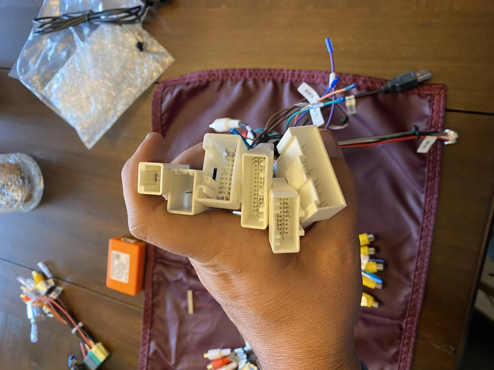

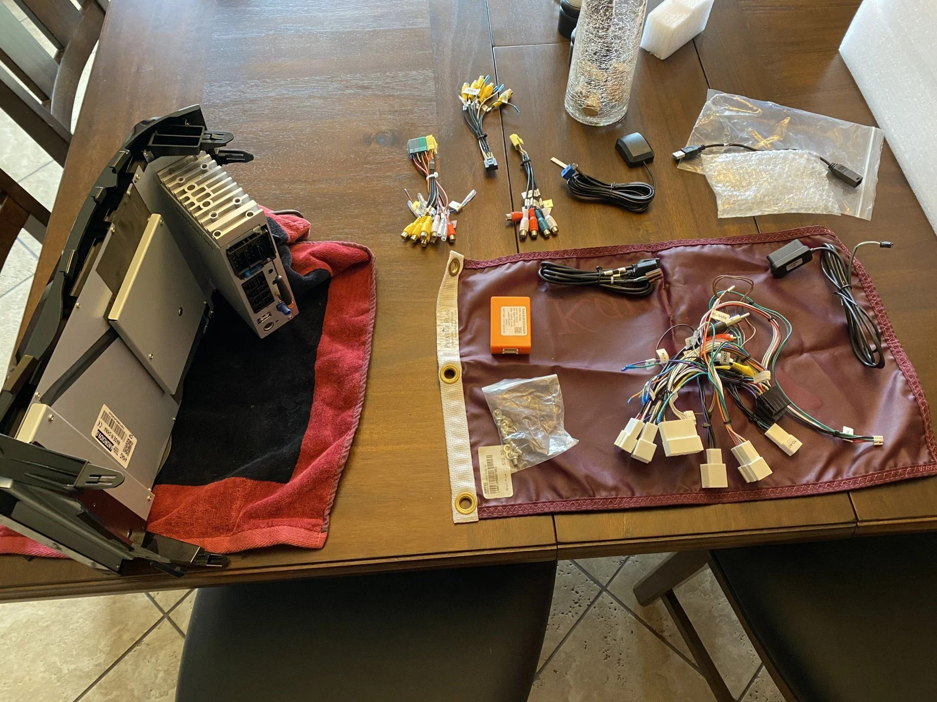

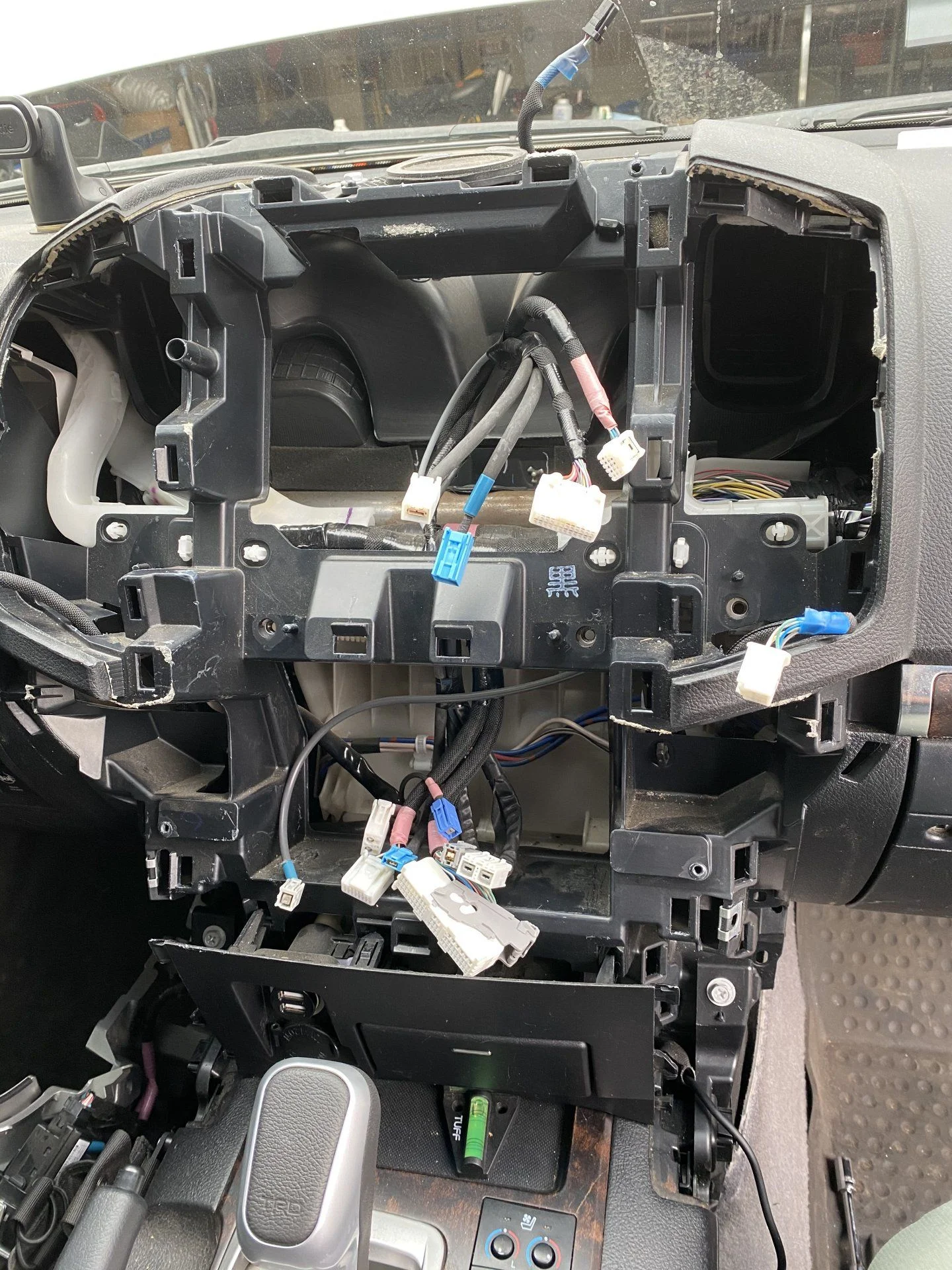

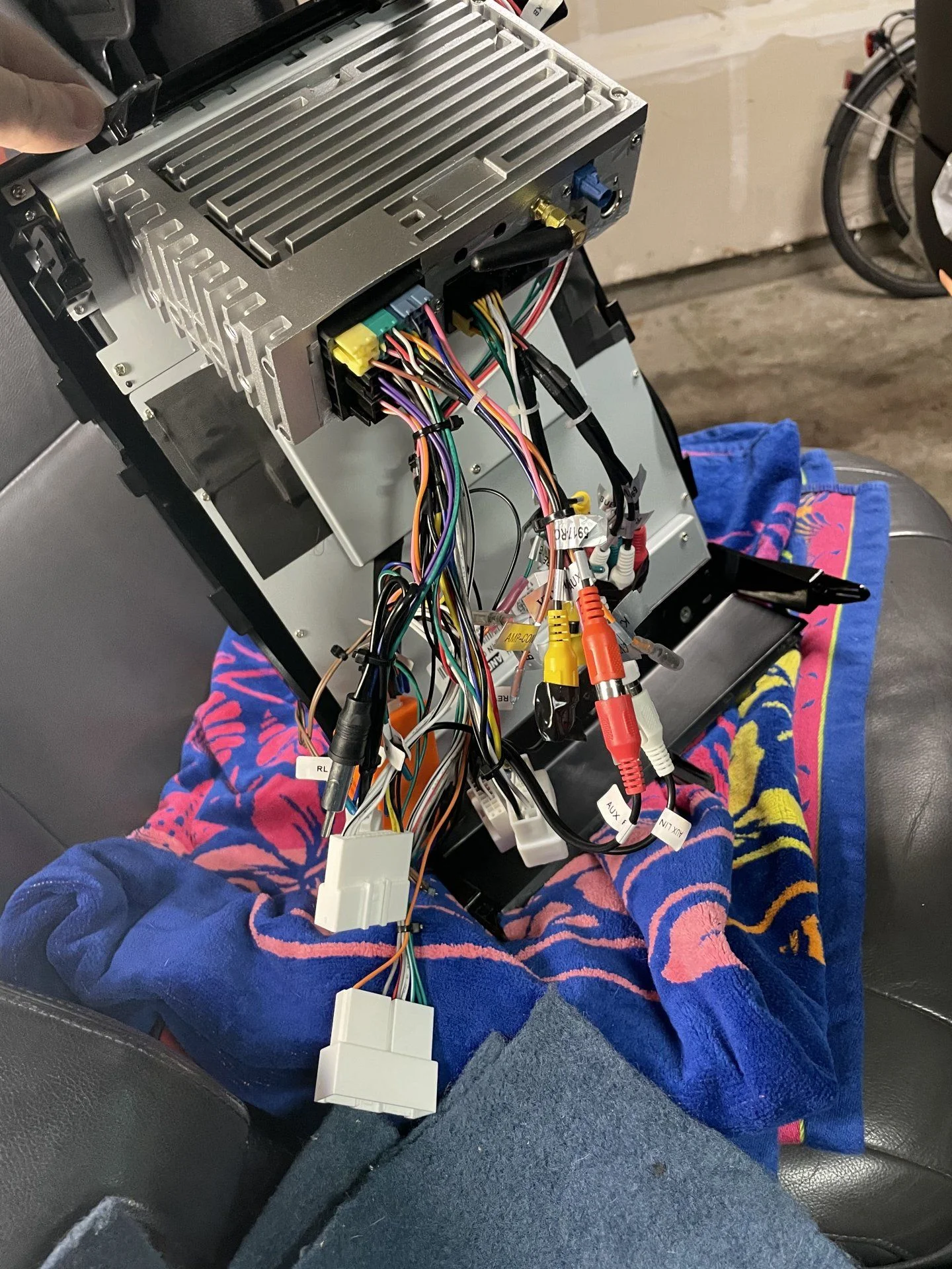

What year is yours? Did you happen to take any pictures or video of the wiring? Which factory components did you have to remove? I'm putting off installing mine until I can get some confidence that I actually know what is required. The lack of instructions and unclear wiring labels is a nightmare. Does any of this look familiar/unfamiliar?

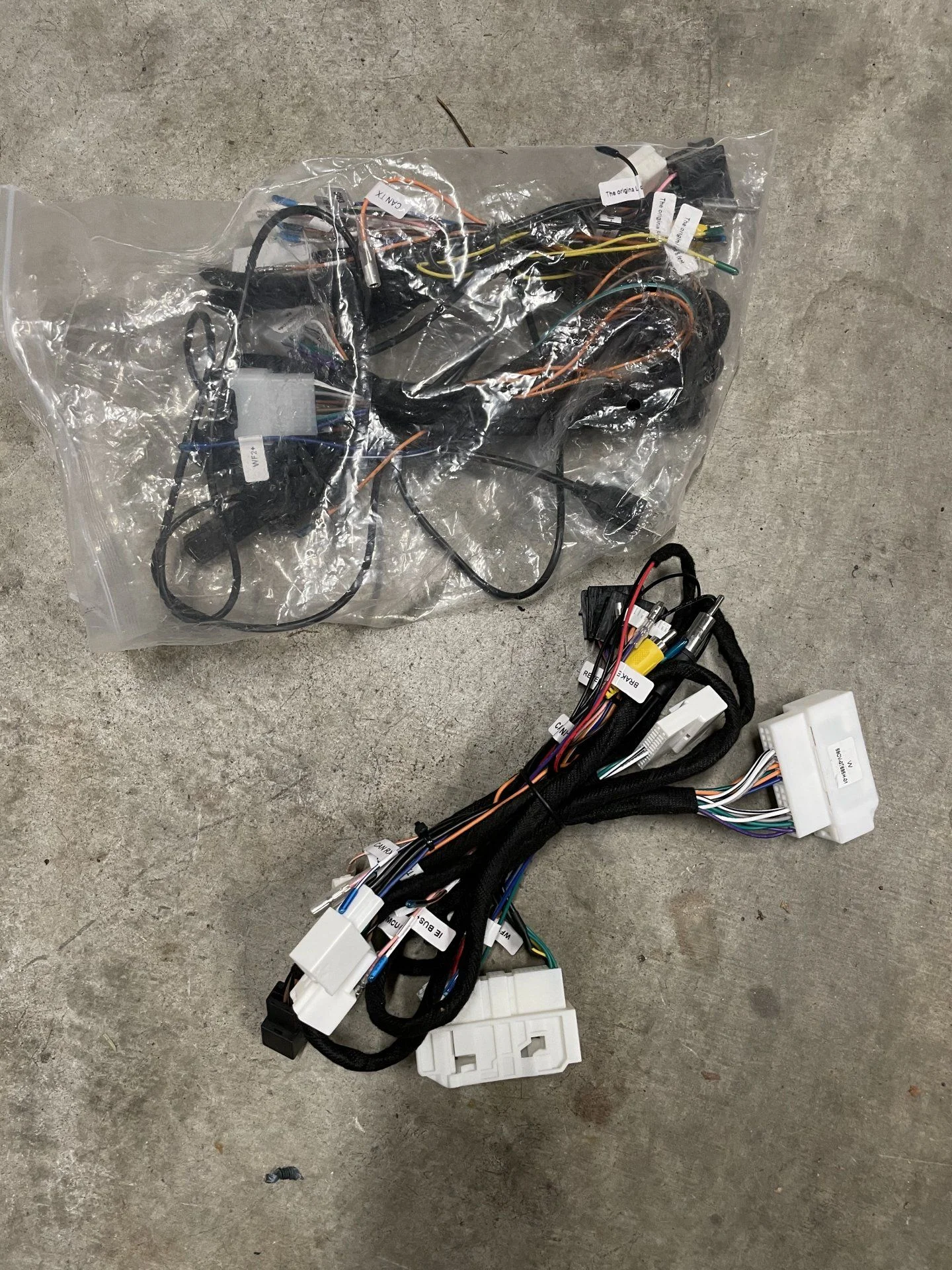

I have an 08 should be the same up to 13 then it changed slightly. Not all plugs from your oem or the new head unit will be used. You want the harness that fits more of your oem plugs than the others. I can take some pics of the leftover harnesses if it helps. I had to wire connect the reverse wire and the rca male female together from the new oem harness adapter to the HU harness. (Colors don’t match btw). Off of the can bus box (orange) there is also a small plug that connects to the bezel for seat belt and air bag status (I didn’t see it the first time). Also before plugging in the harness to the car side make sure the male side plug pins are not bent (sometimes they get crossed and it’s hard to troubleshoot.
It’s not nearly as bad as it looks, took me about an hour or so because I forgot to connect everything. Test it before for lock it back in the dash all the way. If you get stuck let me know worst case I’ll open mine up on video chat and compare wiring connections.
PS also to make it easy I put my gps antenna under the center speaker grill just above the radio
My wiring looks different.
Harness looks the same?
